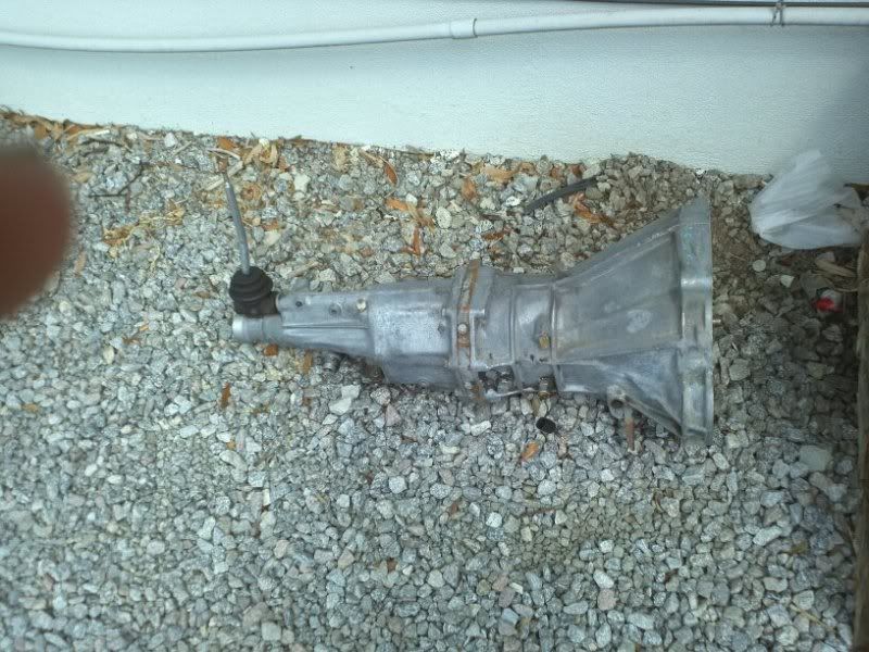

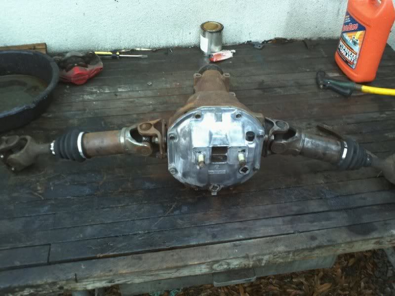

Guest skimattybee Posted June 22, 2011 Share Posted June 22, 2011 (edited) I recently pulled a r200 diff. from an 81' 280zx 2+2 to swap into my s30. i was told that that diff has the 3.90 gears. can anyone confirm this? i also pulled the 5 speed trans. any idea on the gearing for that as well? i did a pretty thorough search on the forums but no findings on the gearing of the diff. of a s130 2+2. any help is appriciated! Edited June 22, 2011 by skimattybee Quote Link to comment Share on other sites More sharing options...

NewZed Posted June 23, 2011 Share Posted June 23, 2011 The FSM will tell you what the stock setup was. In the PD section. If the differential is out you can turn the input shaft until the two drive axles make one revolution. Mark all three with white out or similar. As long as both outputs turn at the same rate, it's pretty accurate. The input shaft will either end up at 1/2, 3/4, or almost one full turn from where it started after one full turn of the drive axles, and 3 plus turns of the driveshaft. Quote Link to comment Share on other sites More sharing options...

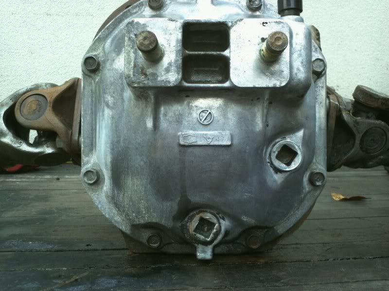

tec280zx Posted June 26, 2011 Share Posted June 26, 2011 You need to pull the diff cover to tell for sure. A number will be stamped on the ring gear. 39:11= 3.54 39:10= 3.90 37:10 =3.70 37:11 = 3.36 Quote Link to comment Share on other sites More sharing options...
