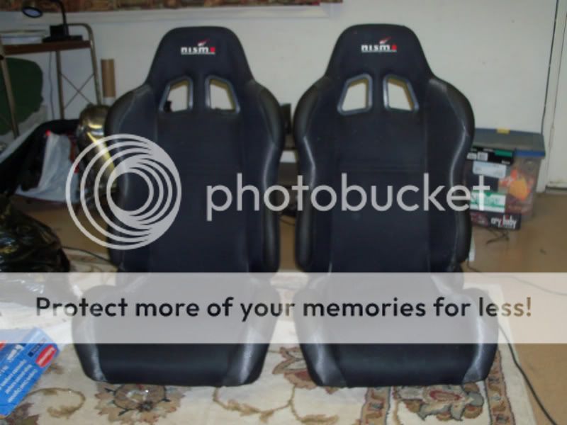

luseboy Posted December 11, 2011 Share Posted December 11, 2011 Got another little Christmas present for myself today! Looks like I need a new camera, they look better in person. I'm glad you ended up getting them! Should be sweet! How much did you end up talking the guy down to? Those should look really nice in your interior. Nice job haha! Quote Link to comment Share on other sites More sharing options...
h4nsm0l3m4n Posted December 12, 2011 Share Posted December 12, 2011 Got another little Christmas present for myself today! Looks like I need a new camera, they look better in person. Seats look great! Let us know how well they fit and how they affect seating position. I'm still trying to figure out what I'm going to do about my own seats and would really benefit from this. Quote Link to comment Share on other sites More sharing options...
Leon Posted December 12, 2011 Author Share Posted December 12, 2011 I'm glad you ended up getting them! Should be sweet! How much did you end up talking the guy down to? Those should look really nice in your interior. Nice job haha! Thanks! Ended up paying $280. Seats look great! Let us know how well they fit and how they affect seating position. I'm still trying to figure out what I'm going to do about my own seats and would really benefit from this. Thanks man! Supposedly, they bolt up to stock rails. I've yet to try, but I'll definitely give a report on how they fit compared to my stock seats. The thing is though, I'm not really sure on where these seats came from. The guy I got it from said that they are replica seats, possibly from "East Bear" but I really don't have an idea what they are yet. I'll be researching to see if I can find the seats' origin. Quote Link to comment Share on other sites More sharing options...
luseboy Posted December 15, 2011 Share Posted December 15, 2011 Thanks! Ended up paying $280. Woah, that's a good price! Weren't those the ones the guy was trying to get 500 for? Quote Link to comment Share on other sites More sharing options...
Leon Posted December 15, 2011 Author Share Posted December 15, 2011 Woah, that's a good price! Weren't those the ones the guy was trying to get 500 for? He was asking 400, so I think I got a decent deal. Maybe this weekend will give me some time to see whether they bolt to the stock rails and how they fit in the car. I've really been splurging on Z-stuff recently, and I'm feeling a bit financially irresponsible. There is a 4.375 R200 CLSD in my future! I made a promise to myself to not spend any more money on the Z until next year... Quote Link to comment Share on other sites More sharing options...
luseboy Posted December 18, 2011 Share Posted December 18, 2011 He was asking 400, so I think I got a decent deal. Maybe this weekend will give me some time to see whether they bolt to the stock rails and how they fit in the car. I've really been splurging on Z-stuff recently, and I'm feeling a bit financially irresponsible. There is a 4.375 R200 CLSD in my future! I made a promise to myself to not spend any more money on the Z until next year... ya that's not a bad deal at all. Cheaper than kragen seats, and probably much better. If you need any welding for rails or whatever, let me know! Haha I wish I could splurge on Z stuff. I've been saving up... for registration . I want an lsd... But I'm saving that for a future upgrade! it's almost next year... who's counting? haha Quote Link to comment Share on other sites More sharing options...
Leon Posted December 18, 2011 Author Share Posted December 18, 2011 ya that's not a bad deal at all. Cheaper than kragen seats, and probably much better. If you need any welding for rails or whatever, let me know! Haha I wish I could splurge on Z stuff. I've been saving up... for registration . I want an lsd... But I'm saving that for a future upgrade! it's almost next year... who's counting? haha Exactly! I was happy today to finally have some time to work on the Z. The stock brackets bolt on to the "Nismo" seats with minimal effort! All I had to do was remove the stock brackets (not as easy as it could be) and press out the seat-to-bracket bolts in my bench vice. Then, the stock brackets needed a new hole drilled in them to match the hole spacing on the new seats. Unfortunately, the seats do sit me a bit higher up than stock. I had to remove my roll-bar in order to fit comfortably. I do fit, but a helmet makes things very uncomfortable. I'll finish installing the seats and see if I like them. If not, then I can always switch back. I'll try to upload the pics tomorrow. Quote Link to comment Share on other sites More sharing options...
luseboy Posted December 19, 2011 Share Posted December 19, 2011 Exactly! I was happy today to finally have some time to work on the Z. The stock brackets bolt on to the "Nismo" seats with minimal effort! All I had to do was remove the stock brackets (not as easy as it could be) and press out the seat-to-bracket bolts in my bench vice. Then, the stock brackets needed a new hole drilled in them to match the hole spacing on the new seats. Unfortunately, the seats do sit me a bit higher up than stock. I had to remove my roll-bar in order to fit comfortably. I do fit, but a helmet makes things very uncomfortable. I'll finish installing the seats and see if I like them. If not, then I can always switch back. I'll try to upload the pics tomorrow. Sounds like you made it off easy with getting them installed. I keep reading of people having issues with their seats being too close to the steering wheel haha. Makes me glad to have the short arms. Looking forward to seeing how they look! Quote Link to comment Share on other sites More sharing options...

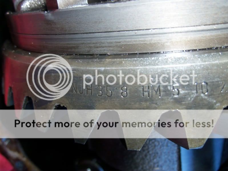

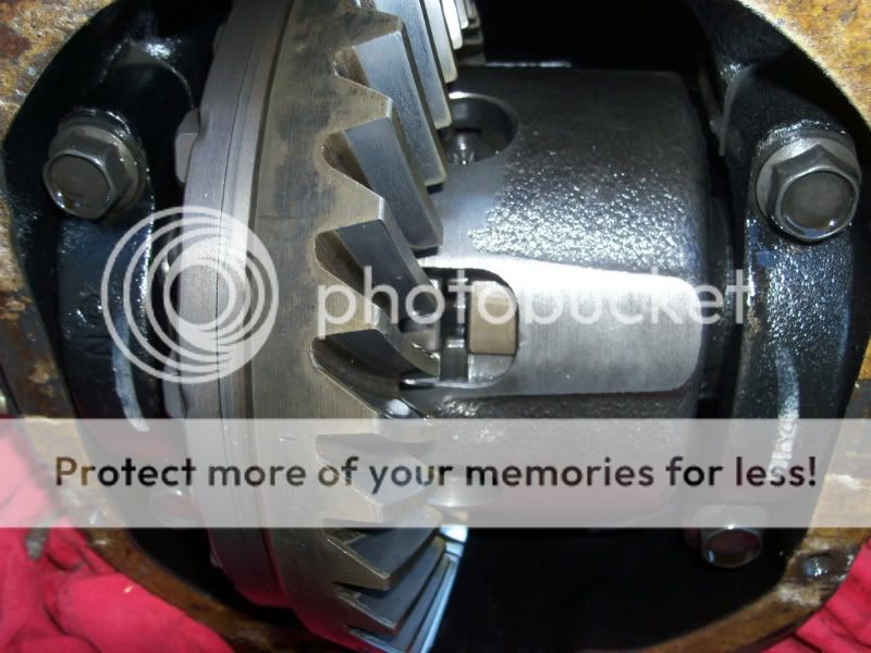

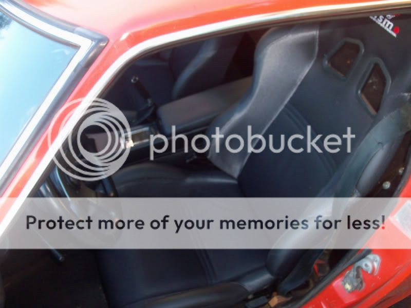

Leon Posted January 8, 2012 Author Share Posted January 8, 2012 (edited) I also finally got some time today to work on the Z! Played a little bit with a new-to-me differential: I don't speak Japanese, but was curious about these characters It's a 4.375 CLSD R200! So, my next big project is going to involve dropping the exhaust, tranny and diff in preparation for some changes. Before that, I want to go back to the dyno to see the changes made by the header/twice pipes. I'll be putting in a new intake/exhaust gasket, the Fidanza flywheel, stock Exedy clutch, late ZX 5-speed, and 4.375 diff. I'll be doing all of this at the same time, so the Z should feel quite different when I'm done! I finally got the seat install done today. The seats are very comfy, but I'm not sure how long I'll keep them since I do sit a bit higher. They sure look nice, but pictures will have to wait until tomorrow when there's better light. Edited January 8, 2012 by Leon Quote Link to comment Share on other sites More sharing options...

luseboy Posted January 8, 2012 Share Posted January 8, 2012 That anti football run looks fun! Maybe I'll go next year since I'll have the Z up and running for sure by then. Your new diff looks sweet! I'm sure the LSD will play nice haha. Pics of the seats installed!? Quote Link to comment Share on other sites More sharing options...
Dan_Austin Posted January 8, 2012 Share Posted January 8, 2012 My wife tells me the characters on the diff do not translate, so they are likely the name of a yard or dismantler in Japan. Glad the 5 speed is going to be put to good use. Quote Link to comment Share on other sites More sharing options...
Leon Posted January 8, 2012 Author Share Posted January 8, 2012 That anti football run looks fun! Maybe I'll go next year since I'll have the Z up and running for sure by then. Your new diff looks sweet! I'm sure the LSD will play nice haha. Pics of the seats installed!? Thanks for reminding me! On to the pics: I'll try to get some better quality pics... Quote Link to comment Share on other sites More sharing options...
Leon Posted January 8, 2012 Author Share Posted January 8, 2012 My wife tells me the characters on the diff do not translate, so they are likely the name of a yard or dismantler in Japan. Glad the 5 speed is going to be put to good use. Cool, thanks for checking that for me Dan! And your old 5-speed will definitely be put to good use! Quote Link to comment Share on other sites More sharing options...
luseboy Posted January 9, 2012 Share Posted January 9, 2012 Seats look great in there, much better than the stock ones! Haha I guess I'll be putting your old 5 speed to use, Leon... A chain of 5 speeds lol Quote Link to comment Share on other sites More sharing options...

GOTHALOSISM Posted January 9, 2012 Share Posted January 9, 2012 Unless I missed it, what did that rear end come out of and is it bolt in? Quote Link to comment Share on other sites More sharing options...
Leon Posted January 9, 2012 Author Share Posted January 9, 2012 Unless I missed it, what did that rear end come out of and is it bolt in? Good question. The LSD is from an R31 Skyline, it was imported by a prior owner (it might've been done by Dave at AZC). It is a longnose R200 and is therefore a bolt-in if your Z is already setup for the R200. I haven't yet checked if my driveshaft fits the pinion companion flange, but the flange can be swapped for the one in my 3.9 R200. Quote Link to comment Share on other sites More sharing options...
