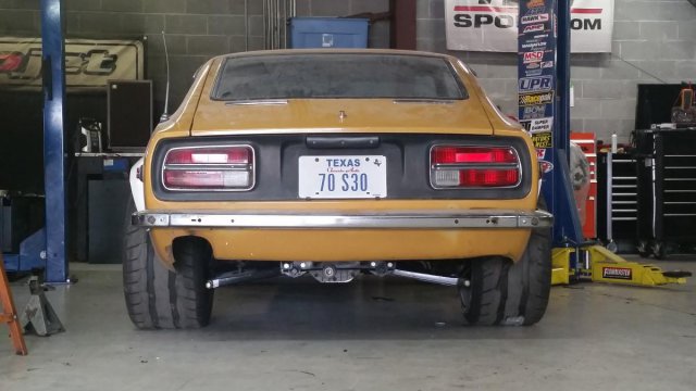

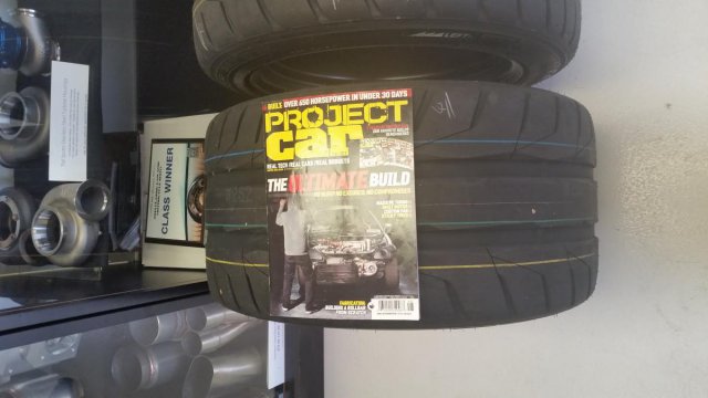

texis30O Posted September 28, 2014 Author Share Posted September 28, 2014 Because when you build a stupid high whp 240z. You want to keep it on the road....... Quote Link to comment Share on other sites More sharing options...
RebekahsZ Posted September 28, 2014 Share Posted September 28, 2014 Power steering? I just switched from drag racing front runners to my road race tires. Holy-moly! I gotta hit the gym! Quote Link to comment Share on other sites More sharing options...
texis30O Posted September 28, 2014 Author Share Posted September 28, 2014 I got to drive a imsa, g nosed ls3 swapped Z yesterday. ...... had some fun. The rear tires were 335 35 17.... I can't wait till mine is ready. It will be about 4 weeks. Which is good cause I still have my 911 in the garage and the wife will not give up her spot for the Z...... Quote Link to comment Share on other sites More sharing options...

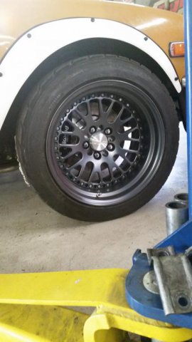

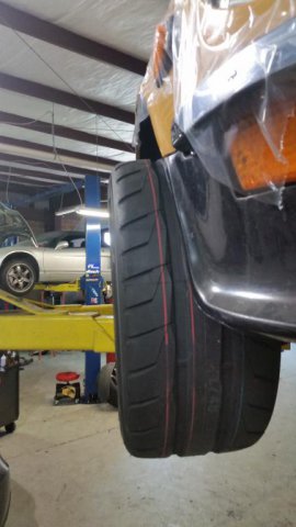

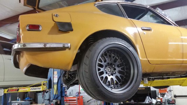

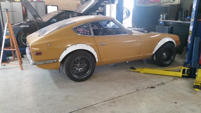

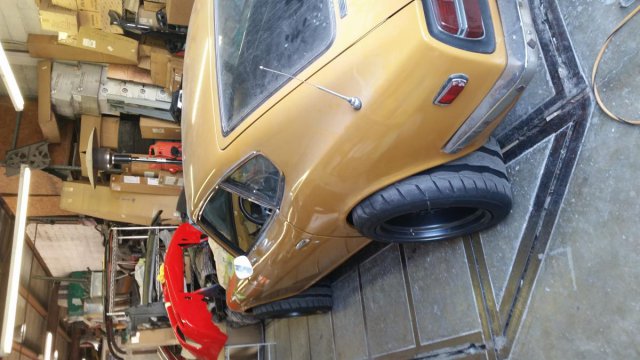

texis30O Posted October 7, 2014 Author Share Posted October 7, 2014 The car is heading to the body shop for them to cut and do the metal work necessary to clearance the wheels and tires..... The shop will work on my gauge set up in the mean time. Quote Link to comment Share on other sites More sharing options...

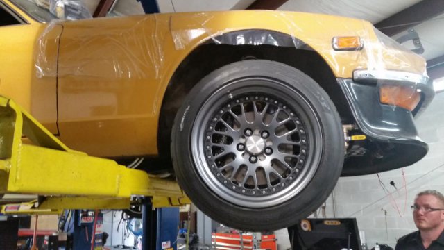

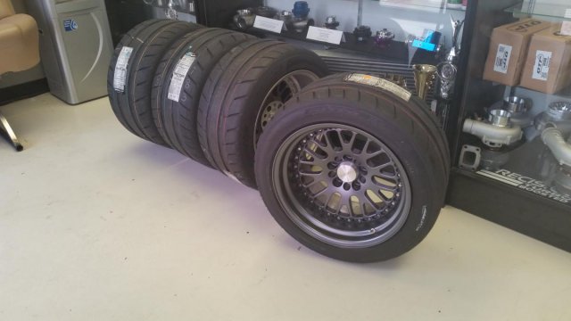

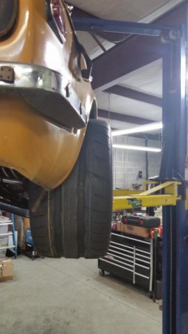

slowspeed Posted October 8, 2014 Share Posted October 8, 2014 Wow!!! Nice build. Ccw wheels like mean on the car. What's your back space on the front and rear? Quote Link to comment Share on other sites More sharing options...

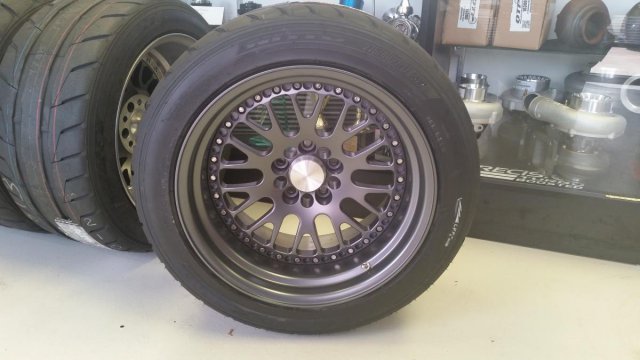

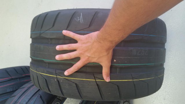

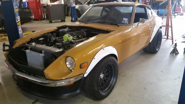

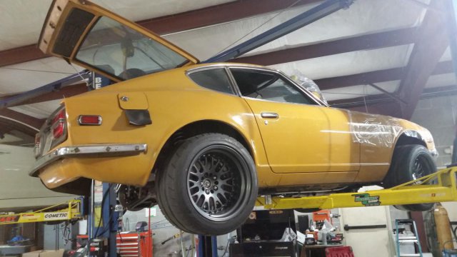

texis30O Posted October 8, 2014 Author Share Posted October 8, 2014 (edited) 5.5 in the front and back. 17x10 up front and 17x11.5 out back. 315/35/17 rear and 275/40/17 front. For now I am putting BAMF flares from jpn garage.... but I have some additional changes coming. First I want this thing on the road!!! When it comes back from the body shop it will get the roll cage........ It should be good for 9.5 in 1/4 mile........ Edited October 8, 2014 by texis30O Quote Link to comment Share on other sites More sharing options...

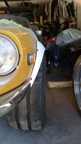

texis30O Posted October 11, 2014 Author Share Posted October 11, 2014 The car is at Richey Collison, coincidentally Alain's Z is there as well. 2 Datsuns in a sea of Corvettes. .... The ride height is set so the fender flares can be put on correctly. They are telling me that it will be about 3 weeks..... so my time line is getting pushed back..... when they do the front flares they will also have to clearance the air dam....I will plasti dip the car to see what color I end up spraying it in the end.. Quote Link to comment Share on other sites More sharing options...

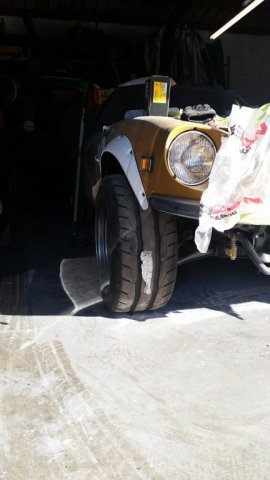

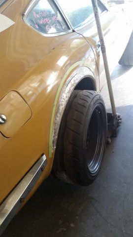

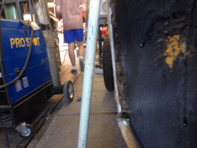

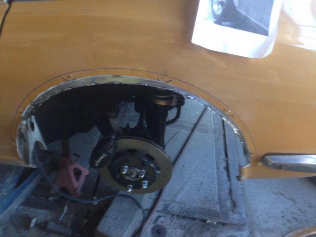

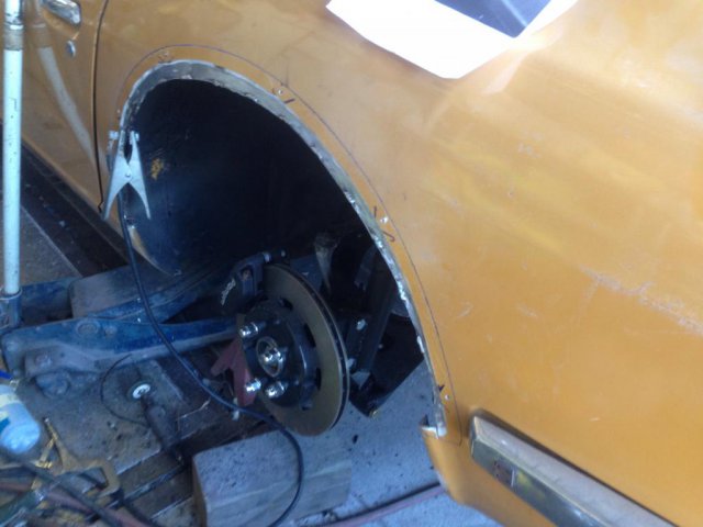

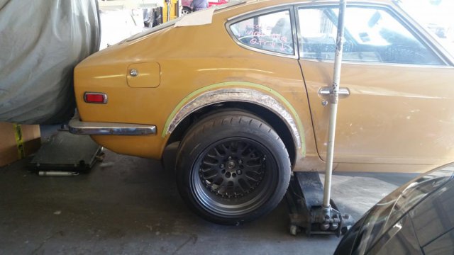

texis30O Posted November 3, 2014 Author Share Posted November 3, 2014 As no surprise I don't have the car back from the body shop yet. they seem to be under staffed currently and are "working me in" as best they can. A few pics...... the driver's side rear had some rust in the inner wheel tub so they did some patch work for me, as well as welded up everything. On to the other side. I am in New York working for the week so I won't be able to make surprise visits during the week..... as I like to show un announced.... I keep hoping and praying that I will have the car back before Thanksgiving, but with my luck it will be Christmas...... Quote Link to comment Share on other sites More sharing options...

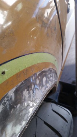

texis30O Posted November 10, 2014 Author Share Posted November 10, 2014 Went by the shop to check on my car. 1 flare left to install. Hopefully within the next 2 days it should be back at the shop for final assembly. Evidently the people that did the full repaint on the car, and the rust repair a the fender lips were bondo happy....... The previous owner has reassured me that the car was never in an accident. It spent 2 or 3 years in Chicago at the first part of its life and the salt on the roads is what took a tole on the car. He had it repainted back in the late 70s and they must have smeared all the bondo on the panel..... Quote Link to comment Share on other sites More sharing options...

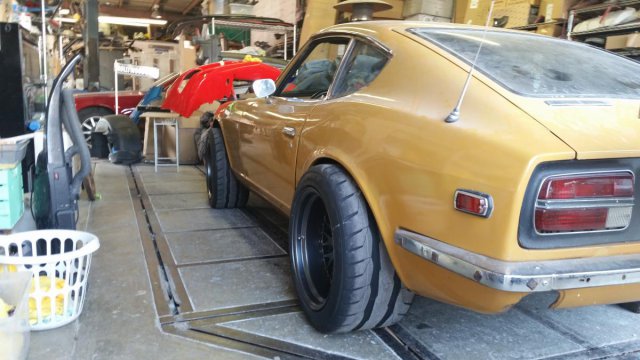

texis30O Posted November 18, 2014 Author Share Posted November 18, 2014 My car is now back at PowerFab for final assembly. Tick Tick.... now the waiting game.... I joke but I better have this thing back before my birthday (12-23)......... Hell I want it back in 3 weeks..... Quote Link to comment Share on other sites More sharing options...

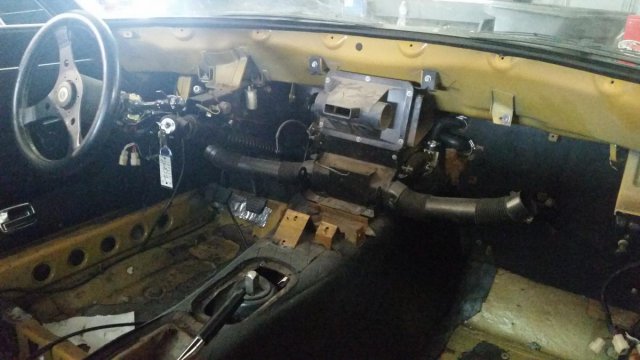

texis30O Posted November 20, 2014 Author Share Posted November 20, 2014 Because I like torturing myself on the progress of my car. Wiring harness has been measured out, discussed as well as a few other things. It is getting a cage, and gauges taken care of while there is some down time. I am also ordering some sound deadening, but it is not like it is really going to do much..... I guess it is just for my own piece of mind I guess. So here are the pics. Quote Link to comment Share on other sites More sharing options...
