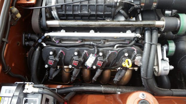

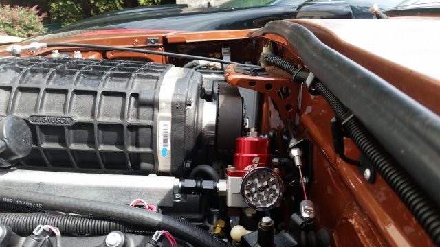

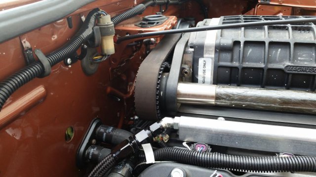

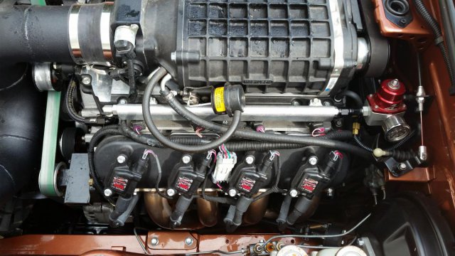

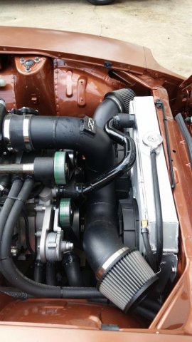

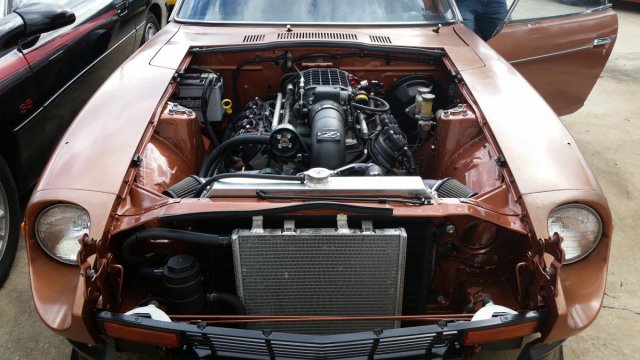

Just so happens that I got the pleasure of going to Hawk's 3rd Gen on a business trip to SC and NC this week.  I am headed home tomorrow.  I am still on hold due to CCW.  I do have all of my gauges in from Speed Hut and the shop is working to get them in while we wait.  They are working to get the rest of the motor together and start on the wiring while we wait on CCW....... So without delay  Here is Bruce's 280z.  His set up is so similar to mine it is sickening,..... My cam is a little more rowdy but all in all we pretty much have the same drivetrain......
He was a stand up guy to deal with on the purchase of my stuff and a good guy to hang with for a bit and talk shop.
