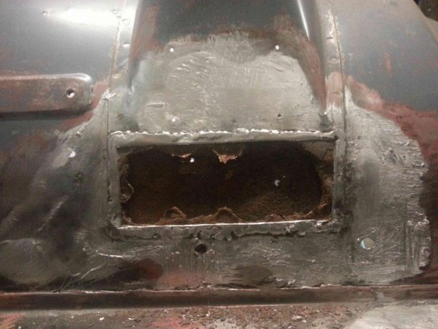

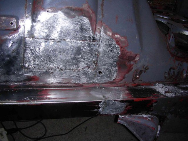

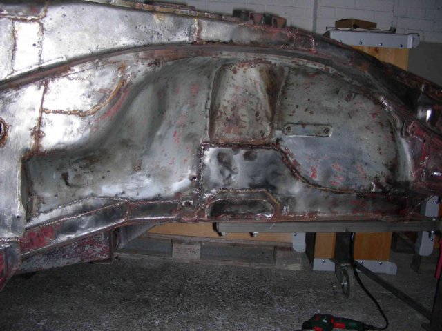

munters Posted September 1, 2012 Author Share Posted September 1, 2012 Startet with the underbody and there is a lot of Tectyl (3mm to 5mm.) Heating it up and scraping is a lot of work. The body shop did a really bad job 15 years ago before the body went to sleep till now. Many hidden rosty parts to be repaired again. (Grr paid 10'000 $ at that time for the body shop.) They did a good job at the back but a really bad one in the front. Like two people worked on it. There are up to 3 layers of metal. This time Im going to do it myself. To bad I tought I could go to the bare metal and bring it to the paint shop. So the whole mecanical part of the rebuild is a bit on hold. The list is huge there. roughly 8K$ of parts till now without the engine. I heard already a few times are you out of your mind? maybe I am. But this was my first car. I don't care it's like go back in time. Some people want young GF and I want my first car back Quote Link to comment Share on other sites More sharing options...
munters Posted November 12, 2012 Author Share Posted November 12, 2012 The whole project is still on hold because I cant find parts like the inner fender to do the repair as you can see. This work would never pass the government inspection. The crazy thing is I could find a rolling chassis, but the transport to europe is around 4500$. I'm still hoping to find basicly the whole front to exchange everything. Quote Link to comment Share on other sites More sharing options...

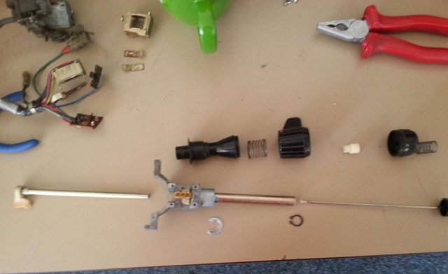

munters Posted August 22, 2013 Author Share Posted August 22, 2013 The Project is not dead and now even advancing. Finally I found a body shop 600 Miles away to redo the body. Delivered last week and should be back in a few month. In the meanwhile all the mechanical parts are powdercoated and reassembled. Steering overholed, all shafts redone, the suspension all done, big brake kit intalled. The things on the to do list is finally getting smaller. At the moment disassemble all the electric components like combi switch (nearly done), speedo, tach, clock and so on. The engine is on the way as well. After realizing the costs for a rebello is lower then stroking it myself with new parts and honing labor. I will have a Rebello in 6 to 8 weeks. Quote Link to comment Share on other sites More sharing options...
Pharaohabq Posted August 22, 2013 Share Posted August 22, 2013 Munters - Hey, Wow, is that metal welded over bad rusted metal? It's hard to tell from the picture. It doesn't look right in any case. I hope that your new body shop can handle it. There are a lot of places that can ship you new or used body panels for not too much. I'd imagine Rebello could also throw some in the box too when they ship you back your engine. It may be a lot cheaper to have rebello source an engine here, rather than shipping them yours. That way you'd also have yours as a "spare" and the rebello built engine as the primary. It should be much cheaper than shipping. Let us know what we can help you source. Tabco.com makes a lot of S30 body panels for instance. Quote Link to comment Share on other sites More sharing options...
munters Posted August 22, 2013 Author Share Posted August 22, 2013 Yup The metal was welded from both sides over the rust. The new Bodyshop is one of the few Z body specialist's in Europe (at least payable). The problem with the bodypannels is, I needed the front inner fenders (between the engine bay and wheel) and this is not easy to find and the Firewall. but this guy now knows what he is doing he has over 20z in his garage to rebuild the body. Cool guy. and he does cool work as well. At least what I could see. About the Rebello, Yes the shipping from here to the us would have been 1k$ per way whitch doesn't make sence so I just sent my tripples, cast exhaust manifold to port, distributor and the MSD. He sources the rest of the engine in the US. (nobody wants an L24 anyways, but all the L28). Good for me. Here a pic of the Light Combi Switch disassembled if someone wants to see how it looks in pcs. a bit blurry and before cleaning. Quote Link to comment Share on other sites More sharing options...
