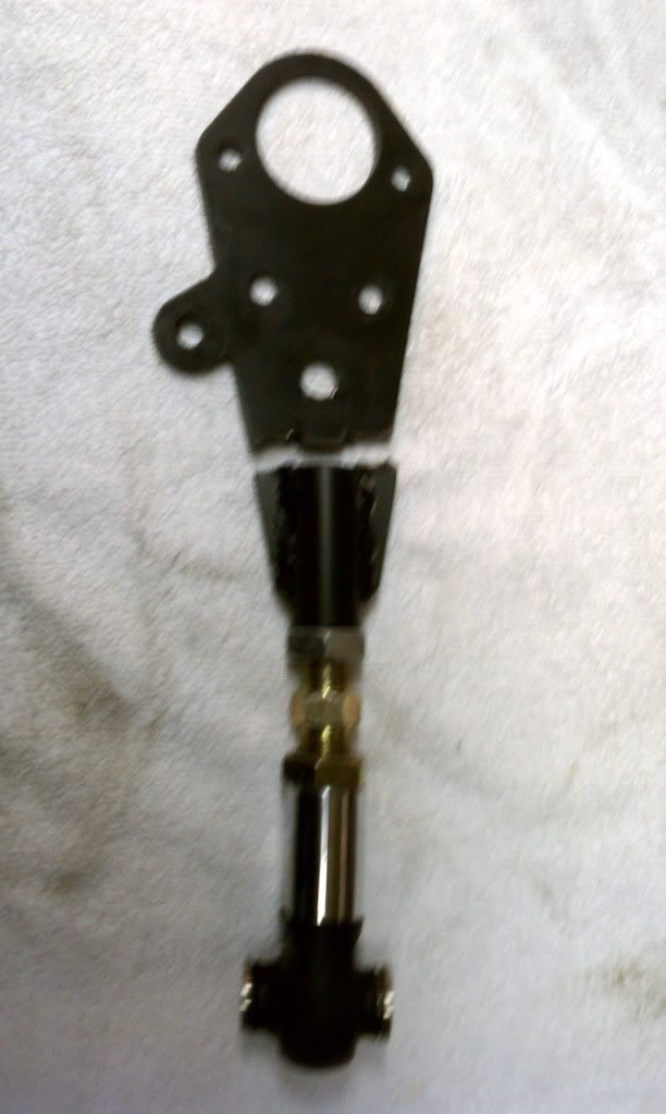

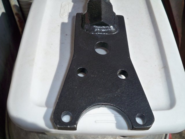

cygnusx1 Posted October 26, 2011 Share Posted October 26, 2011 (edited) Two vertical gussets in a "V" formation. The point of the V should lay on or past the midpoint of the tube section close to the LCA bushing end, and the legs of the "V" should radiate towards the inner bolt holes for the ball joint. They should be welded all the way along, and then the part should be stress relieved. Brittle metals have no place in this piece. This would leave room in between the "V" for the sway bar end link. This is just one way to do it. There are many. I wish I still had Solidworks here. Edited October 26, 2011 by cygnusx1 Quote Link to comment Share on other sites More sharing options...
EMWHYR0HEN Posted October 27, 2011 Share Posted October 27, 2011 What a terrible design on that arm that broke. Have you contacted them about it? Quote Link to comment Share on other sites More sharing options...

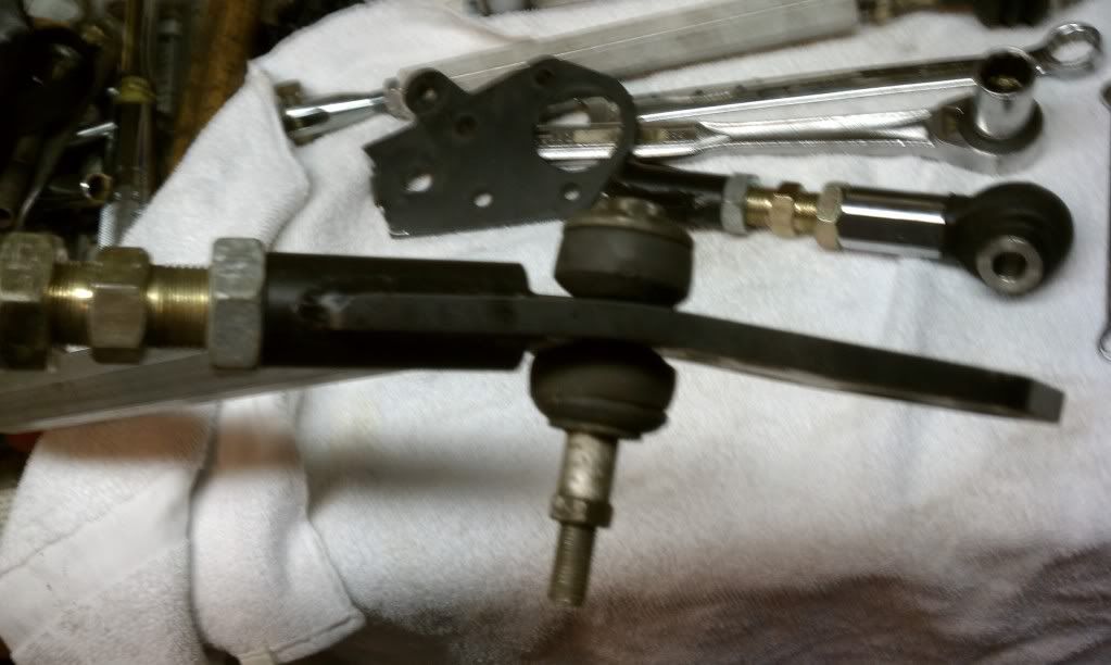

ComicArtist Posted October 28, 2011 Share Posted October 28, 2011 I personally wouldn't trust that LCA in the first place.... just the fact that the threaded rod is just welded to the side of the control arm is sketchy. Like everyone else is saying, it needs to be boxed in. Quote Link to comment Share on other sites More sharing options...
Owen C. Posted October 28, 2011 Share Posted October 28, 2011 How thick is the plate? Looks like rather than taking the time to engineer a proper design they just used a thick ass piece of hot rolled flat bar. Id think that 1/8" thick with a few strategically placed bends would not only be stronger but much lighter. Quote Link to comment Share on other sites More sharing options...

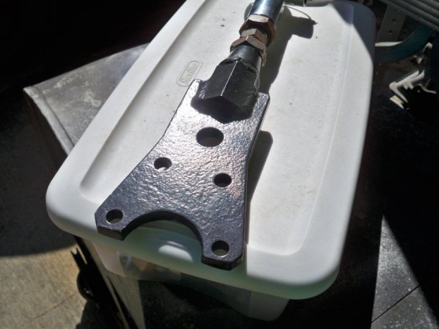

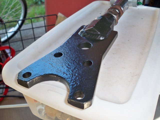

z-ya Posted October 29, 2011 Author Share Posted October 29, 2011 The guy to made these came by today and has decided to start from scratch and do a complete redesign. Here are some more pics: Quote Link to comment Share on other sites More sharing options...

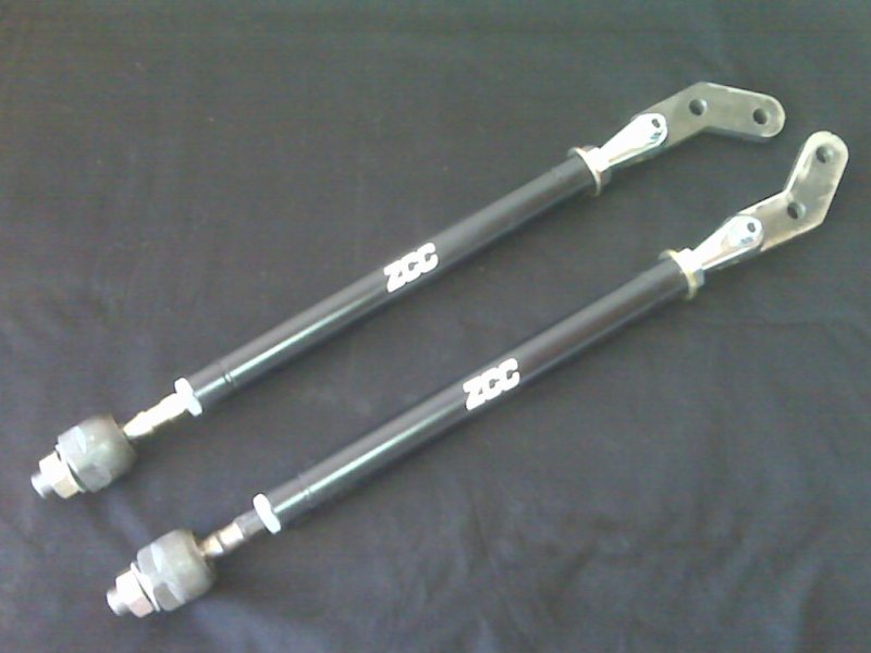

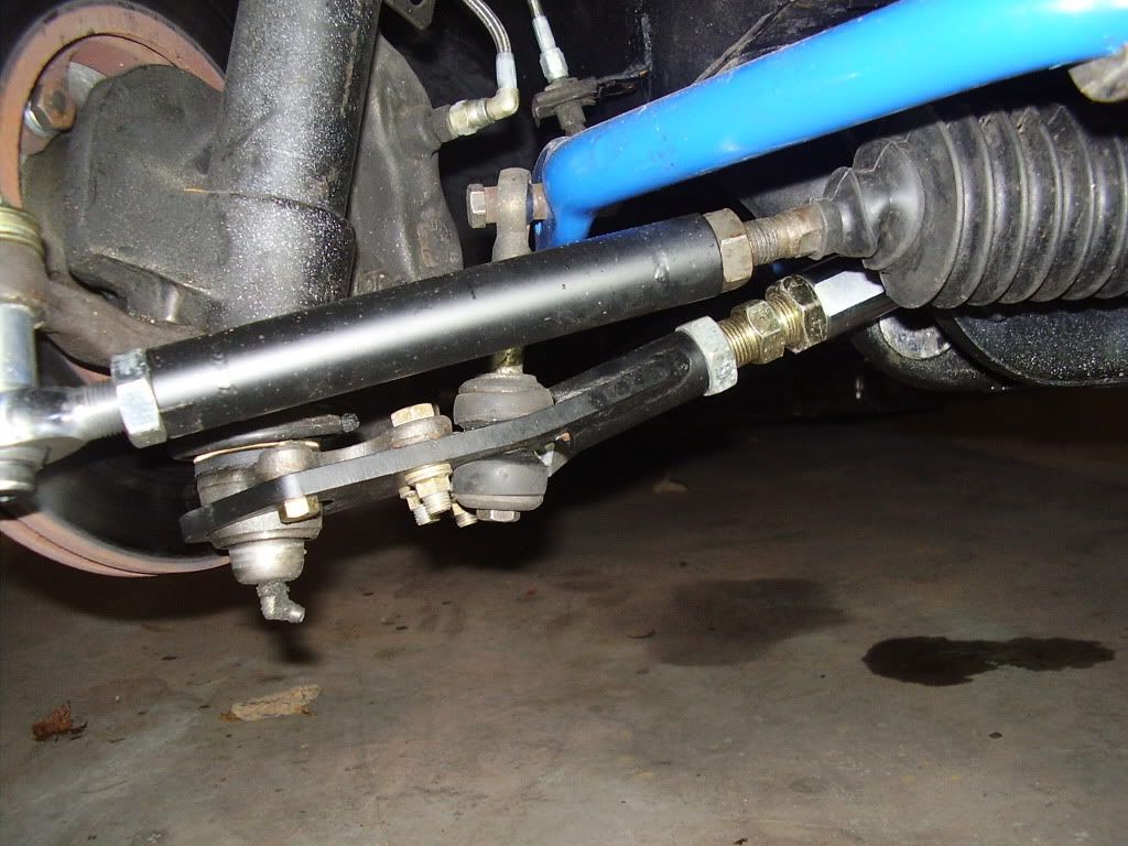

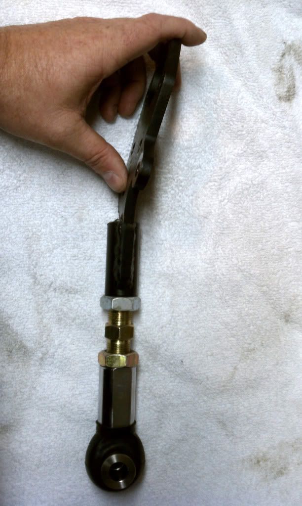

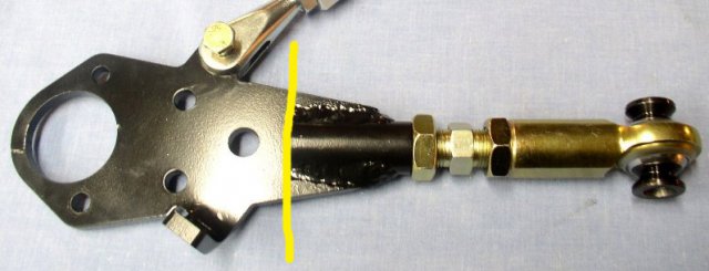

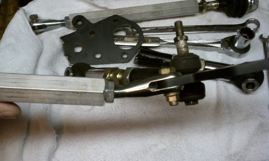

z-ya Posted October 30, 2011 Author Share Posted October 30, 2011 The ZCCJDM TC rods have two bolts connecting it to the control arm, but still rely on one bolt to tie the hockey stick to the rod: Same for Arizona Z: The TTT TC rods have the hockey stick welded to the rods: The only reason to use the hockey stick approach is so that the TC rod can be used with stock control arms. I don't think having one bolt holding it all together is a bad thing, as long as it can handle the load. The Arizona Z parts have been proven for years. The guy that made mine is going to increase the sized of the threaded Y bolt on the end of the TC rod to 5/8". He is also going to a bigger bolt that holds the TC rod to the control arm. He is also most likely going to change the design to one piece. Quote Link to comment Share on other sites More sharing options...
