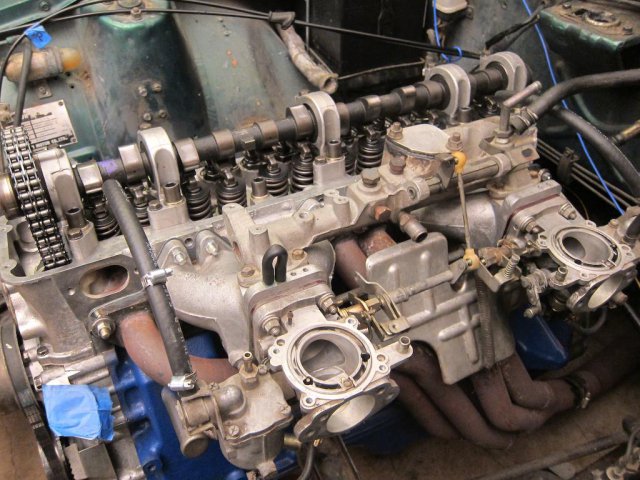

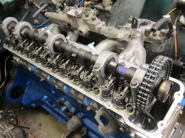

steve260z Posted October 19, 2012 Author Share Posted October 19, 2012 Well, after getting the motor in the car I noticed a problem. The machine shop overlooked a broken off stud used to attach the header/exhaust manifold. Crap...I attempted to remove the stud with extractors but no luck and certainly didn't want to screw it up even worse so out came the motor. Removed the head and took it in for repair. Lesson here: Don't assume the machine shop did it 100% correct. So, motor is back together and thought I'd post a picture of the correct cam timing. Notice the "dash" and the "v" are centered within each other and the motor is on TDC. (My scribe on the damper is slightly off but noted..) Quote Link to comment Share on other sites More sharing options...
