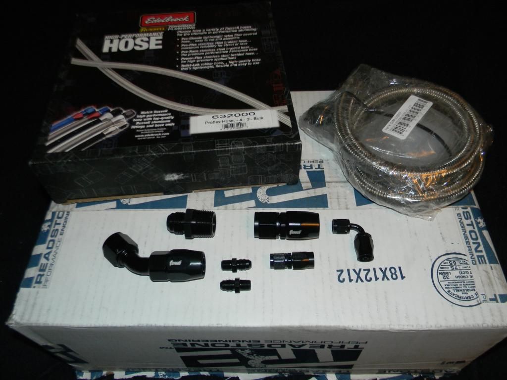

richracing Posted November 29, 2012 Author Share Posted November 29, 2012 Haha, that's awesome man, glad I could help. I got some more parts in the mail yesterday... Jegs dual pass Radiator Oil feed and return 3" downpipe stuff Quote Link to comment Share on other sites More sharing options...
