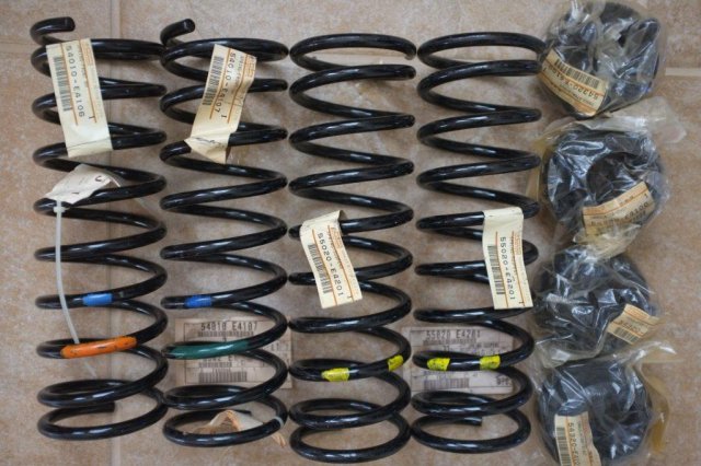

ironhelix Posted April 20, 2012 Author Share Posted April 20, 2012 (edited) Actually, the lowest point is about same with 5" of ground clearance. It does look worse in the photo. I planned to replace the Eibach springs with Euro Stage 1 springs that I've had for years, but they would have raised the car 1-1 1/2”, so that’s not going to happen. The springs are still sitting on a shelf. 🙂 Edited January 15, 2022 by ironhelix Facts Quote Link to comment Share on other sites More sharing options...
