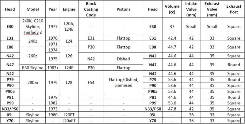

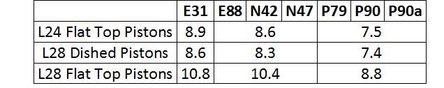

The main diferences betweet L28ET vs other L series, are, L28et head, oil pump, C/R (dished pistons and 53.6 cc chamber)
Besides the electronic fuel injection system, a little bigger injectors, fuel pump, opto distributor, Nissan ECCS!
