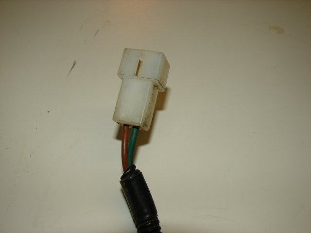

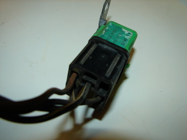

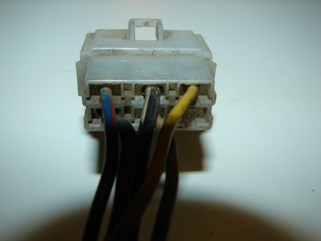

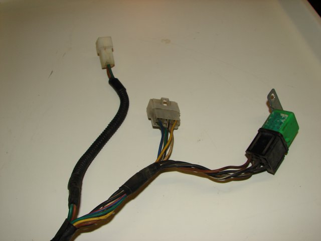

Hi Def Posted January 7, 2013 Author Share Posted January 7, 2013 So,I went outside and got the ZXT to start today. Hard as nails to start cold? Once running,everything was ok. Had to keep feathering the throttle to keep it runnin but other then that,all sounded well. Then I noticed that the Alt gauge was showing I had 14+ volts and the red light was starting to come on. Also seen the oil pressure was low. I shut it down and swapped out the Alternator for a known good one,and checked the oil. Oil was low due to the big oil cooler I have now. So no prob there. Topped that off. And proceed to start again and bam! Fuel pump is now NOT priming!? Ok,maybe I bumped something. Check all wiring and look around. Nope. All good. Try again. No pump? Wth? Ok,so I swapped the alt and now no priming. Screw it,turn the key and Wtf!? Now no spark? LOL Omg!!!!! This project is messing with me I swear!!!!! Now what coulda happened!? Did the other Alt have a short or something and shorted out my brand new HEI and fuel pump/relay? Last time I turned the key on,again after checking spark,all the dash lights were on!? Ok,disconnect and am now in the house mad. And to make it all worse,a dear friend of mine I found out,just had a stroke lastnight. I swear,bad luck,loves me. Sooooo,now where I begin to look and fix THIS prob. Quote Link to comment Share on other sites More sharing options...
Hi Def Posted January 7, 2013 Author Share Posted January 7, 2013 So,I went outside and got the ZXT to start today. Hard as nails to start cold? Once running,everything was ok. Had to keep feathering the throttle to keep it runnin but other then that,all sounded well. Then I noticed that the Alt gauge was showing I had 14+ volts and the red light was starting to come on. Also seen the oil pressure was low. I shut it down and swapped out the Alternator for a known good one,and checked the oil. Oil was low due to the big oil cooler I have now. So no prob there. Topped that off. And proceed to start again and bam! Fuel pump is now NOT priming!? Ok,maybe I bumped something. Check all wiring and look around. Nope. All good. Try again. No pump? Wth? Ok,so I swapped the alt and now no priming. Screw it,turn the key and Wtf!? Now no spark? LOL Omg!!!!! This project is messing with me I swear!!!!! Now what coulda happened!? Did the other Alt have a short or something and shorted out my brand new HEI and fuel pump/relay? Last time I turned the key on,again after checking spark,all the dash lights were on!? Ok,disconnect and am now in the house mad. And to make it all worse,a dear friend of mine I found out,just had a stroke lastnight. I swear,bad luck,loves me. Sooooo,now where I begin to look and to fix THIS prob? Quote Link to comment Share on other sites More sharing options...
