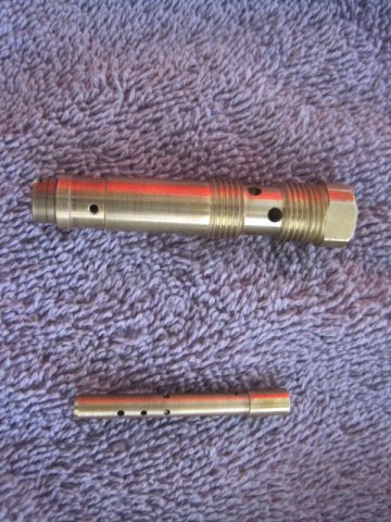

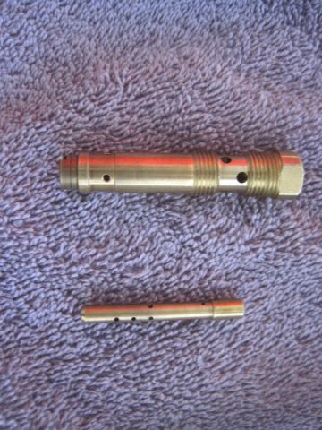

madkaw Posted October 21, 2013 Author Share Posted October 21, 2013 So I have verified that the emulsion tubes have a 8 stamped on them, but couldn't match that with anything in the catalog. The bleed pipes had a 'T' stamped on it, again, it matches nothing in the mikuni catalog. If I were to temporarily alter the emulsion tube/bleed pipe to start transition from the main sooner, how would or could I do that? Quote Link to comment Share on other sites More sharing options...
Leon Posted October 21, 2013 Share Posted October 21, 2013 First thing I'd do is check whether there are any air bleed holes above the fuel level. If so, plug them. Use a toothpick, Loctite, etc. Then, you may need to up-size some lower bleed holes to get more air in, which will help accelerate the fuel faster during tip-in conditions. I'd also try to contact Keith Franck, he knows a lot more than I do when it comes to this. I'm just relaying Keith's findings. Quote Link to comment Share on other sites More sharing options...
madkaw Posted October 21, 2013 Author Share Posted October 21, 2013 Holes in the E-tube or the bleed pipe? How would I go about contacting him? Or is that only through the Yahoo Group? The other interesting thing is that some mikuni's don't even use the bleed pipe. Quote Link to comment Share on other sites More sharing options...
Leon Posted October 21, 2013 Share Posted October 21, 2013 On 10/21/2013 at 5:47 PM, madkaw said: Holes in the E-tube or the bleed pipe? How would I go about contacting him? Or is that only through the Yahoo Group? The other interesting thing is that some mikuni's don't even use the bleed pipe. I'm not very familiar with Mikunis but Keith has modeled them up. You can contact him through the group. Quote Link to comment Share on other sites More sharing options...
Leon Posted October 21, 2013 Share Posted October 21, 2013 On 10/21/2013 at 5:47 PM, madkaw said: Holes in the E-tube or the bleed pipe? How would I go about contacting him? Or is that only through the Yahoo Group? The other interesting thing is that some mikuni's don't even use the bleed pipe. Steve, tried to PM you but it said you can't accept any new messages. Send me a PM with your email or phone #. Quote Link to comment Share on other sites More sharing options...
