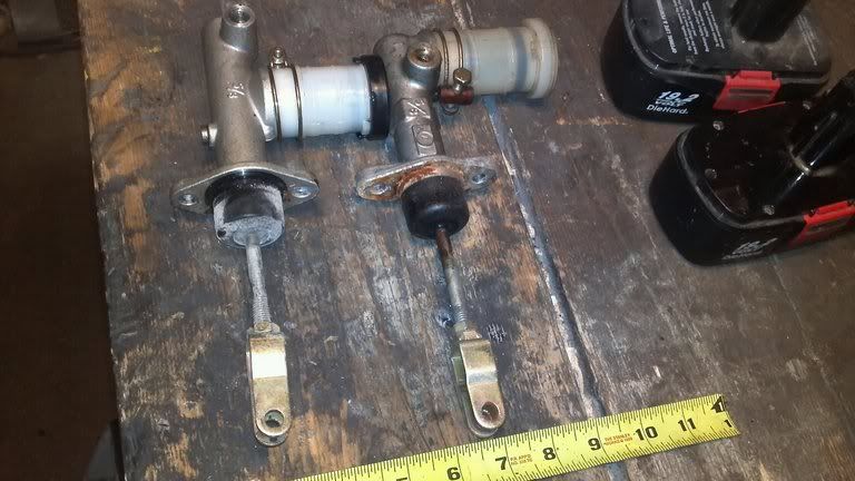

The problem I found with them was that the pedal linkage (the push rod) was about 1/4'' shorter on the aftermarket cylinders and did not have the length required to fully engage the slave cylinder.
if you have the stock cylinder and an aftermarket one handy just put them next to each other on a bench, you may be surprised with the difference. This was the case for me.

Edit: happened to find a picture of my two different masters, its rough but if you look closely since the mounting points are lined up, notice the rod length difference. (both adjustments are maxed out for length)
This MAY not be the case for you, but I figured I would throw this out there.
