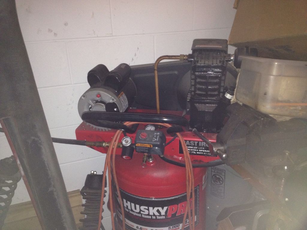

JSM Posted June 2, 2012 Author Share Posted June 2, 2012 (edited) This is my compressor. It will run up to 135 PSI. From a CFM rating where is the bottle neck at in compressors? I'm assuming it is the regulator? So best bang for the buck is simply get a shorter 1/2" hose direct to the gun correct? One thing that confussed me was IR told me to run a shorter hose with a weak compressor? Edited June 2, 2012 by JSM Quote Link to comment Share on other sites More sharing options...
kiwi303 Posted June 2, 2012 Share Posted June 2, 2012 Shorter hose does the same as a shorter muffler. Less loss due to Boyles Law... And no, the law has nothing to do with a dumpy british housewife... Quote Link to comment Share on other sites More sharing options...
Tony D Posted June 3, 2012 Share Posted June 3, 2012 Biggest bottleneck is line size, and reserve capacity (tank size)... Most of this is due to not using a regulator. Using air at full tank pressure sucks it down quickly. Regulating, if done, usually is through a dinky regulator totally inappropriate for something with usage requirements of a 1/2" Impact. As stated, the shorter the hose, the lower the losses. But it doesn't make sense to run a 3/8" hose from receiver to receiver and a 1/2" hose from point of use receiver to tool. You will quickly suck down the point of use tank, and then have a restriction in the transfer hose. I have an 80 gallon tank, hooked by a 1" line to a larger (300 gallon) tank simultaneously branched at a water trap to a 3/4" copper distribution system. All tanks, copper, and stainless lines operate at 125psi, the air is regulated at Point of Use. If I did it over, I wouldn't link distribution concurrently with the tank. It would go from Small Receiver to large receiver, then regulate to 100 psi for distribution with a LARGE regulator, and to tool use (35, 45, 75, 90) at Point of Use. The lower you run your air distribution network, the less you loose from leaks. It's easy to seal tanks. I routinely pump up and then shut ball valves to the large tank to keep it full virtually forever. Many people mistake the need for a 'larger' compressor because they don't have a big enough tank. There is a rule that says the bigger the tank you have, the smaller compressor you will need. You have to look at what your AVERAGE and not IMPULSE use is when sizing the compressor. You size the COMPRESSOR on AVERAGE USE. You size the TANK to the IMPULSE USE. The substitute for tank size is storing it at higher pressures (think scuba tank and what size an 80CF'er is!) For instance, in a can plant, they may have an 800HP compressor for each line and a 3400 gallon tank. In reality, when you look at the load cycling you can see it's the inrush that draws down their dinky tank when they start a line. If you put in a 10,000 gallon tank, suddenly a 600HP compressor works JUST FINE with no variations in line pressure. Now you can turn the storage pressure down from 125 to 90 psi because you no longer have a 15psi+ swing in pressure. More like 3-5psi during impulse loading. The result? The 800 HP compressor ran at 80 Amps of 4160, the 600 at 60 amps. Turning down the pressure from 125 to 90 against an 85 psi 'drop dead' requirement saved another 10 amps... well that's 30 amps at $3,450 per amp, per month.... Suddenly the cost of that new $125,000 compressor doesn't seem so bad when you pay for it in a couple of months, and after that it's all profit baby! And that, is how I pay for my bills! Quote Link to comment Share on other sites More sharing options...
