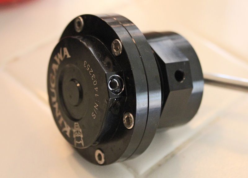

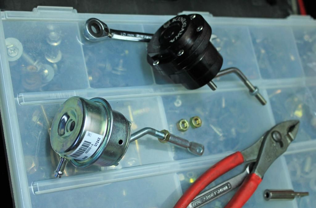

~KnuckleDuster~ Posted June 22, 2014 Author Share Posted June 22, 2014 /\ Thanks! I've been spending my time tuning the Z. I've had to lean it out quite a bit via the AFM wheel. It's running good now, I can actually go WOT and not get attacked by backfire and bog. I can really feel the full power of this RB turbo now and I must say it's really nice. On the negative side of my AFM tuning the car has developed a cold start issue. It refuses to start cold. I'm attributing this to my lack of cold start injector, AAR, and so forth. My solution to this has been to unplug my CHTS during warm up. The car starts right up and once it reaches operating temp I plug it back in and all is well. If this is how it's going to be I'll have to put the CHTS on a toggle switch and it will just be part of the pre-flight check list. In my rush to buy the final pieces during the turbo swap I bought a Kinugawa wastegate actuator. I had under 50 miles put on the set-up and the Z developed a vac leak. I found it was coming from the vac port on the actuator. The vac port is simply screwed in and had come loose. I re-tightened it and it came loose again. Attempted to tighten it a third time and add loctite and the thing snapped right off. Moral of the story don't compromise and buy some cheap China made crap! I finally got around to re-threading my shift knob lever and put my Burl wood shift knob on. Quote Link to comment Share on other sites More sharing options...

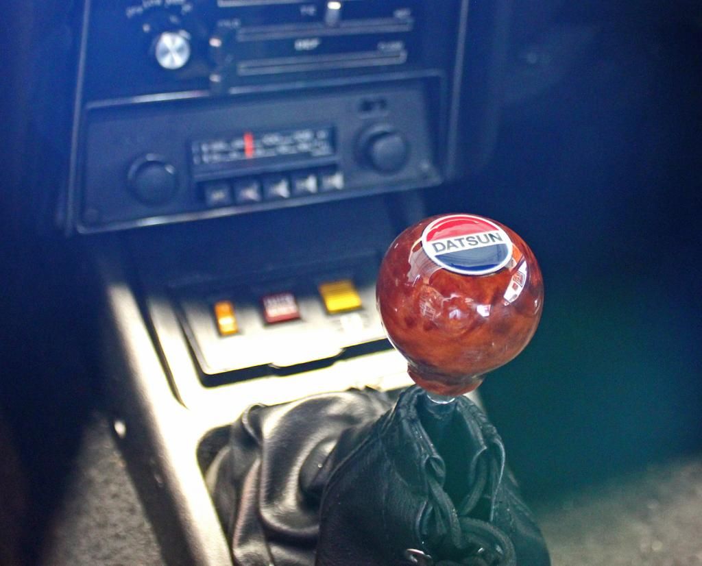

Cbb Posted June 24, 2014 Share Posted June 24, 2014 I love the shift knob! It's wicked Shiny. I would love to restore mine, but the weathered look gives it a bit of "character" haha. Like the rest of my car . Love how your Z is turning out! Quote Link to comment Share on other sites More sharing options...

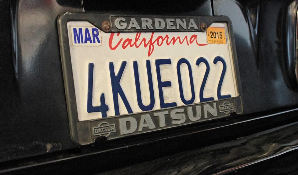

~KnuckleDuster~ Posted June 25, 2014 Author Share Posted June 25, 2014 (edited) There's nothing wrong with having a little character! I embrace it hehe. I found this vintage license plate frame from Gardena CA, Datsun. Best part is, it's black and it gives a nice original feel. Edited June 25, 2014 by ~KnuckleDuster~ Quote Link to comment Share on other sites More sharing options...

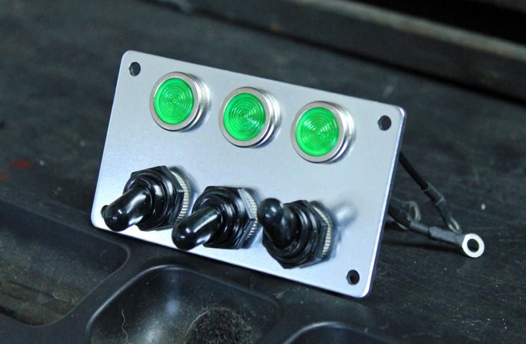

~KnuckleDuster~ Posted June 28, 2014 Author Share Posted June 28, 2014 I got a switch panel in from Peak Racing Equipment. Thinking about mounting it in the glove box to keep it hidden but reaching over there might get annoying, we'll see. Quote Link to comment Share on other sites More sharing options...
~KnuckleDuster~ Posted July 4, 2014 Author Share Posted July 4, 2014 (edited) Got the new wastegate actuator, Garrett "Special" 7psi. The rod arm ended up being to short so I had to buy a rod arm extension which in turn made it too long. Had to cut down a portion of the extension to get it just right. Cars back to running normal now, bov louder than ever. Edited November 23, 2014 by ~KnuckleDuster~ Quote Link to comment Share on other sites More sharing options...
