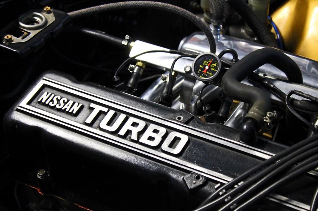

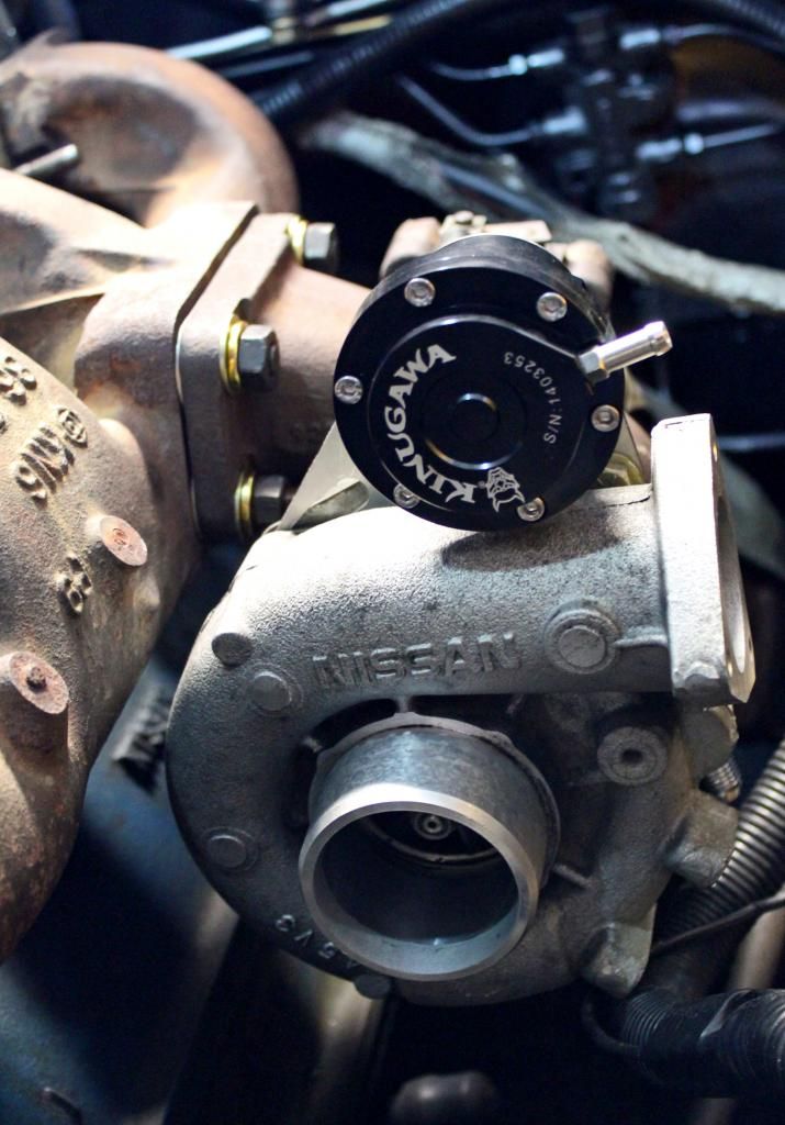

~KnuckleDuster~ Posted May 7, 2014 Author Share Posted May 7, 2014 Got the old girl running this past weekend. A list of some things I did in the past few months were: - fix exhaust leak - fix oil pan leak / install new oil pan - fix turbo oil drain leak - replace turbo, install new wastegate & water lines - replace intake manifold - replace upper and lower thermostat housings / install new thermostat - replace intake pipe - utilize pcv valve and crank case ventilation - replace fuel rail Here's a teaser shot for now. Need to get everything cleaned up and tucked where I want first. Quote Link to comment Share on other sites More sharing options...
~KnuckleDuster~ Posted May 8, 2014 Author Share Posted May 8, 2014 (edited) After relocating some grounds I was able to give the car a full test run today. As expected the turbo does spool faster and power feels much better but it's running rich and during high boost / full throttle it's backfiring and holding back the real power this turbo will push out. The previous set up ran rich as well, any suggestions / opinions on this matter would be much appreciated. On a side note, when I get back from a drive and put the car back in the garage I don't notice the immense heat coming from the engine bay. Normally the whole garage would be hot and you could really feel the engine warmth when near it. Now it's very noticeable how much cooler it is. I would go out on a limb and say 40% cooler, don't quote me on that. The non water cooled stock turbo must really generate some heat! Edited May 8, 2014 by ~KnuckleDuster~ Quote Link to comment Share on other sites More sharing options...

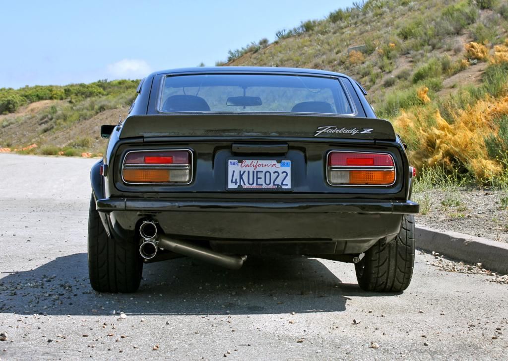

~KnuckleDuster~ Posted May 10, 2014 Author Share Posted May 10, 2014 (edited) Got the new exhaust set up installed today. Looks classic but beefy. No more boy racer fart can. It sounds amazing too. Much deeper and throaty than with the HKS. Edited May 11, 2014 by ~KnuckleDuster~ Quote Link to comment Share on other sites More sharing options...

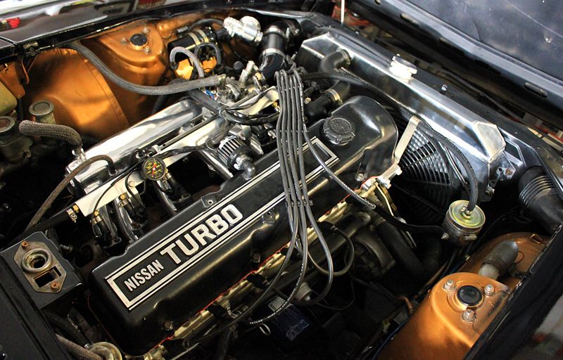

~KnuckleDuster~ Posted May 18, 2014 Author Share Posted May 18, 2014 (edited) Alright here's a decent picture of the engine bay. Still have a lot of cleaning up to do but she's getting there! Edited May 18, 2014 by ~KnuckleDuster~ Quote Link to comment Share on other sites More sharing options...
dirtbiker194 Posted May 19, 2014 Share Posted May 19, 2014 Engine bay is looking great and nice exhaust clip. It looks like you may have the exact same radiator that I just purchased. Quote Link to comment Share on other sites More sharing options...
~KnuckleDuster~ Posted May 19, 2014 Author Share Posted May 19, 2014 Thanks. Now I can begin to shift my focus to other areas like the brakes which are in need of attention. Some sway bars and re-installation of the air splitter may be in the near future as well. Quote Link to comment Share on other sites More sharing options...

AdreView Posted May 27, 2014 Share Posted May 27, 2014 Just read through the entire thread, excellent work restoring/updating all that is on this 240. The exhaust design was a great idea, love the vertical dual tips. Quote Link to comment Share on other sites More sharing options...
