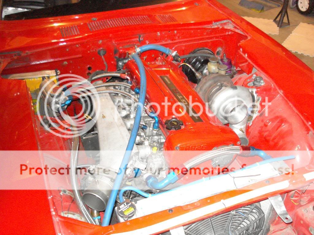

Coolwhip Posted August 22, 2012 Share Posted August 22, 2012 (edited) We've had customers complain about many of the manifolds on the market for the RB's not being able to fit the S30 chassis due to the vastly different engine bay real estate... Here is the turbo placement we went with when designing one for a customer of ours (pictured is our S30 jig car): The placement is very different then our other manifolds and can only expect the other manifolds made for the skyline and 240sx run into the same issues. However, the smaller turbo setups (usually found on the RB20's) fit on the straight forward manifolds and minimal clearance, but works. Pictured is a Precision Billet 6766. Hope you find success with your setup. Can't really speak for the issues you ran into but I've seen similar issues with all kind of setups come into the shop. Edited August 22, 2012 by Coolwhip Quote Link to comment Share on other sites More sharing options...

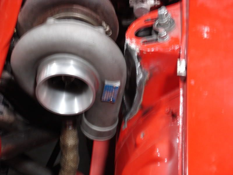

stony Posted October 20, 2012 Share Posted October 20, 2012 (edited) I had to notch my strut tower to fit the T-88 with the gready manifold. Edited October 20, 2012 by stony Quote Link to comment Share on other sites More sharing options...
rayaapp2 Posted October 20, 2012 Author Share Posted October 20, 2012 Oh that looks like fun... I have a GT35 knockoff and a GT30R to choose from at the moment. My compressor housing looks to be in about the same spot. I may have to employ some spacers on the engine mounts to un-tilt it a little. Ive already massaged the passenger side inner fender well for the intercooler piping and TB. Whats a little more. Quote Link to comment Share on other sites More sharing options...
