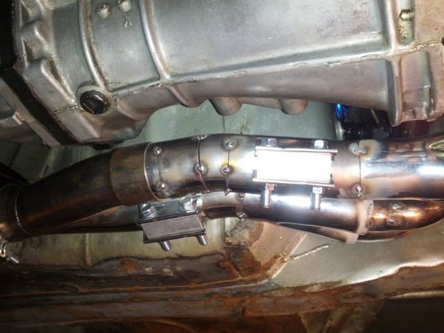

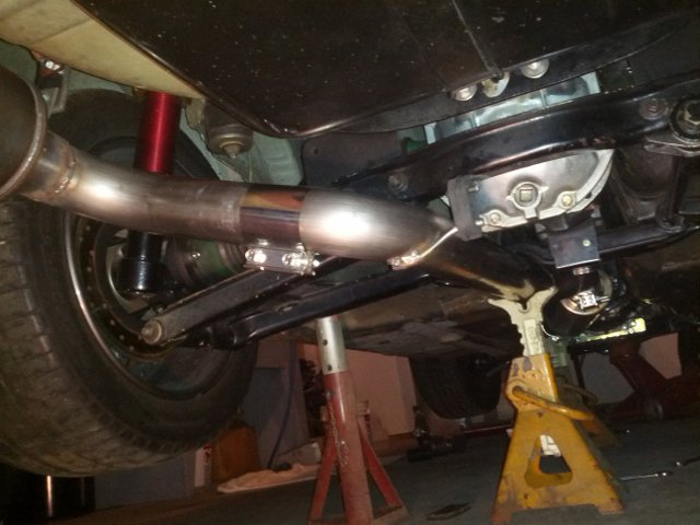

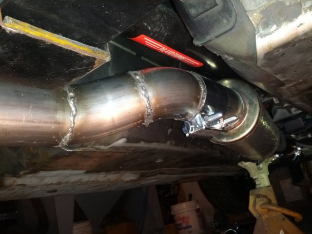

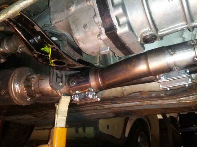

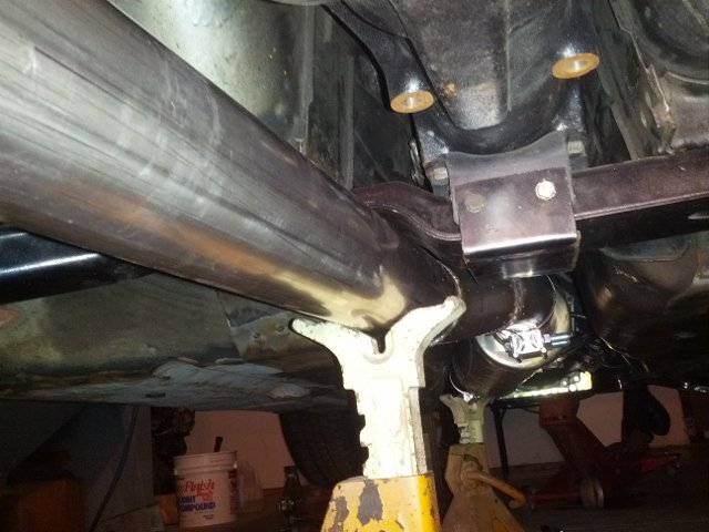

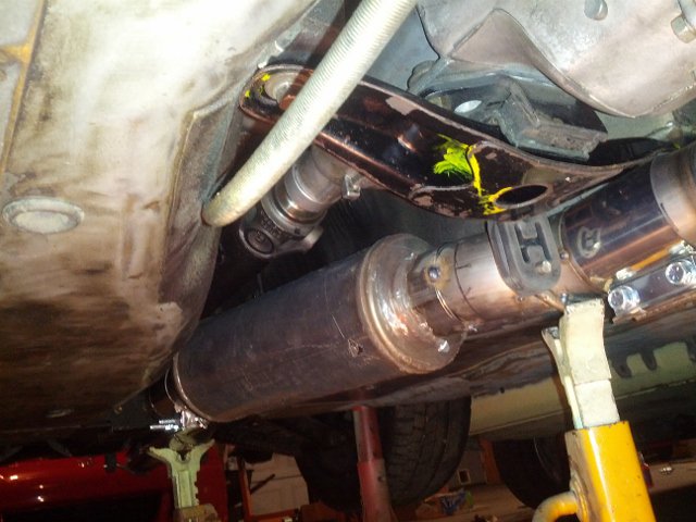

inline6 Posted December 4, 2012 Author Share Posted December 4, 2012 (edited) Time for an update on the 3" exhaust. I have been working on it when I have time, fitting it all together. This past weekend I finally got to start welding the stainless stuff together with my little MIG welder. It is difficult to make the welds anything but fugly. The tip isn't welded on yet... I think I like it the way it is (length of it that is), but I'm going to look at it each time I walk by for a few days before I make up my mind. This 6" round Magnaflow fits nicely: Rear hanger isn't supporting the weight of the exhaust at the moment. I purposely located the stainless wire here at the bottom of the pipe going under the diff... in the case the pipe drags on the road at any time, this will act as a "pad" to keep the pipe from getting scraped up. I'm thinking the exhaust will drop about an 1/8th once all the joints are tightened up and I remove the jack stands: Trying to keep the pipe as close to the car as possible... My ugly welds... I tried practicing on some more scrap tonight. 5" muffler located in the driveshaft tunnel: Merge collector fitted as close to the header as I could get it: Lots of pieces necessary here to fit the header to the merge collector: I hope to finish all the welding this week/week end. Now if I could just locate an LD28 water pump, I could get this thing started. Edited December 4, 2012 by inline6 Quote Link to comment Share on other sites More sharing options...
