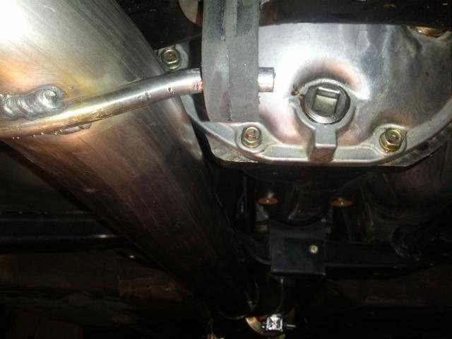

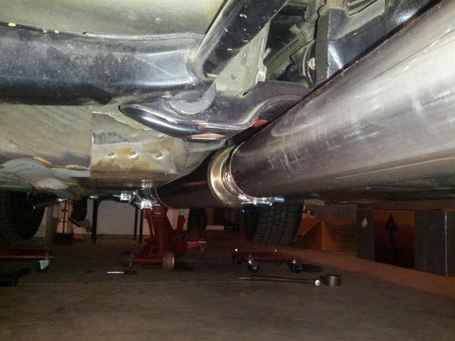

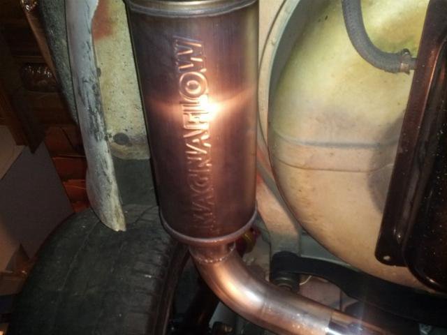

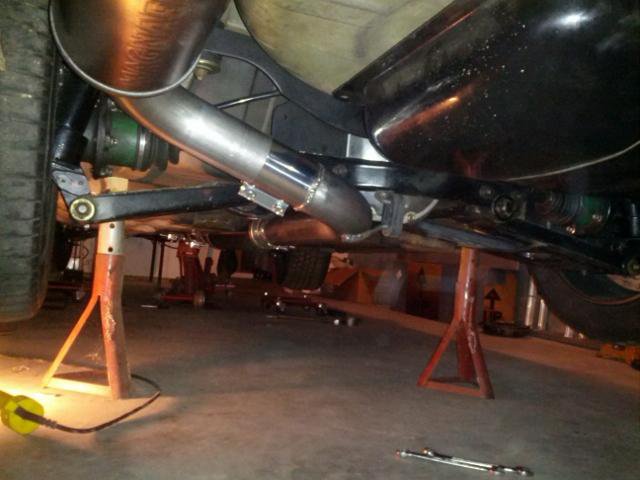

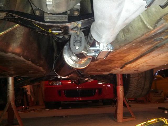

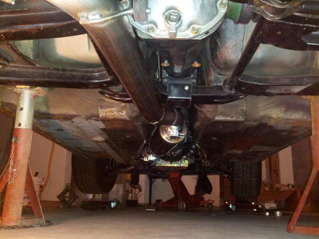

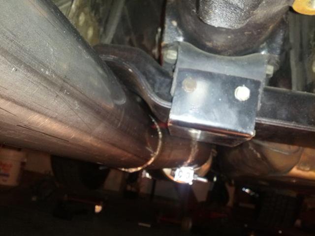

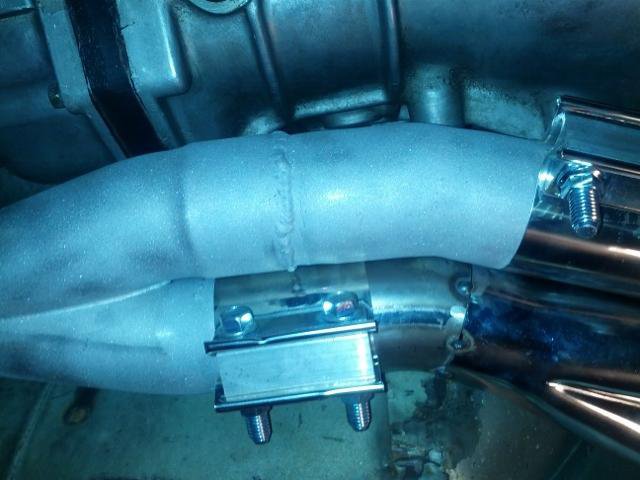

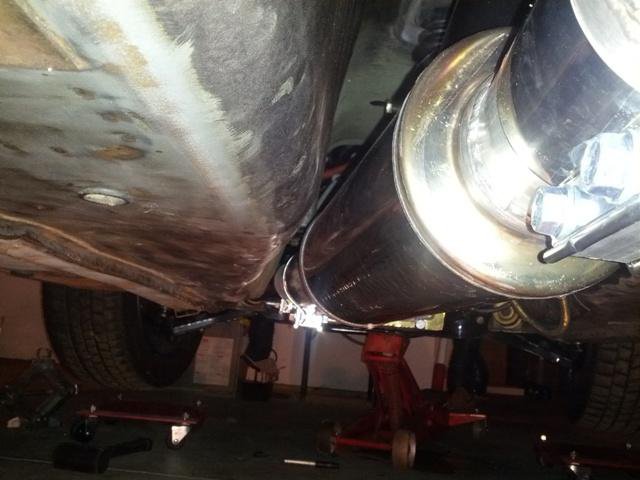

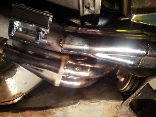

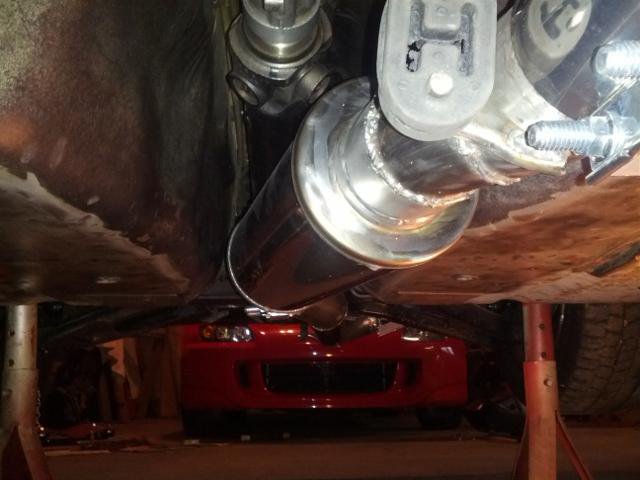

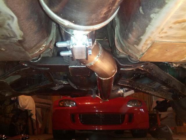

inline6 Posted December 23, 2012 Author Share Posted December 23, 2012 (edited) Exhaust is basically done now. A few more pics. Going to send off the header and the merge collector for ceramic coating soon - while I continue looking for an LD28 water pump. The header still needs some welding. I'll finish that when I pull it off the motor - now that the rest of the exhaust is completely done: Header to merge collector: A different view of the resonator in the tunnel: It's a tight fit: Then the pipe has to swing back to the slot in the rear crossmember: A good shot of how close the pipe is to the diff 'tang': 6" round muffler fits with room to spare: Nothing specific here, but you can get an idea of what kind of road clearance there will be. Rear diff mount "slot" fit on left side: Again, showing space to diff: Rear diff mount "slot" fit on right side: Resonator to floor/tunnel clearance: Edited December 23, 2012 by inline6 Quote Link to comment Share on other sites More sharing options...
