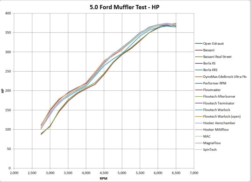

BlackdogNY Posted January 30, 2013 Share Posted January 30, 2013 From the December, 2002 issue of 5.0 Mustang & Super FordsRead more: http://www.mustang50magazine.com/techarticles/m5lp_0212_ford_mustang_muffler_comparison_test/viewall.html#ixzz2JQ8eHCd1 see if this works..... Quote Link to comment Share on other sites More sharing options...

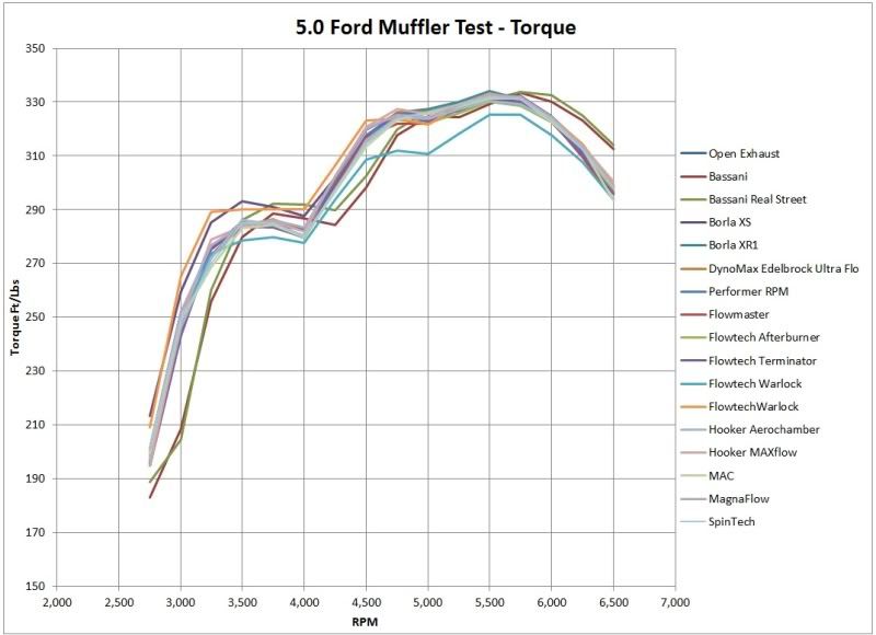

johnc Posted January 30, 2013 Share Posted January 30, 2013 And the Mustang muffler comparison test: The horsepower range was from 373hp to 365hp. 8 hp. The difference is 2% which is well with the margin of error for the chassis dyno they used. What that test tells me (and what they say in the text of the article) is that the muffler chosen made no difference in performance. Quote Link to comment Share on other sites More sharing options...

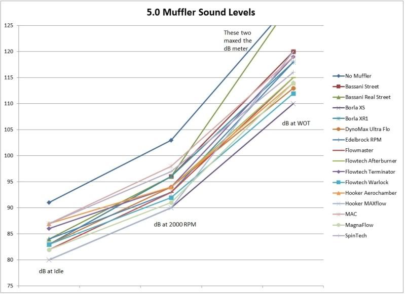

yellowoctupus Posted January 30, 2013 Share Posted January 30, 2013 (edited) Thanks for fixing the link, that was a great article. Roughly speaking, if I remember right 3dB is equalivent to a double in sound pressure intensity. (not horsepower loudness or whatever they called it) "Better yet, all the mufflers handily outperformed an open exhaust, so you can tell that annoying guy in the neighborhood with the jacked-up Nova to put on some mufflers and he'll actually be faster." -Great!! Everybody likes pretty pictures, right? Edited January 30, 2013 by yellowoctupus Quote Link to comment Share on other sites More sharing options...

johnc Posted January 30, 2013 Share Posted January 30, 2013 This was a modified Mustang. I think the tests prove that a aftermarket muffler/pipe can improve performance over stock. Well, no we can't deduce that. This was a modified Mustang that compared an open exhaust and a bunch of different aftermarket muflfers. The results were that there was 2% performance difference between all the mufflers and an open exhaust. That shows that on that particualr car the mufflers chosen stayed out of the way - and that's a good thing. They didn't improve the performance and they didn't restrict the performance. Now, if they had started with a stock Mustang with the stock exhaust and then did the test... who knows. Quote Link to comment Share on other sites More sharing options...
yellowoctupus Posted January 30, 2013 Share Posted January 30, 2013 They didn't improve the performance and they didn't restrict the performance. Now, if they had started with a stock Mustang with the stock exhaust and then did the test... who knows. If the test had been completed on a stock engine, I agree that from a harmonics stand point there might be more interesting data to analyze, however from a backpressure view, a higher horsepower (/ higher airflow) engine would be better suited to test with. Perhaps a greater test of flow would have been to choose all of these exhausts with a smaller inlet/outlet just for a head to head muffler design test. For example, it appears all of the tested exhausts can flow more than enough for this 375hp engine, therefore it is not unlike testing an exhaust flow through a 10" , 15" and 24" exhaust pipe. There would be NO appreciable difference seen between any of these tests as they will all flow more than enough, just like the mufflers tested above. Quote Link to comment Share on other sites More sharing options...

Leon Posted January 31, 2013 Share Posted January 31, 2013 You just don't get it... Inline6 is not looking only for a good sound! This is a track car. I guess I can stick a couple of bananas in my tailpipes and call it good, as long as it makes nice noises, is quiet, and I don't "feel" a difference? I'll repeat, I saw ZERO dyno results in anything posted. All I saw were a couple of bar charts (1/4 mile mph and sound levels) with no supporting data posted. They also showed open pipes as being the "fastest", completely going against the other article you posted. BTW, no where did I insult YOU. Supertrapp is a different story... There's no reason to get so defensive when somebody challenges your choices. The only conclusive evidence here would be a dyno test comparing the Trapp to other mufflers. If you're willing to do so, I'd love to see the results from a properly done experiment, whether they back up my argument or not. Quote Link to comment Share on other sites More sharing options...
