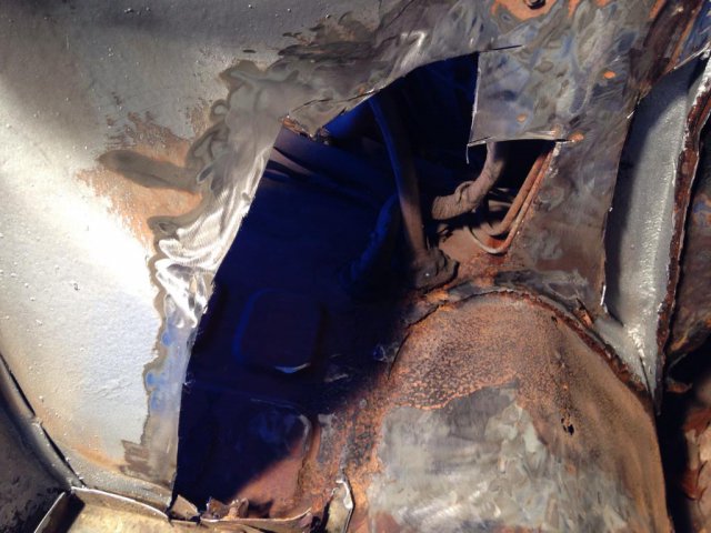

LLave Posted November 11, 2013 Share Posted November 11, 2013 I wouldnt bother scraping that... The whole floor needs to be cut out anyway. I am just wrapping up patching up my floors (which were not NEARLY that bad) and I regret doing it. It would have not been too much more work to replace the entire floor board, with better results. Cut em out and put new ones it. I also recall your rockers were pretty rusted, take a GOOD look at them, realize they are essentially the frame rails of the chassis. Quote Link to comment Share on other sites More sharing options...
bestlowrida Posted November 11, 2013 Author Share Posted November 11, 2013 Yeah i been spending my free time looking at the floors and how I will attack them and were to buy them. Thinking about going with the zedd findings ones with the rails. I pretty much have left is the floors, battery tray, and the front lower rockers. Then I can start doing por15/body sealer/primer/paint. Need to save some money for the floors next. In the mean time I will update when i do the tray and lower rockers. Quote Link to comment Share on other sites More sharing options...
Dershum Posted November 12, 2013 Share Posted November 12, 2013 If you're going to put in new pans, you're going to have to remove the tar around the areas you want to weld to. That stuff is nasty when it melts/catches fire, and will do nothing but destroy your welds. Do yourself a favor and search around for dry ice techniques...I had a post on how I did mine about a year ago. It really beats trying to heat it up w/a heat gun or torch to scrape it off and getting all kinds of lovely melted tar burns on yourself. And it only takes a couple hours once you've got everything prepped and the dry ice. Plus, you get the benefit of getting to impress your neighbors and show off neat tricks w/the dry ice while you're waiting for the insulation to freeze off Quote Link to comment Share on other sites More sharing options...

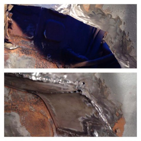

bestlowrida Posted November 16, 2013 Author Share Posted November 16, 2013 (edited) Thanks for the dry ice advice dershum! I didn't get to the floors today but I did the battery tray area. Edited November 17, 2013 by bestlowrida Quote Link to comment Share on other sites More sharing options...
Dershum Posted November 17, 2013 Share Posted November 17, 2013 Thanks for the dry ice advice dershum! I didn't get to the floors today but I did the battery tray area. That's too funny...I have a nearly identical hole right where my battery tray used to be. I'm just finishing up my floor pans, and that's next on my list... Quote Link to comment Share on other sites More sharing options...

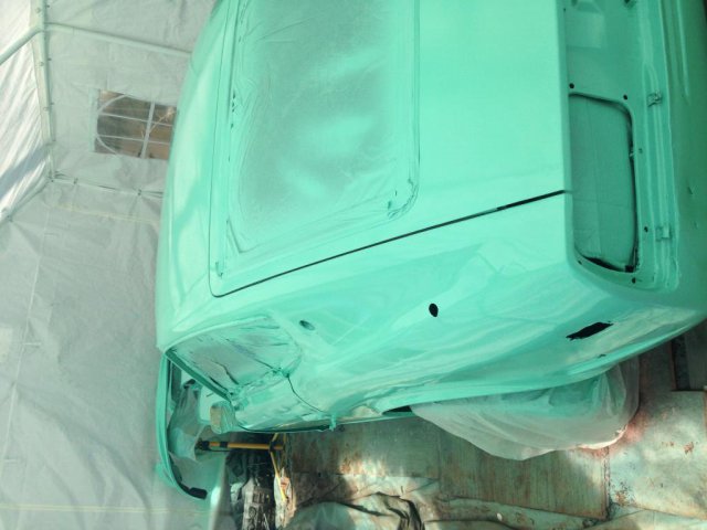

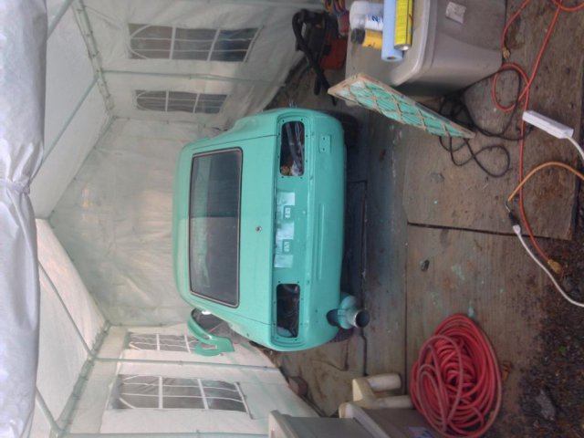

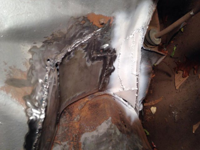

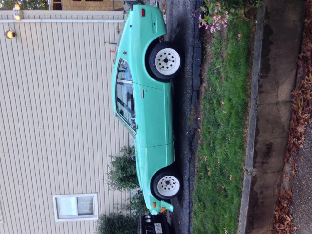

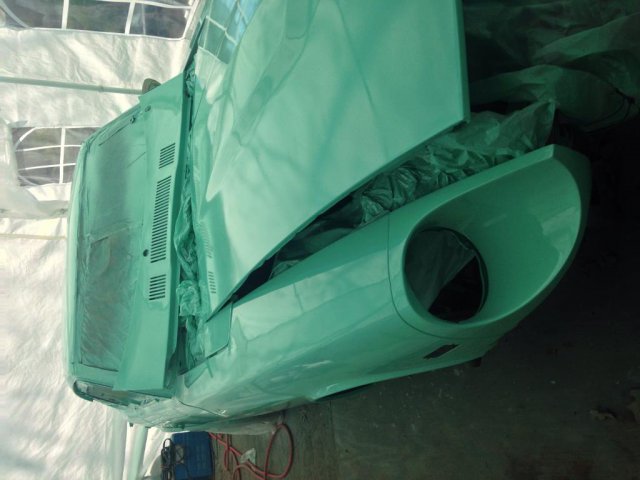

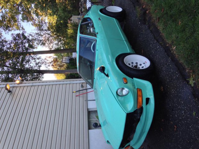

bestlowrida Posted May 4, 2014 Author Share Posted May 4, 2014 It's has been a long winter and it's time to update this thing since it's been a long time. Bottom line is that I finally patched up all the rust in this rust bucket. It was very very teadious, very time consuming and basically a royal pain, but it was all worth it! I finally got to stage were I have to prime and sand and primes and sand and prime and sand! Very fun as you can imagine. Then it was time to paint, I was going to do white or black or red but it seems everyone is doing that so I went with Porsche mint green. It's not perfect because this is only the second full paint job a ever done. It looks better then when I got the car. Now it time to put her all back together and put some undercoat under the car I was thinking por 15? Then figure out what I'm going to use for cabin insulations maybe dynomat? I pick up some miata seat from the local pick and pull. The oem seats are in good condition but they don't hold you in enough. I'll post more pics as I get more time to work on her. Quote Link to comment Share on other sites More sharing options...
Slowpoke Posted May 5, 2014 Share Posted May 5, 2014 Nice color choice. Kudos to you for sticking with it! Quote Link to comment Share on other sites More sharing options...
bestlowrida Posted May 6, 2014 Author Share Posted May 6, 2014 Thanks @slowpoke it's so much work, I forgot to mention that the floors had holes to the front and back palm size and I just patched them and the rest of the floors were pretty stable, going to paint the interior soon with pics. Quote Link to comment Share on other sites More sharing options...

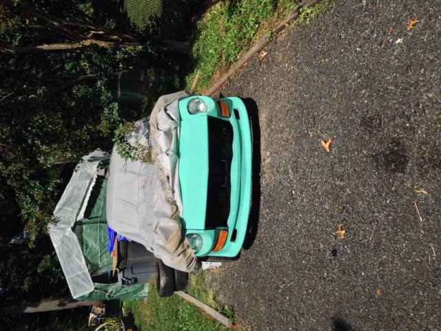

bestlowrida Posted August 25, 2014 Author Share Posted August 25, 2014 More updates for my car out it all back together! Quote Link to comment Share on other sites More sharing options...

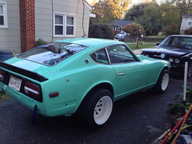

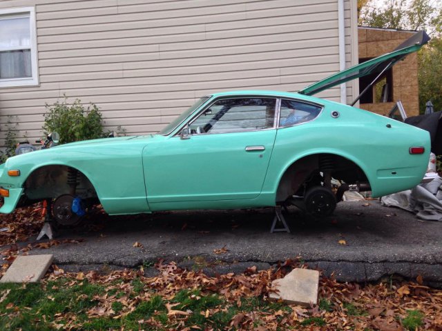

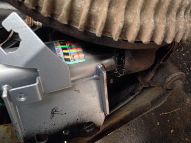

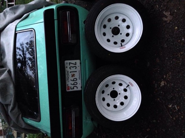

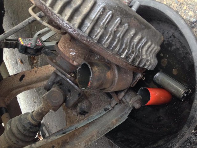

bestlowrida Posted November 13, 2014 Author Share Posted November 13, 2014 Ok sorry about that well here are some updated pics and idk why they keep coming out sideways I got her on jack stands to do undercoating and s13 coilovers before the winter time. Removed the 4 halfshaft bolts the 3 upper strut bolts and she hanging low enough for me to cut off the tube Pressed, welded, and crappy painted the rear lower perch. She's all in there now. I got the wheel mocked up I DEFINITLY will go with flares in the next few months when spring comes around Is there anyway this can be moved to a build thread section? Lol Quote Link to comment Share on other sites More sharing options...
