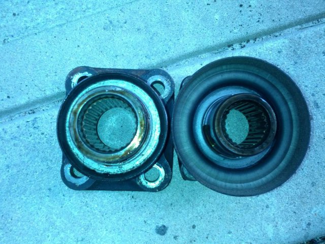

Co0ke Posted May 7, 2013 Author Share Posted May 7, 2013 Well I just posted for help in the drivetrain section. The differential flange out of my 83 R200 from the 280zxt is no where close to the right size to swap into my R180. This guide http://datsunzgarage.com/borg/ clearly states that it should so I'm confused. Maybe I don't have an R200 or an R180 and one of the POs for either car swapped it ? Seems unlikely Quote Link to comment Share on other sites More sharing options...
Leon Posted May 7, 2013 Share Posted May 7, 2013 (edited) On 5/7/2013 at 8:37 PM, Co0ke said: Well I just posted for help in the drivetrain section. The differential flange out of my 83 R200 from the 280zxt is no where close to the right size to swap into my R180. This guide http://datsunzgarage.com/borg/ clearly states that it should so I'm confused. Maybe I don't have an R200 or an R180 and one of the POs for either car swapped it ? Seems unlikely Where exactly does the guide clearly state that an R200 input flange is interchangeable with an R180? Edited May 7, 2013 by Leon Quote Link to comment Share on other sites More sharing options...
Co0ke Posted May 7, 2013 Author Share Posted May 7, 2013 About two thirds of the way down he talks about swapping out the flange....I assumed he was swapping into an R180 since the article is about putting a t5 from an 83 turbo into a 240z. Not clearly stated but implied I guess. I still need to figure out the best course of action. -Weld the flange from the 260z driveshaft to the 280zxt driveshaft while shortening it (diameter difference may be a problem?) - just make a custom driveshaft with remove able u-joints and such? - try and put the "R200" in? I really wanted to wait till I could afford an LSD to do any expensive custom work to the rearend. But my credit card may just need to take a hit here. Man I hope I get this new job! Quote Link to comment Share on other sites More sharing options...
Leon Posted May 8, 2013 Share Posted May 8, 2013 (edited) On 5/7/2013 at 9:33 PM, Co0ke said: About two thirds of the way down he talks about swapping out the flange....I assumed he was swapping into an R180 since the article is about putting a t5 from an 83 turbo into a 240z. Not clearly stated but implied I guess. I still need to figure out the best course of action. -Weld the flange from the 260z driveshaft to the 280zxt driveshaft while shortening it (diameter difference may be a problem?) - just make a custom driveshaft with remove able u-joints and such? - try and put the "R200" in? I really wanted to wait till I could afford an LSD to do any expensive custom work to the rearend. But my credit card may just need to take a hit here. Man I hope I get this new job! Right, he's not very clear, and I don't think he even implies that R180 and R200 input flanges interchange. With that said, that site is more of a primer for those starting to learn about Zs. There is a good bit of misleading and erroneous information on his site, so don't treat it like gospel. Putting in an R200 requires zero "custom" work. It's bolt-in as long as you have an R200 mustache bar. Edited May 8, 2013 by Leon Quote Link to comment Share on other sites More sharing options...

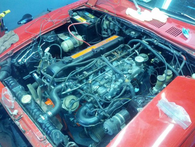

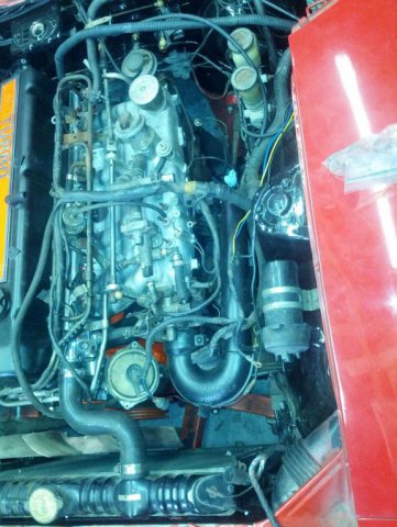

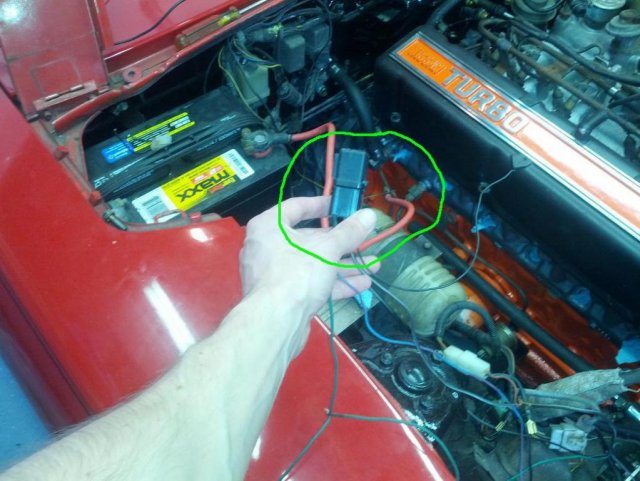

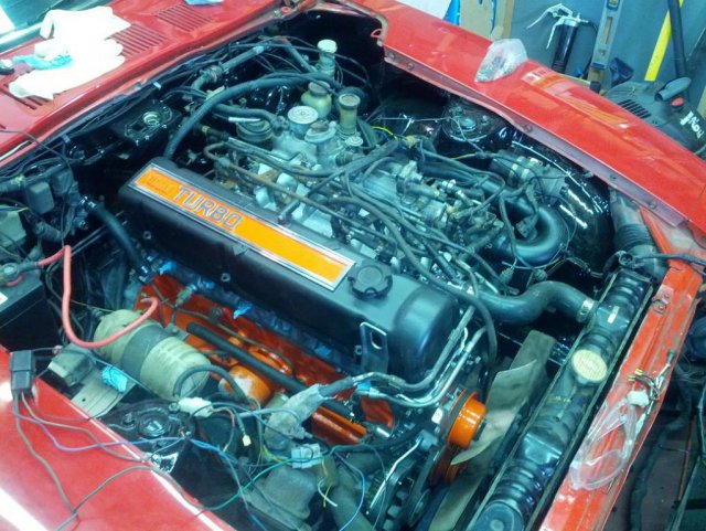

Co0ke Posted May 13, 2013 Author Share Posted May 13, 2013 While I'm waiting on the Driveshaft, I decided to tackle the fuel pump, radiator, vacuum hoses and some of the wiring this weekend. I'll post some pictures, maybe later today. I got stuck a few times but think I grasp most of it. Current issues: -Fuel pump relay - I forgot to grab this off the donor but there is a ton of just standard relays still attached to other harnesses. Can I just use a standard relay? it plugs right up or is there something special about the fuel pump relay? -Fusable links...Looks like I need a few that I didn't grab hopefully I can find some in my mess of wires (not sure if I've seen what one looks like lol) - Condensor that connects the Coil to the distributer....What does this look like? I must have it but dont know what I'm looking for anyone have a picture? - Crank Angle senor is in the distributer ive been told but does it need to be connected somehow? - Oil pressure sender has two connectors, the 260z one had one. I read that one is a switch or something the other is for your gauge. is this correct? so I can just attach a wire to whatever the correct connecter is and get a reading? Thats it for now that can think of. Quote Link to comment Share on other sites More sharing options...
tooquick260 Posted May 13, 2013 Share Posted May 13, 2013 I picked up a relay from autozone for $9.00 seems to work for me. I think as long as it has these prongs you should be fine. Went through all that 2 weeks ago. I didnt have the actual factory plastic receiver that the harness attaches to. Quote Link to comment Share on other sites More sharing options...
tooquick260 Posted May 13, 2013 Share Posted May 13, 2013 On 5/13/2013 at 3:41 PM, Co0ke said: While I'm waiting on the Driveshaft, I decided to tackle the fuel pump, radiator, vacuum hoses and some of the wiring this weekend. I'll post some pictures, maybe later today. I got stuck a few times but think I grasp most of it. Current issues: -Fuel pump relay - I forgot to grab this off the donor but there is a ton of just standard relays still attached to other harnesses. Can I just use a standard relay? it plugs right up or is there something special about the fuel pump relay? -Fusable links...Looks like I need a few that I didn't grab hopefully I can find some in my mess of wires (not sure if I've seen what one looks like lol) I took the ceramic block off the 260z's coil that has some ignition hot connectors. Here is a picture. I attached the coil mount that had this already attached and piggybacked with the turbo's coil mount. I also went to autozone and bought some fused wires that I ran off the starter positive to feed the ECU and the fuel pump relay. Did not take picks of that, but will for you if you want. - Condensor that connects the Coil to the distributer....What does this look like? I must have it but dont know what I'm looking for anyone have a picture? I didnt take a picture of this but its the usual round tube(metal) has a mounting prong in a shape of a Y, attaches to the coil bracket mount bolt. - Crank Angle senor is in the distributer ive been told but does it need to be connected somehow? Yes it is a round to round plug. The distributor has it and is about 6 inches long, plugs into the ECU. Pretty straight forward. - Oil pressure sender has two connectors, the 260z one had one. I read that one is a switch or something the other is for your gauge. is this correct? so I can just attach a wire to whatever the correct connecter is and get a reading? Yes if you have the 280zx sender pretty straight forward. plug and play. Thats it for now that can think of. Quote Link to comment Share on other sites More sharing options...

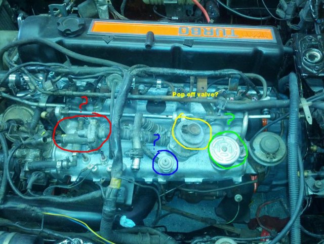

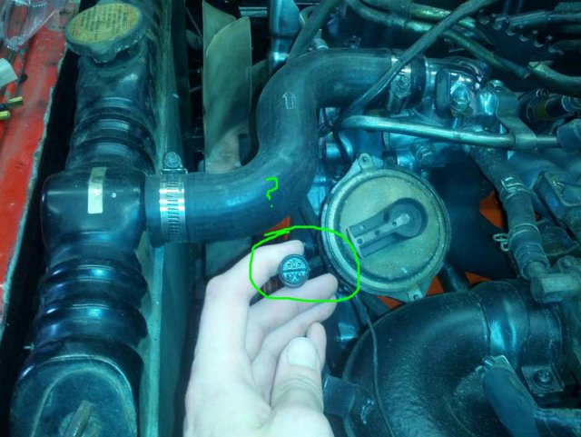

Co0ke Posted May 16, 2013 Author Share Posted May 16, 2013 Thanks, the relay I grabbed had all those prongs and plugged into the old female end. It came out of a cluster. Hopefully it works. Forgot to take a decent shot of the coil. Every wire coming out has a place to go. So I'm assuming all is well and the small box with the T connection looks like the ignitor to me. The round plug blue wire plugged into the harness and goes to the tach I believe. I have what appears to be the condensor on my old coil just one y connector to the mounting bolt. Aside from the CAS wire which plugs nicely into the harness, this wire is coming out of the distributor can't figure out where it goes or if its important? Oil sender T connector. A way to test or know which goes to the gauge? does it matter? Figured out the Green and Brown wires ....have the old fusable link box. Must have known it was important and kept it Here's a pic of where the intake is at. I know most of these can be deleted. Will any need something to compensate for them? Quote Link to comment Share on other sites More sharing options...

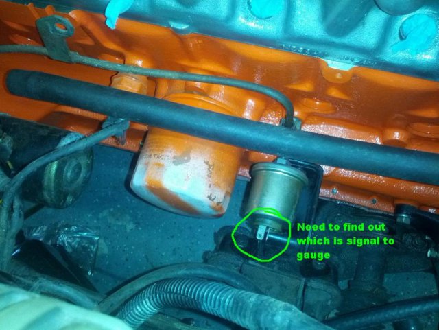

tooquick260 Posted May 17, 2013 Share Posted May 17, 2013 The round 4 prong out of the distributor should go directly into the harness with a similar looking connection. There is also a single male prong that is on the side of the distributor, it goes the the T shape of the ignitor on the coil. The intake items you are talking about are for cold start and I believe blow off. Yes not much needed. I switched my intake to a non turbo one that only has the cold start switch. Pretty sure that the oil sender does not matter! Quote Link to comment Share on other sites More sharing options...

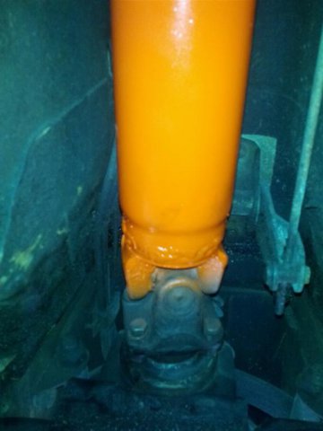

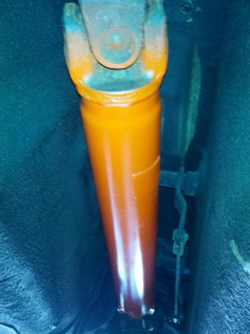

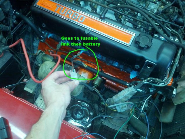

Co0ke Posted May 29, 2013 Author Share Posted May 29, 2013 I found the condensor! Didn't take any pics of that yet but it all makes sense now. I have four condensors.....from somewhere i don't know, but three of them have only one connection and I was so confused as to how it was meant to hook up. Anyway I got pissed on Monday and took everything out of my garage, re-organized and stumbled across the condensor with two connections! Driveshaft is in....not balanced. Cut the U-joint off the old one, used a 1" strip to increase the diameter and tapped it snuggly into the larger zxt driveshaft. Definitely custom, hopefully holds up and doesn't vibrate or I'll just drop the money on a custom one. Still have to finish wiring up the fuel relay. I attached the black/W wire to the fusable link box and to the battery and the EFI Relay clicked....so that didn't seem right without a key in the ignition. Quote Link to comment Share on other sites More sharing options...
Co0ke Posted May 29, 2013 Author Share Posted May 29, 2013 On 5/22/2013 at 6:54 PM, tooquick260 said: At my pace you may be cruising before I do! Looks like your about to cruise around ...I need at least anoth week. Quote Link to comment Share on other sites More sharing options...
cgsheen Posted May 29, 2013 Share Posted May 29, 2013 (edited) On 5/29/2013 at 2:44 PM, Co0ke said: Still have to finish wiring up the fuel relay. I attached the black/W wire to the fusable link box and to the battery and the EFI Relay clicked....so that didn't seem right without a key in the ignition. Wait. What? The Black/White originates at the IGN switch and energizes at IGN ON to power various components. Are you mistaking the White/Black that originates at the battery, through a fusable link, then to the Fuel pump relay as a "source" voltage for the pump? (Also "source" voltage to the IGN switch) Don't confuse those two... Edited May 29, 2013 by cgsheen Quote Link to comment Share on other sites More sharing options...
