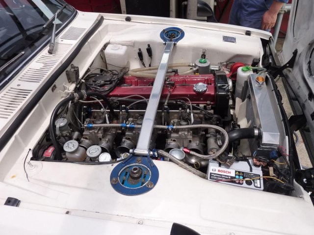

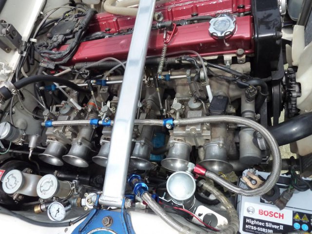

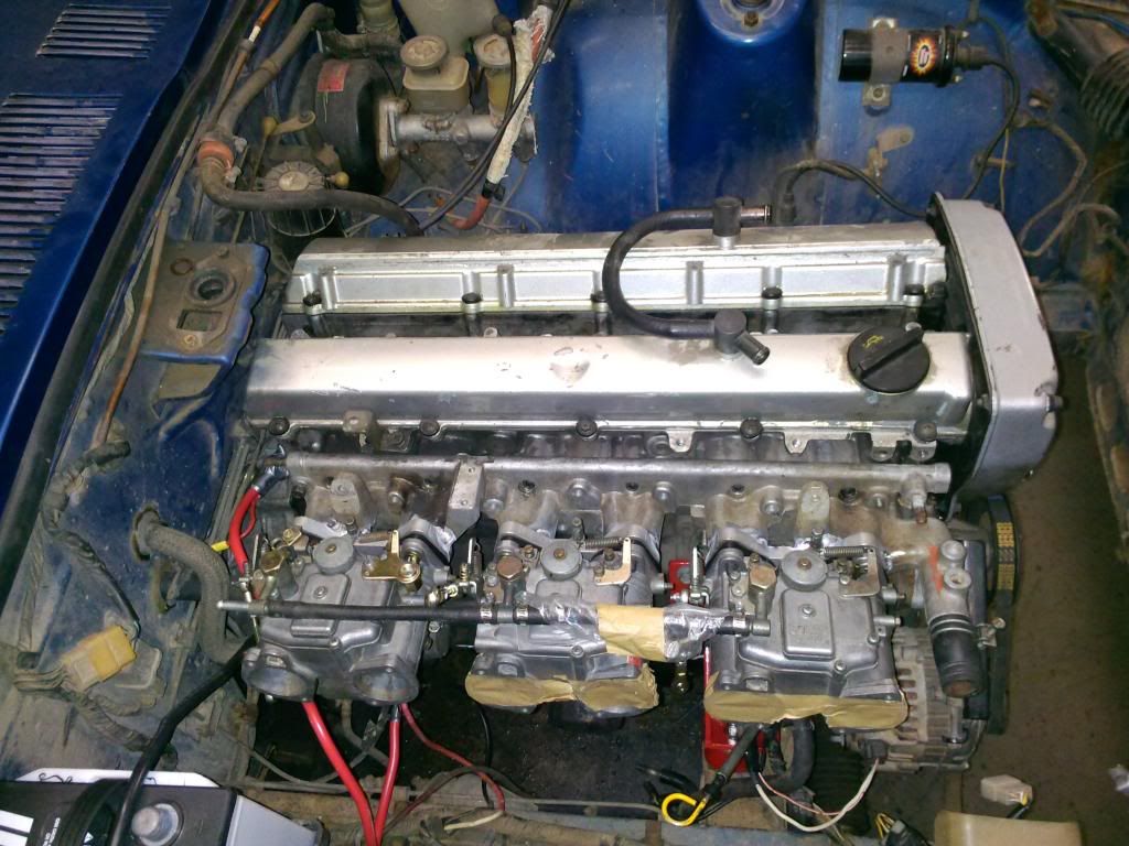

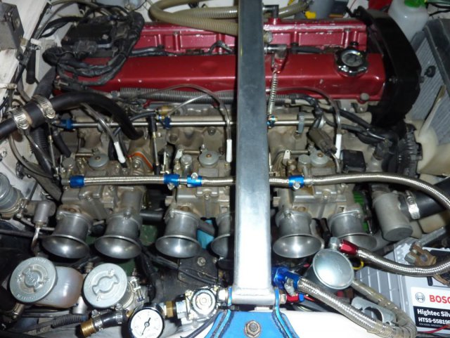

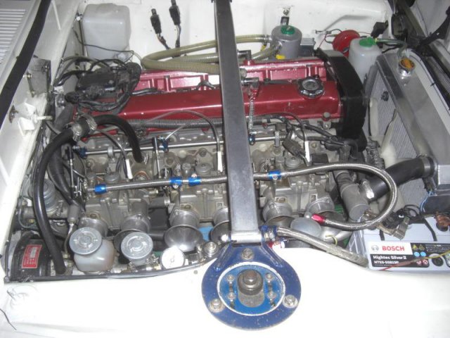

docaam Posted December 26, 2012 Share Posted December 26, 2012 Sorry forgot to post these pictures from a KGC10 here its a RB20 with triple carbs (40DOCE), he is not that happy as cant run bigger carbs on this and might be changing to RB26DE (he has one of those rare ones) Quote Link to comment Share on other sites More sharing options...
dwarlick Posted December 26, 2012 Author Share Posted December 26, 2012 Thank you for the pictures. I am confused is that the picture of the reworked RB26 intake manifold on an RB20? Or is that someone elses motor if so what intake manifold is that? It appears OEM. Quote Link to comment Share on other sites More sharing options...

djz Posted December 27, 2012 Share Posted December 27, 2012 Thank you for the pictures. I am confused is that the picture of the reworked RB26 intake manifold on an RB20? Or is that someone elses motor if so what intake manifold is that? It appears OEM. Looks to be a factory RB20 manifold that's had DCOE flanges welded to it. Quote Link to comment Share on other sites More sharing options...

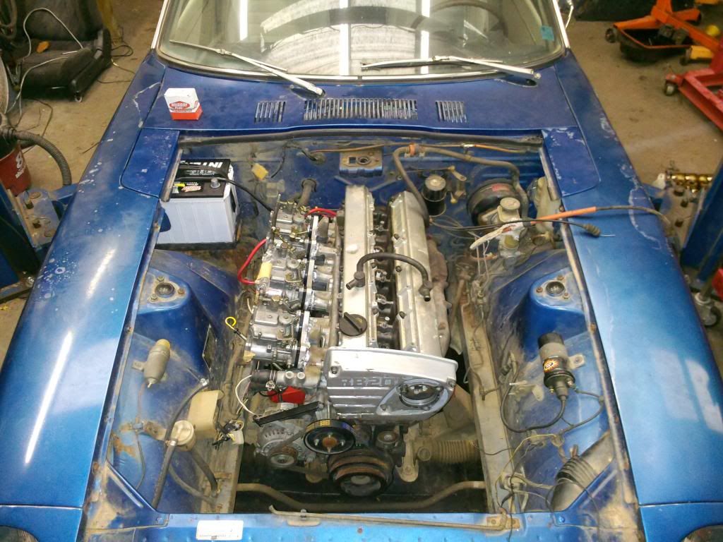

dwarlick Posted January 12, 2013 Author Share Posted January 12, 2013 The flanges are welded to the old intake the alignment is pretty close it will require a little grinding to smooth out the rough edges. Now on to the linkage. Quote Link to comment Share on other sites More sharing options...
R3VO 3VOM Posted January 12, 2013 Share Posted January 12, 2013 Now that looks cool. Hopefully it starts and runs. May not make a lot of power because the compression ratio will be low and cams being tuned for a turbo and boost, but that all can all be fixed. Either way, looking nice!! Quote Link to comment Share on other sites More sharing options...

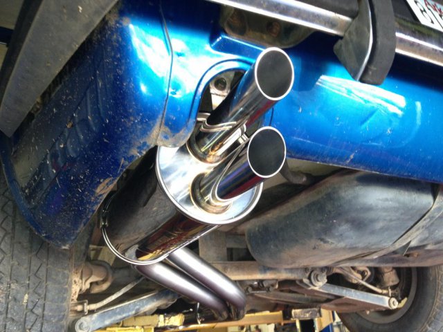

dwarlick Posted May 17, 2013 Author Share Posted May 17, 2013 (edited) Its been a slow process getting this thing going but I do have a few updates. The motor is running and the ignition system is firing correctly I abandoned the Megasquirt/CAS attempt and opted for a Megajolt/EDIS setup. I could have used the Megasquirt with EDIS which is what Matt at Megasquirt kept telling me but I was intent on using the CAS in my attempt to mod the board to read the CAS I fried it following the wrong wiring diagram. The megajolt setup is super simple and very small. The coby header was able to be retro fitted and looks very nice the guy who did it did an amazing job and you can't even tell it has been modified. I found a very nice Fujitsubo exhaust from Japan that is commonly used on the Z432. I will make a video of the motor running and take a few more pictures in the next few weeks. After I get the drivetrain sorted I am going to strip the car down to the shell and get it off to paint. While it's in jail I am going to swap the cams and pistons for n/a. Edited May 17, 2013 by dwarlick Quote Link to comment Share on other sites More sharing options...

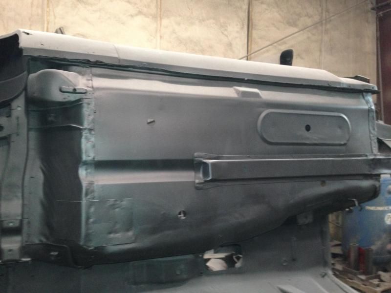

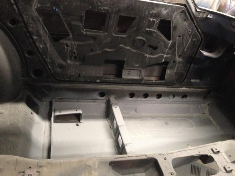

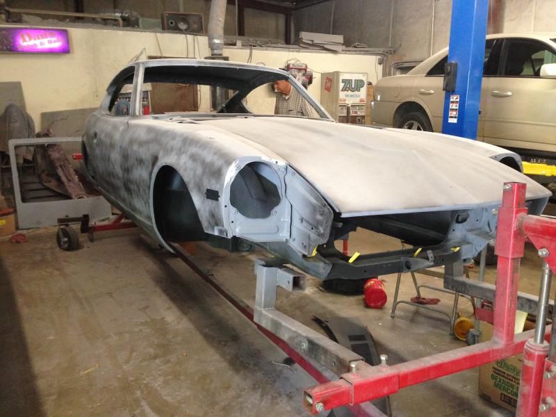

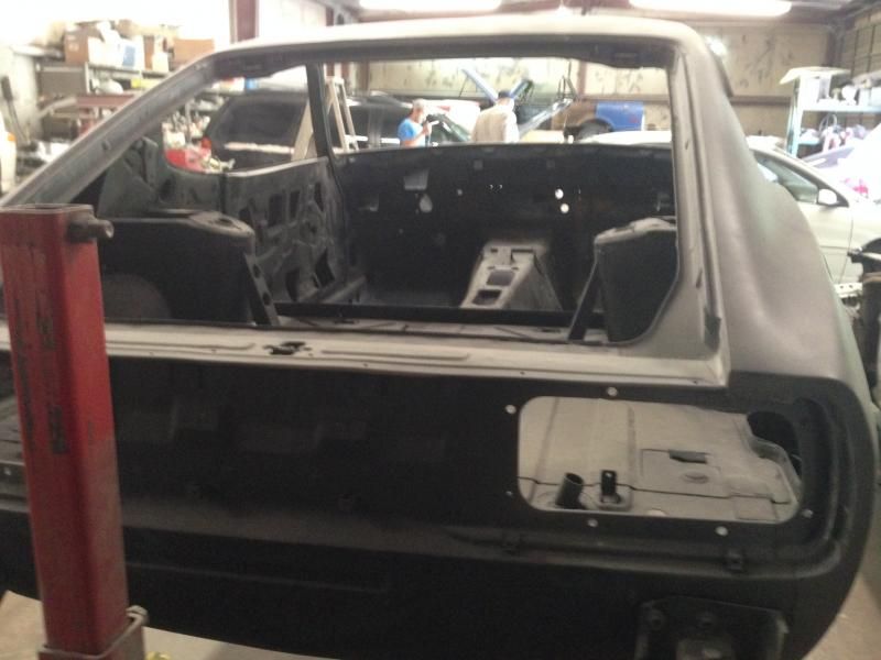

dwarlick Posted September 12, 2014 Author Share Posted September 12, 2014 Believe it or no this project is progressing. The body is very close to being ready for paint. The floor pans were replaced and the frame was trued up and straightened on the frame machine. I am very happy with the job this shop has done. It has been with them for a long time but they have worked steady on it the entire time they have had it. I can't imagine the hours they have in this rotisserie restoration. I can't wait to see it painted. Quote Link to comment Share on other sites More sharing options...

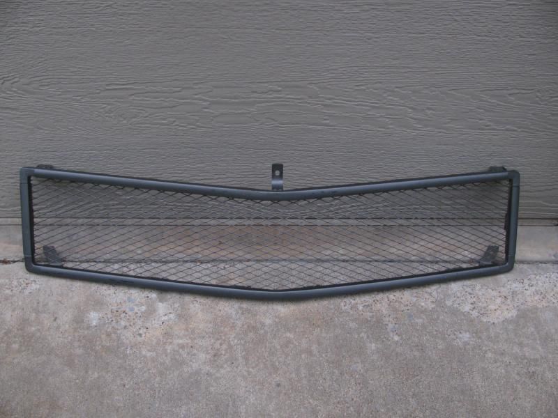

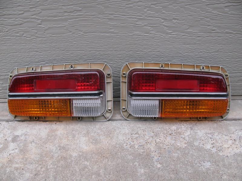

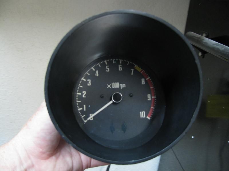

dwarlick Posted September 12, 2014 Author Share Posted September 12, 2014 (edited) In the mean time I have been accumulating parts for the build. I have a few rare JDM parts that will help to make this closer to an actual z432 rather than just the look. My goal is to simulate the driving experience as close as possible. JDM Tail lights (reproduction) JDM Grill (NOS) PS30 10K Tach (Used) Edited September 12, 2014 by dwarlick 1 Quote Link to comment Share on other sites More sharing options...
