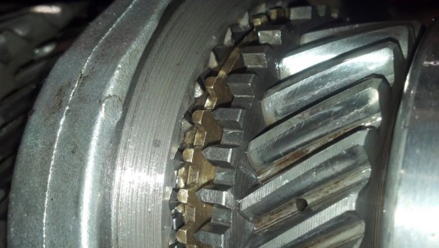

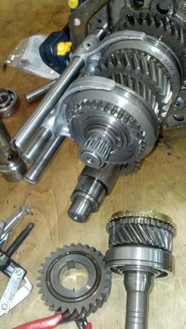

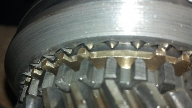

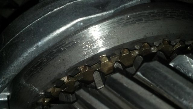

duragg Posted February 18, 2013 Author Share Posted February 18, 2013 Today: Pulled the C/G Main drive gear which allows removal of the input stub, 4th gear and access to the synchro ring, springs and keys. Indeed I could do surgery on just these parts without having to strip the entire main shaft. If you have read the article referenced above by Jacks's Transmission then the pictures below will be self-explanatory. 2nd gear looks perfect 3rd gear looks like it is too far. Jack calls this "Teeth preloaded too early". Same with 4th, to a lesser degree: I believe the gears and hub are all assembled properly. There is a note in the FSM about making sure this 3/4 hub is installed correctly, but it could be vague on the exact direction of installation. Assuming "Front" means Front of car? Or does it mean something else in metric? I can assemble my spare shaft (as if) and test easily enough. I believe if I could case 3/4 to look like 1/2 I would be home free. Still mentally determining if springs tension would even alter this, or if it involves machining. Quote Link to comment Share on other sites More sharing options...

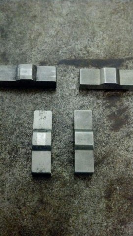

duragg Posted February 19, 2013 Author Share Posted February 19, 2013 Trans gear-set is back together and sure looks to be in better shape for fast shifting. Regarding 3&4 grinding, all the parts looked perfect except for a few anomolies. The 3&4 Synchro hub was a little narrow. Of the two I had one was .030" wider so I used that one. I analyzed and measured my 9 spare keys and picked the best and sharpest. Installed about .060" shim under the key springs and installed the widest and cleanest slider i had. I used two #2 stainless washers which are each about .030" under the spring keys. Anymore and you just can't get the keys in there before exhaustion sets in. I also noted some unusual wear and metal transfer on the 3&4 shift fork, and so I switched to my spare fork. And also one of the sliders was wider than the others so I ran that one. After doing this when I begin to engage 3rd gear, simulating the gears in action, the dog keys all line up just right. So I am hoping for a "good kill" this time. When I pulled the tranny Saturday there was some leakage from the shifter area so I ordered new o-ring and lip seal for the shifter mechanism which has to come Overnight from LA. Lastly... A few times while beating on the car and reaching for 3rd gear I got 5th instead. To preclude this I put a shim under the 5/R thing to increase the force required to get into 5th. This should give me a better gate to 3rd. Should be back on the road late this week and finally done with tranny mods with no leaks and a whole lot more knowledge on what to look for when rebuilding a tranny. Quote Link to comment Share on other sites More sharing options...

duragg Posted March 19, 2013 Author Share Posted March 19, 2013 (edited) Sneaking up on the best solution for "High RPM shifting dynamics". I finally have all my new parts in from Nissan and tonight did some research on my spare tranny setup. I have a shaft configured for testing various configurations. I can test keys, engange rings, synchros, and all sorts of stuff. Tonight I experimented with shims under the key springs to see about how much pressure the Engage Ring can put on the Brass Ring before the keys give way and allow the Engage Ring to slide by. 1) Stock springs with new keys and new Engage Ring about 12 pounds. 2) Add a .030" spacer under the key spring the Engage will put about 14lbs on the Brass prior to giving up the dugout. 3) Add a .060" spacer under the key spring the Engage will put about 17lbs on the Brass prior to giving up. 4) Add a .090 spacer and the force goes to infinity as the key springs are coil bound. If you can visualize the way the keys work, they put the most pressure just after contact with the ring, and before the keys have had a chance to begin to receed much, its all downhill from there. This is only about .010" of "squish" on the keys before they give it up. This is the reason Jacks wants to "tune" the Engage Ring, keys and slider to hit at just the right time. You want the Engage ring to smack its keys into the brass ring and pound it onto the gear cone initially, then with just about .010" movement compress the keys slightly JUST as the Engage Ring teeth mesh perfectly with the Brass RIng Teeth which prevent any further movement untl synchronization is complete, at which point the brass ring moves aside and lets the engage ring make the gear. ... is my theory this time... Edited March 19, 2013 by duragg Quote Link to comment Share on other sites More sharing options...
