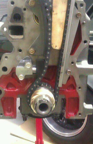

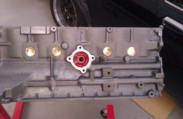

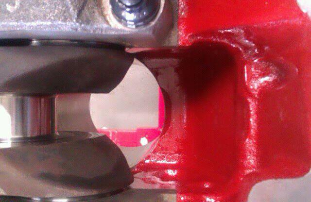

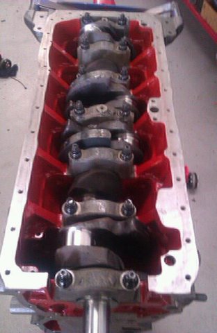

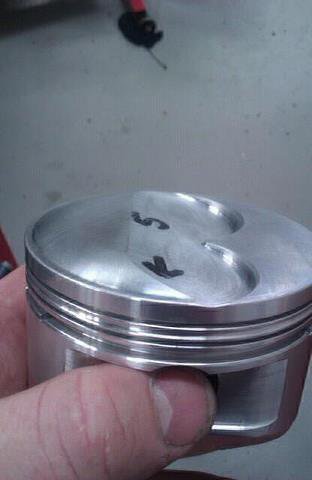

PMC raceengines Posted January 16, 2013 Share Posted January 16, 2013 (edited) Just some pics off a stroker im building for a road rally engine engine was sonic tested and then grout filled to the top of the welsh plugs and then torque plate bored and honed to 89mm , all oil plugs have been removed and internaly cleaned , i also milled the block to make room for the crank , then it was spin washed and cleand , before paint in side and out main bearings were set at 2.3 to 2.4 th and thrust at 0.006 , block was very straght and the crank turns very well , 1 finger spins the crank with ease , rods are honda 18b 137mm long 400g with arp 2000 bolts clearance was set at 0.002 piston is a forged sps with 1 mm top ring 1.2 sec ring 3mm oil ring piston has a +6cc bump as the head is a p90 will post more pics as i build it this week and a vid as it hit the engine dyno Edited January 17, 2013 by PMC raceengines Link to comment Share on other sites More sharing options...

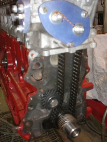

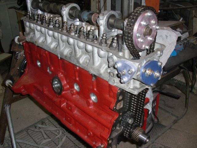

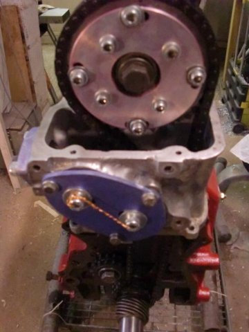

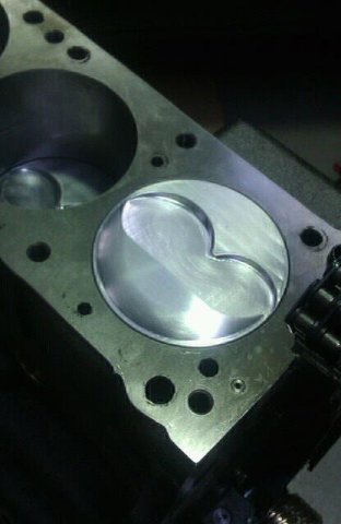

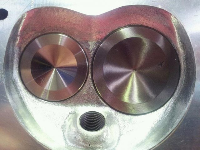

PMC raceengines Posted January 18, 2013 Author Share Posted January 18, 2013 (edited) Some more pics , pistons in and timing guides and a brass oil pump drive fitted , next up the p90 with water mods and port work pics Edited January 18, 2013 by PMC raceengines Link to comment Share on other sites More sharing options...

jeffp Posted January 25, 2013 Share Posted January 25, 2013 You just may want to consider a chain adjuster. Get that piston off the job and go manual adjuster. That will keep valve train stability, you don't have room for chain slop, it does make a big difference. and while you are at it, buy the adjustable cam gear, and make sure the cam timing is matching the cam card. looks like a cool build. What is the static compression with the extra 6cc's of piston space? Link to comment Share on other sites More sharing options...

PMC raceengines Posted January 27, 2013 Author Share Posted January 27, 2013 (edited) Thanks jeffp lol after 300+ L builds i never new anything like that about the cam timing lol and yes its a rb30 crank thats been worked over to fit , just so you know Jeff i have my own range of parts for the L motor like cnc cam gears and brass oil pump drives, and yes we do know how to time a cam .. thanks Edited January 27, 2013 by PMC raceengines Link to comment Share on other sites More sharing options...

Ben's Z Posted January 28, 2013 Share Posted January 28, 2013 Peter, I am intrigued by the one finger spin of the crank. What are the steps to getting it to that level. I wouldn't even want to guess the amount of "free" horsepower one picks up if the crank spins with such ease. Any longterm issues with oil pressure on something like that? What is the theory behind that glyptol (spelling) engine paint? Link to comment Share on other sites More sharing options...
