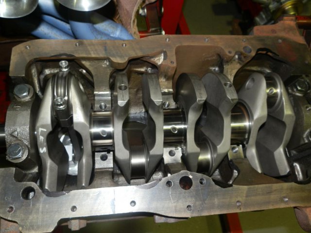

PMC raceengines Posted February 2, 2013 Author Share Posted February 2, 2013 (edited) Some pics of a stroker L 4, thats done the same way Tony, this one is a 2.3 twin cam Edited February 2, 2013 by PMC raceengines Link to comment Share on other sites More sharing options...
Tony D Posted February 2, 2013 Share Posted February 2, 2013 We call that an "L20B" here in the states! LOL (Or was that Z24? Did you guys get the LZ series down there?) Take the truck LZ24, Use the L-Head, muahahahha! 2.4 four cylinder... Link to comment Share on other sites More sharing options...

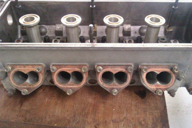

PMC raceengines Posted February 2, 2013 Author Share Posted February 2, 2013 This is a LZ head Link to comment Share on other sites More sharing options...
Tony D Posted February 3, 2013 Share Posted February 3, 2013 Yeah, no gear drives here in the US... I've been out of the L4 stuff for a while... KA's were new the last time I messed with a Z24 Hybrid. I've heard the KA Swap... But then again if I could get a BDA Ford... Link to comment Share on other sites More sharing options...
