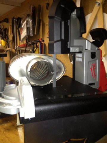

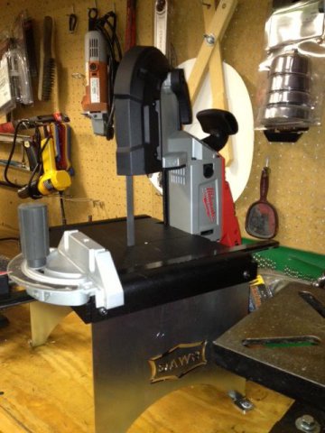

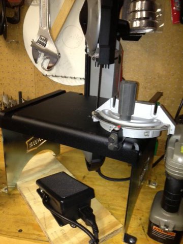

RebekahsZ Posted February 1, 2013 Author Share Posted February 1, 2013 I have the whole setup done. Ready to start cutting! Quote Link to comment Share on other sites More sharing options...
