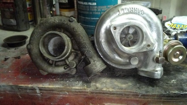

mattb3562 Posted February 16, 2013 Share Posted February 16, 2013 I will let you all know in a couple months if this as good idea as I believe it will be. The stock t3 on my l28et was missing some parts, so I needed to come up with one for my turbo swap into a 76. My buddy had a Garrett a/r60 m11 that came off an 88 SVO that I got for free. It has .60 trim on compressor side and .48 on the exaust, so I used my .63 exaust housing with internal wastegate from stock turbo. The m11 has an oil/water cooled center, so it should last a while on a timer. I know it's not gonna make huge power over stock, but if it spools as well as I think it will, I think it will be a good cheap option for all of us wanting about 275 whp. That's what I'm shooting for at 14-15psi. I know that it will not have the capability of the common t4 upgrade, but like most here, on a working man budget, you can see the compressor size difference and these Garrett's can commonly be found around $150. And I think it will last alot longer than an ebay special. I will post progress when I get it all put together. Quote Link to comment Share on other sites More sharing options...
skirkland1980 Posted February 16, 2013 Share Posted February 16, 2013 So the turbine wheels are the same size? Quote Link to comment Share on other sites More sharing options...
letitsnow Posted February 17, 2013 Share Posted February 17, 2013 A stock T3 will make 270rwhp. Quote Link to comment Share on other sites More sharing options...
Six_Shooter Posted February 17, 2013 Share Posted February 17, 2013 I used the Ford 2.3 Turbo on one of my old V6 builds, a 3.2L. It made 250HP (dyno), though it may have been a little fuel limited, this did seem to be the limit of these turbos air flow wise. I felt that it was a bit small for my application, but thought it might work well on an engine less than 2.8L. Quote Link to comment Share on other sites More sharing options...
Xnke Posted February 17, 2013 Share Posted February 17, 2013 You just put the stock turbo right back on...with a water cooled center housing. Not a bad idea, the water cooling should help with oil temperature control, but as far as the compressor goes... There was no upgrade there. Yes, the compressor housing looks bigger on the outside...it is...but most all of the information I have on the stock Nissan T3 is that it's a 60 trim T3 compressor. Quote Link to comment Share on other sites More sharing options...

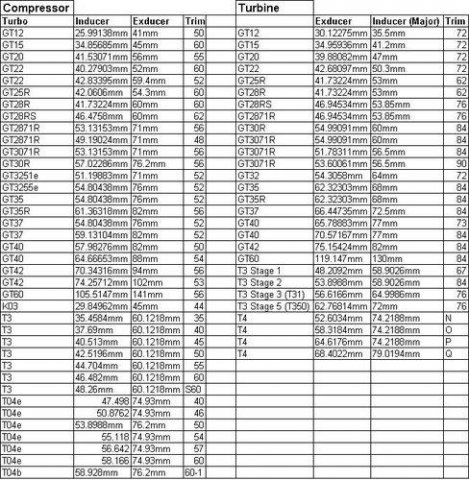

mattb3562 Posted February 21, 2013 Author Share Posted February 21, 2013 Again, I appreciate all of the response, as this has been a very informative conversation. My 275 whp goal was not as important as being in a 12 sec bracket. ( plenty fast for a driver, IMO) The issan turbo i have had no wheels to measure, but according the wheel chart posted, all t3. 60 trim compressors will have the same wheel size. Difference in size, being in different trim. Ergo, if you can find the specs by part number or however on a factory turbo, assuming it hasnt been monkeyed with, you should be able to tell wheel size. According to this chart anyway. But yes, the turbine wheel from the. 48 ford housing fit perfectly without modification in the. 63 nissan housing. With all of that being said, I am still convinced that this larger compressor with the same wheel size will flow better than the nissan unit. I love your idea, Tony, about the quicker spool and more bottom end making for a more responsize street car. Think I'm gonna go that route and after some research, I'm gonna go ahead and throw in my n/a cam out of my 76. I'm gonna trow out the concern on overall hp at this point. But again, thanks, fellas. Quote Link to comment Share on other sites More sharing options...
Xnke Posted February 21, 2013 Share Posted February 21, 2013 The Ford T3 is the SAME COMPRESSOR WHEEL IN THE SAME HOUSING. It's not any bigger. There was no upgrade there. The .48 A/R housing would do exactly what Tony said, bring in the boost sooner...but it would behave identically to the Nissan turbo with the same .48 A/R housing. Every functional turbocharger has wheels to measure...we're talking about the moving parts! If your Nissan turbo didn't have wheels to measure, it was a center housing, turbine housing and a compressor housing with no moving parts... Quote Link to comment Share on other sites More sharing options...
