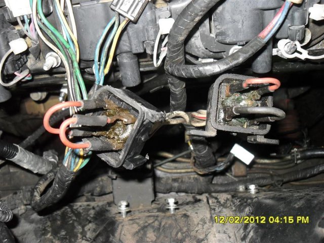

FreddyZ78 Posted April 8, 2013 Share Posted April 8, 2013 I just bought a 78 280z 5 speed and the P.O. said he used it as a daily driver until it stopped turning on. I bought it for $700. When I tried to start it with a good battery it wouldn't turn over. My brother messed with these two blue wires in the picture and it turned on. I'm sure these aren't supposed to be there and it looks like there used to be something next to it. Can anyone tell me what was there before? And what I can do to get it started? I used some starter fluid and it turned on for a second. Quote Link to comment Share on other sites More sharing options...
FreddyZ78 Posted April 8, 2013 Author Share Posted April 8, 2013 These are the wires my brother was moving around that got it to start Quote Link to comment Share on other sites More sharing options...
Domzs Posted April 8, 2013 Share Posted April 8, 2013 (edited) Fusible links . But those are just wires . Should have two boxes look like these . Edited April 8, 2013 by Domzs Quote Link to comment Share on other sites More sharing options...

NewZed Posted April 8, 2013 Share Posted April 8, 2013 Here's a good start. You're right, there used to be something next to that link holder. Probably worth your while to figure out what the PO did to those wires. Quote Link to comment Share on other sites More sharing options...
