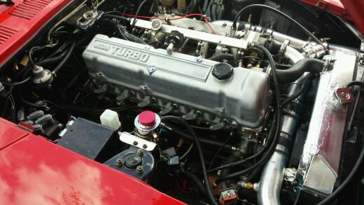

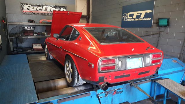

98blackbell Posted November 29, 2015 Share Posted November 29, 2015 (edited) Dyno time, not what we expected. Edited November 29, 2015 by 98blackbell Quote Link to comment Share on other sites More sharing options...
harlest Posted November 30, 2015 Share Posted November 30, 2015 No dyno sheet? Give us something Quote Link to comment Share on other sites More sharing options...
tooquick260 Posted November 30, 2015 Author Share Posted November 30, 2015 (edited) Here you go. Max hp 224 at 4800rpm, max tq 254 at 4400. Max boost at 3800 rpm 18 lbs but would fall quickly to 11 lbs boost by 5500 rpm. Typical stock turbo issue of internal waste gate spring not holding above 11 lbs. Dad had car at shop during dyno pulls as I was called into work. Had 28 pulls getting tuning for driveability and power. Set with conservative tune. We pulled 280hp, and 310tq last year. But we blew that up before Z nationals. I will be changing the turbo soon as well as the exhaust. Edited November 30, 2015 by tooquick260 Quote Link to comment Share on other sites More sharing options...
harlest Posted November 30, 2015 Share Posted November 30, 2015 Thanks for sharing that! I think that's a respectable power for a Z. The z feels so perfect when the power matches the handling. Quote Link to comment Share on other sites More sharing options...
NewZed Posted November 30, 2015 Share Posted November 30, 2015 On 11/30/2015 at 4:47 PM, tooquick260 said: No torque-HP data plot cross at 5250 RPM? Those curves seem really smooth and oddly shaped also. Quote Link to comment Share on other sites More sharing options...
98blackbell Posted November 30, 2015 Share Posted November 30, 2015 Boost at 5200 rpm is almost down to 11lbs. I will see if tooquick can post the full run with info as a dat file Quote Link to comment Share on other sites More sharing options...

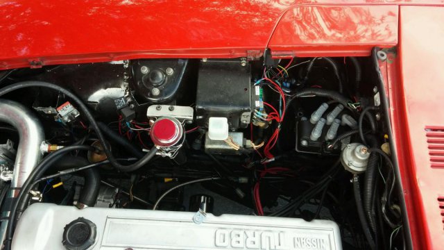

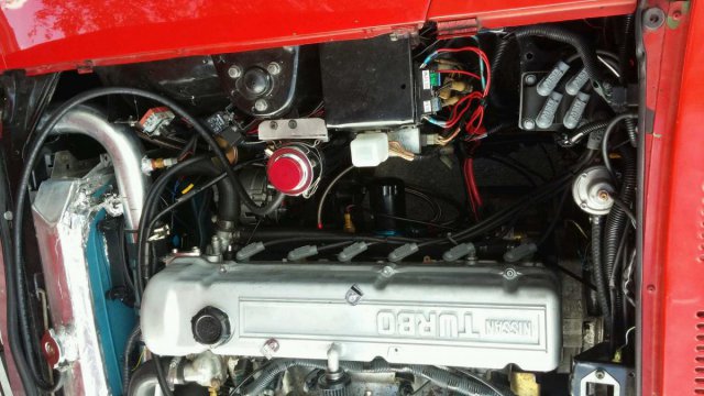

98blackbell Posted December 6, 2015 Share Posted December 6, 2015 Son cleaned up some of the wiring. First stage more to come. Quote Link to comment Share on other sites More sharing options...

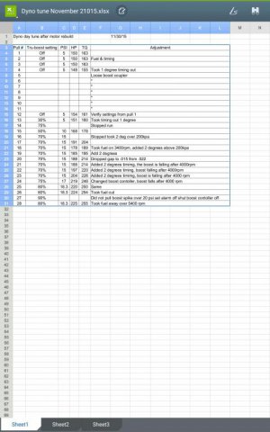

tooquick260 Posted December 7, 2015 Author Share Posted December 7, 2015 Here is the spread sheet from the dyno tune we did. I will load the data log run from the best run and copies of the final setups Quote Link to comment Share on other sites More sharing options...

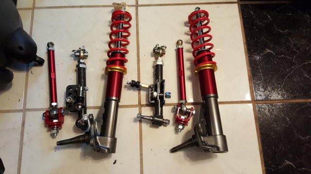

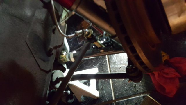

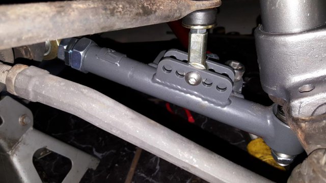

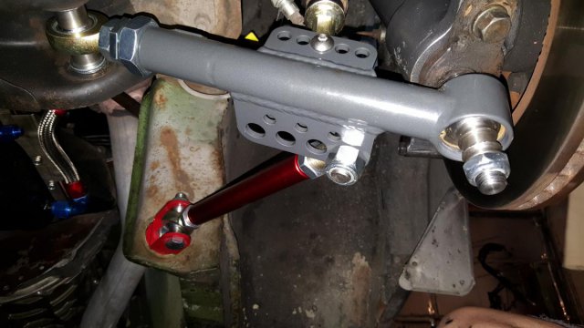

98blackbell Posted December 25, 2015 Share Posted December 25, 2015 Got the TTT3 coilovers and lower control arms with tc rods done. Quote Link to comment Share on other sites More sharing options...

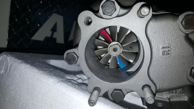

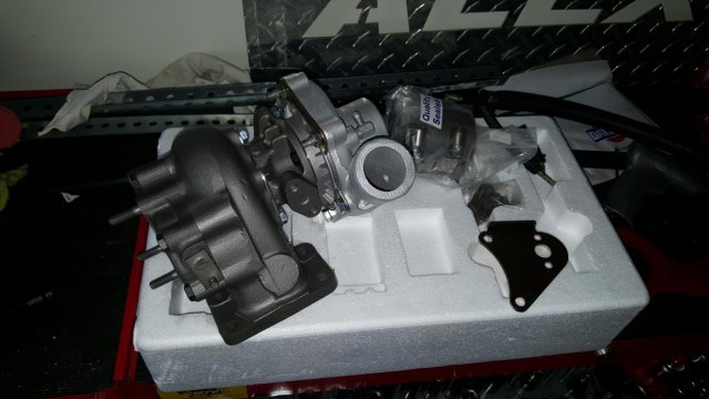

98blackbell Posted April 12, 2016 Share Posted April 12, 2016 Newhy rebuilt turbo on the way. Quote Link to comment Share on other sites More sharing options...
98blackbell Posted April 26, 2016 Share Posted April 26, 2016 New Snail! Hope we can hold boost without spiking. Quote Link to comment Share on other sites More sharing options...

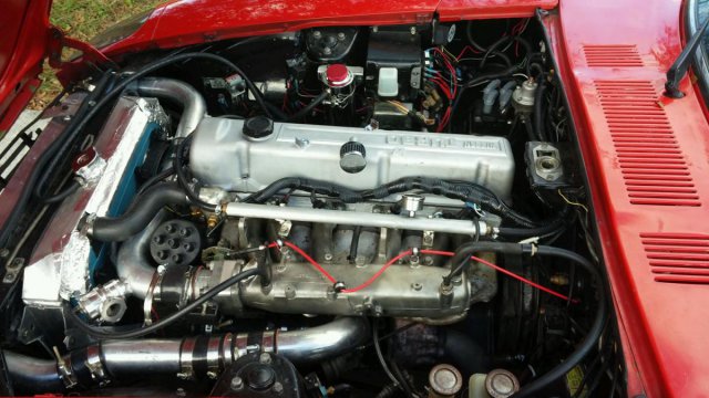

98blackbell Posted October 26, 2016 Share Posted October 26, 2016 Onto next mods. We are unhappy with the fuel system;tank, lines, pump Currently using the stock metal lines for supply and return. Msd2225 fuel pump. We are having fuel starvation on low fuel level and vacuum issues from poor venting. New plan is to remove fuel tank, remove spare tie wheel well and mount a fuel cell. Run -8 AN lines and fittings. Canister fuel filter. New fuel rail and fuel regulator. Run -8 fuel lines for supply and return. Just to add more work we are removing the 38mm tial blow off and adding a turbo smart blow off valve. Adding a hybrid t3/t4 turbo. Updating the exhaust, moving the oil cooler from between the radiator and inter cooler. Process and pictures are coming. Quote Link to comment Share on other sites More sharing options...
98blackbell Posted November 28, 2016 Share Posted November 28, 2016 Some work done. Quote Link to comment Share on other sites More sharing options...
tooquick260 Posted December 5, 2016 Author Share Posted December 5, 2016 (edited) So we finished the turbo install, new blow off valve, new fuel system(fuel cell, fuel pump, fuel filter, fuel rail, fuel regulator) new intake(cold air in front of the radiator), new Odyssey pc860 battery relocated in storage bin behind passenger seat and replaced the 96 pass oil cooler with a 10 pass smaller one. Yahoo! We flushed the fuel system to get the possible junk out of the lines and proceeded to check pressure of the fuel system. Dang plug in the fuel regulator leaked. So had to find one -6 fitting. Found one at Pep Boys believe it or not. So time permitting fire her up this week, I want to rally cross race it Saturday in Macon Ga. Hoping for 300+ hp and better driverability. Edited December 5, 2016 by tooquick260 Quote Link to comment Share on other sites More sharing options...
