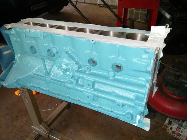

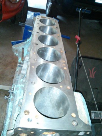

PapaSmurf Posted June 7, 2013 Author Share Posted June 7, 2013 (edited) I removed the freeze plugs and found large rust "flowers" after the vinegar so I chisseled and scraped them all out and took it to the machinist to deck the block. He put it in the wash machine which is basically an actuated pressure washer and that got most of the remainder out but I can still stick a finger in and brush out rust. Oh well it will flow now at least I'll just have to change the coolant a few times during break in.Freshly machined parts are so sexyThis is why you always use the proper mixture of coolant I think someone filled it with saltwater and it sat in the yard for 20 years rotting. Sooo much rust. *edit and paint Edited June 7, 2013 by PapaSmurf Quote Link to comment Share on other sites More sharing options...

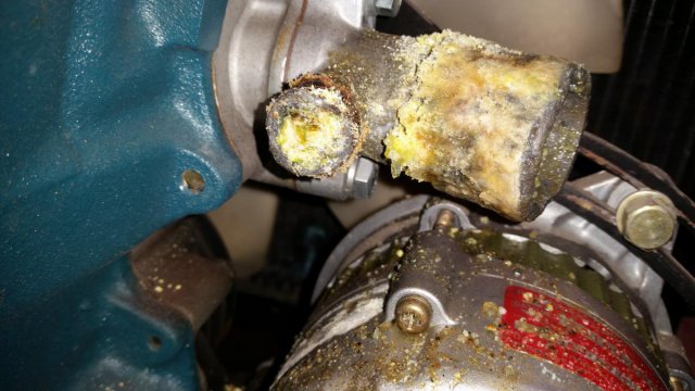

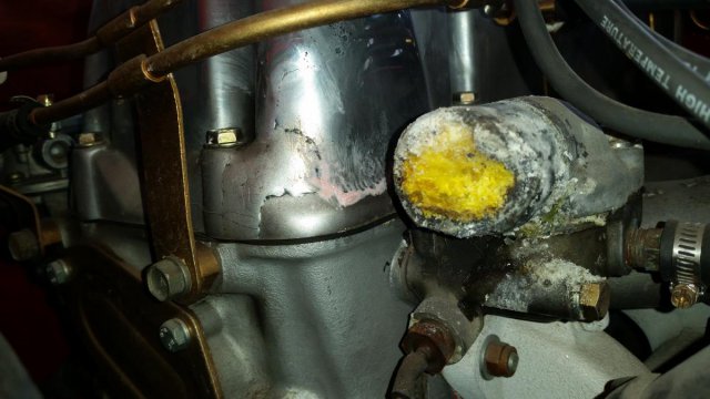

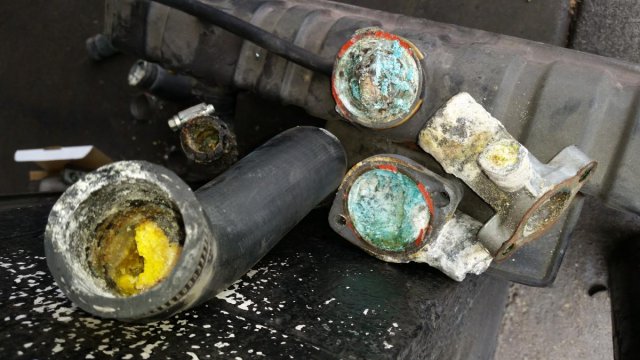

OperationZ Posted June 6, 2015 Share Posted June 6, 2015 (edited) After working on Z's for 43 years, this is the WORST cooling system I've ever seen. Super calcium buildup! on a very clean series 1 240Z a customer brought in. Check these pics: Edited June 6, 2015 by OperationZ Quote Link to comment Share on other sites More sharing options...
