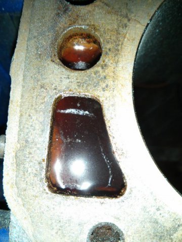

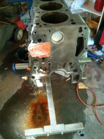

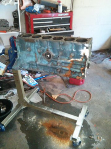

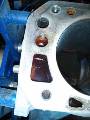

So I finally figured out why I've been having so many issues with this junkyard f54 block. I got it torn all the way down and on the engine stand, then I skimmed off all gasket material and removed as much paint as I could. The plan is to get it into the machinist as clean as possible so he can get it even cleaner in the tank. While I was brushing off the paint I peered into the front coolant passage and noticed something interesting - rust stalagmites/stalactites the passages were almost blocked. This lines up with the state of the water pump pretty much rotten. I also pulled out what appeared to be a chunk of a wire brush from the coolant loop in the head going to the heater core! This is the kind of thing that might be blowing my head gaskets and causing some overheating :icon56: so I made a block off plate for the front coolant passage going to the water pump and I've filled the water jackets with vinegar.
block off plate made with sheet metal and permatex

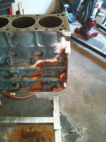

the vinegar ate through the permatex :icon11:
I have some cleanup work ahead of me.
So has anyone tried this? I hear it works and it's safer than muriatic acid just slower. If it works I'll be doing this with my heater core as well I'm sure it's full of rust. I need to replace or tank the radiator before it all goes back together too. It's been sitting like this for a day now I can still see the vinegar bubbling and popping out the coolant jackets presumably disolving rust. If this works I've just found an awesome new tool

Well the rust is gone vinegar worked! I took my crankshaft in to get it polished and balanced today and I was turned away he said it was too long (gigity) so I took it to a different guy. The worst sort of machinist the profiteer. Guy quoted me 100dollars to polish and measure it. He said it would be 70 bucks just to polish without measuring and he was telling me that he could balance it but its not like balancing a tire its involved lol he started trying to prepare me for a huge markup and I just turned him down. I think I still got screwed 100 bucks for a polish? Seems unreasonable. Im pretty sure I can't afford a good running engine
I made a block off plate for the water pump and filled a crusty l28 block with the clr stuff you get at hardware stores.The soak time was 3 days.All rust was removed and results looks like a good old school hot tank job-bare grey metal.Stuff was $26/gallon though.I was %100 happy with the results.Rinsed very well with water when done.I would try vinegar becuse its cheaper bit I am kind of skeptical about it beating the clr.
The vinegar takes longer but at 2 bucks a gallon it's a great option if you're waiting for money/parts and she's apart. it took 2 cycles to remove the bulk of the rust so it cost me $4 dollars instead of $100 for tanking or $30 for clr. that's money saved to spend in other places.
