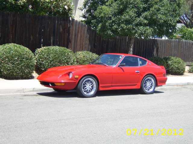

I installed the eibach pro spring kit on my 240.  I had read all the threads about installing them incorrectly with the fronts in back etc.  After installing them correctly the front definitely was sitting higher.  I took them out and reversed them to see if it was my fault. It was worse.  I put them back and then measured the difference in the wheel to wheel-well gaps.  It was about 1 1/4" bigger in the front on my car.  I installed the progressive portion of the springs up.  When it was sitting the top 3 progressive coils were completely compressed. I know people say that you shouldn't cut progressive springs, but seeing as they were completely compressed I cut the top 2 dead coils off one at a time. My thought was that a normal ride height they would just act as a spacer. Cutting the springs was easy with a cut off wheel. The ride height is even now. Here is a picture after cutting the springs.
Rob
Thanks for that info Rob, your Z looks great. I almost feel it defeats the purpose of getting new springs to cut them though. Maybe I should just cut my stocks? I'm a little disappointed that the eibachs run uneven like that. I was hoping the reports of uneven ride height were due to the incorrect installation.

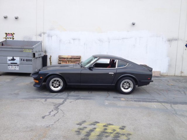

Thought I'd add a pic of my Z just for reference. After getting the new wheels with a slightly lower diameter tire, the wheel gap just kills me.
What wheel and tire size are you running? I really like the shakotans, but I may have to move up to 16's just to get the tire size I want (225/50/16). That would be equal to the 195/70/14 I had on my old wheels.
Edited by 415DZ
I agree with John C, you car looks good as is. It doesn't sit the way mine did before I changed the springs.  My car was extremely nose up. I thought my original rear springs were sagging and something was wrong and my reason for new springs.  I really like the shakotans on your car too.  What size tire is mounted on them? The diameter looks smaller than stock.  My car has 225/50/16's.  I think if the overall diameter of your current tire is smaller you could just get a bigger tire and it would fill the gap some.  225/50/16's have a diameter of 24.9", which is really close to the original diameter.  For 15's I would look for 225/55/15 (24.8), 245/50/15 (24.8), 215/60/15 (25.2) or 235/50/15 (24.2).

I'm running staggered 205/55/15 in the front and 225/50/15 in the rear. The diameter is indeed smaller than stock and the increased wheel gap bugs me. I'm actually ok with the ride height as is, but the disappointing thing is I can't find 225/55/15. I don't think anyone makes them. This is originally why I was considering 16's strictly so I could run a 225 tire that is very close to the stock diameter. I didn't really see any 16's I liked that we're easily attainable. I guess I kind of like the Xxr 002's. I wouldn't mind a set of 3 piece panasports tho haha.
I think 205/60/15 is available which is same diameter as stock, but I'd really prefer a wider tire. I think I'm going to pass on the lowering springs and try to find proper tires or move up to 16's.

Your car looks perfect. The bottom of the car looks parallel to the ground. The front fender wheel arch is shaped differently than the rear to allow clearance for the front tires to steer. This is probably tricking your eye into thinking the front end is higher. Try measuring from the rocker to the ground at the front and back.
