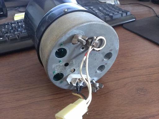

OZZ240 Posted May 20, 2013 Share Posted May 20, 2013 There are two wing nuts holding each gauge in place up in behind the gauge, you need to lay on your back under your steering wheel and look up at the back of the gauge a flash light will help you see the wing nuts. I found laying on my back on top of the seat with my legs on the head rest got me in a pretty good position, also will need long nose pliers to help you undo the wing nuts Quote Link to comment Share on other sites More sharing options...
OZZ240 Posted May 20, 2013 Share Posted May 20, 2013 Just bit more info for you, My 71 240Z does not have any screws at the front holding the bezel/gauges in this may be true for 72 and up. I loosen off the wing nuts at the back and by pushing it evenly from the back it will slide out towards the steering wheel mine took a bit of pushing as was a tight fit in the dash but once it started moving it came out pretty easily, you may need to take the steering wheel off if you still have the factory wheel fitted to get the bezel and gauge out in one piece, I also have a dash cap on my Z but this did not cause me any problems just take your time and should come out ok. Quote Link to comment Share on other sites More sharing options...
415DZ Posted May 20, 2013 Author Share Posted May 20, 2013 On 5/20/2013 at 9:35 AM, OZZ240 said: Just bit more info for you, My 71 240Z does not have any screws at the front holding the bezel/gauges in this may be true for 72 and up. I loosen off the wing nuts at the back and by pushing it evenly from the back it will slide out towards the steering wheel mine took a bit of pushing as was a tight fit in the dash but once it started moving it came out pretty easily, you may need to take the steering wheel off if you still have the factory wheel fitted to get the bezel and gauge out in one piece, I also have a dash cap on my Z but this did not cause me any problems just take your time and should come out ok. Ok so there is no screws, I thought I was blind or going crazy. Just remove the wing nuts and I can push it out through the front. I guess I'll give it a shot. So the housing, and lens are all together and will come out in one piece? Thanks everyone for your help! Quote Link to comment Share on other sites More sharing options...
cgsheen Posted May 20, 2013 Share Posted May 20, 2013 (edited) Yup, it's all one piece. And, like you said, no screw for the early Speedo or Tach (that came later), 2 wing nuts on the backside, unhook the bulbs, wiring connector(s), and cable. They normally slide out with relative ease. With a full face dash cap you'll have a little trouble getting the closest part of the gauge bezel through the hole in the cap... Edited May 20, 2013 by cgsheen Quote Link to comment Share on other sites More sharing options...
