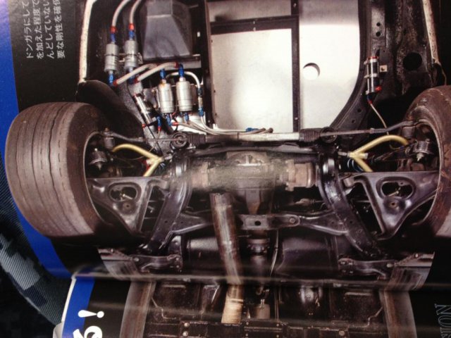

Purepontiackid on ratsun is currently fitting one. It took him a lot of measuring to get the arm lengths right. He had to chop them shorter

and remember PPK did it to SLAM the S130 (closer to Z31 & S13) to the ground.... Not sure How it'll come up on performance S30's or whatever it is that your trying to build.

He hasn't done it yet, he is still mocking it up. He is doing this for the reason outlined below.
The point is to have correction in all directions for rear camber/caster/toe. When you extremely lower a ZX (more than say 2 inches, but even 2 inches) will cause massive toe in and negative camber. This can not be taken out no mater what you do with stock components.
PPK is doing this so that he can run correct wheel geometry while being as low as he is. Even myself, lowered maybe 2 inches or a little more has a problem with some toe and camber.
An old school way to combat this is to measure how much correction you need (so you already know how low you want your ZX) and you cut and weld on heim joints in an offset pattern. This only fixes the problem and does not allow you to really change anything anymore. If you raised your car, well you just messed up the angles again.
On top of this, the rear subframe is 4 points instead of 2. It really stiffens the chassis up more at really a minimal amount of weight gain. This would be the next step in my suspension, if I get any kind of competitive and become a fab master any time soon lol.

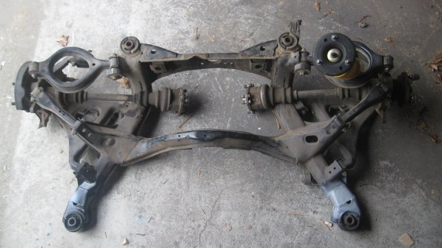

It is slow going as I just don't have enough time to work on my baby.  I started with an s13 conversion, but changed course after a complete s14 suspension fell in my lap.  I'm probably about 1/2 through.  Still need to work out the parking brake, alignment, and a few other minor issues.
I like the way that Takkun welded in  new suspension mounting points for the rear of his s130, but not the major cutting and welding required to make the s13 shocks sit at the correct angle.  In the end, I decided to modify the s14 subframe to fit the s130 chassis because I wanted to fit it as high up as possible under the car to keep the roll center as close to the cg as possible.  In fact I will need to do a bit of hammering on the underside of the tool bins to clearance the subframe from the chassis.
The s14 suspesion actually solves a few problems like the rear shock angles and I like the wider track (for modern wheels).  The donor suspension I used is the 4-lug version, but 5-lug models are more common and possibly more desireable for z32 brake conversions and such.
My modded s13 subframe
