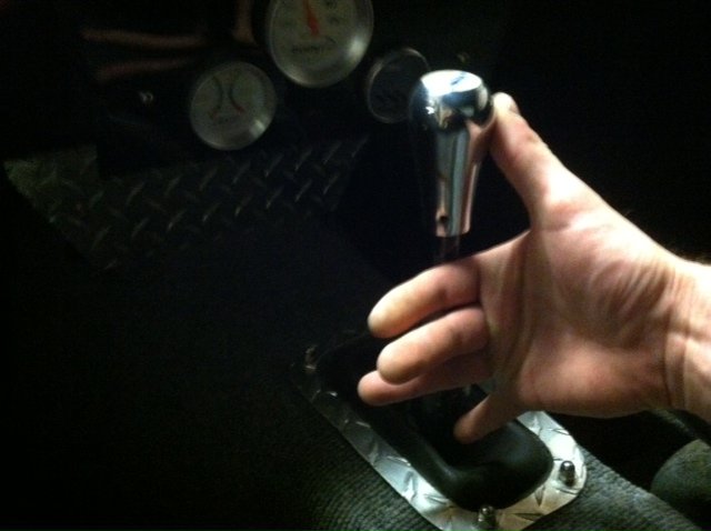

YES!!! test drive completed and the Z runs great!! I like the lower 5th gear compared to my original 5 speed too.
Now to fab a new shifter boot as the original Z boot doesn't fit so well over the 240sx shifter...........
I drove the Z to work for the freeway shake down test. All I can say is WOW!! The 240sx trans swap is the best considering I have the 3.90 rear diff. 2500rpm @ 60mph, thats down from 3100 rpm.
The stock sx shifter has to go. Its too tall for my Z as I dont have the center console, so the shifter knob sits about 8 inches high, and its a bit squishy feeling. It seems to be a 2 piece unit with the upper half connected to the lower half by some type of big rubber bushing/vibration dampening setup. I did find some after market short shifters with out that integral bushing. I also need to fab a new shifter boot, my original unit ripped on me and I get hot trans tunnel air blowing me in the face in 2nd and 4th gear ;-(
I highly recommend this trans swap!! The gears are butter smoothe and no more grinding going into reverse!

I did purchase the short shifter, however, the sealant that was used during re-assembly is NOT willing to let me remove the original shifter plate from the trans.... bummer!!!!!!!!!!!!
