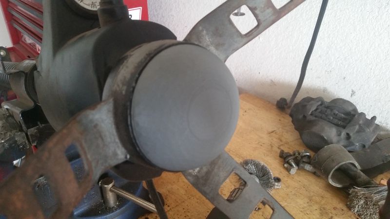

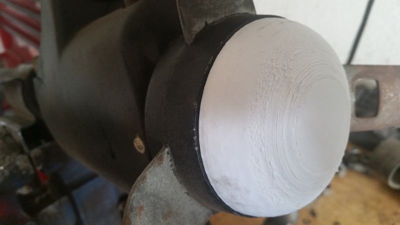

Jay Gadsby Posted May 15, 2015 Share Posted May 15, 2015 PROGRESS!! Ok, so we got it printed out, there are a couple different ways to do it. One was a supported method upside down, which is represented by the white one. The area where the supports were is a bit rough. WIth some sanding, I am sure it would smooth out. The gray one is an unsupported version which comes out much smoother. They were printed with ABS that he had on hand. Both of them fit very well into the steering wheel. They pop in and take a little finesse to get back out which I am sure is what is wanted. The prototype works though. Quote Link to comment Share on other sites More sharing options...
Dkyle Posted May 16, 2015 Share Posted May 16, 2015 looks good.. i see that the gray one would be much less sanding. i'll take it. how much? i trust ABS is paintable? you could play around with the sketch a bit and try making a "quarter" size inset about 2mm deep or so that an emblem of some sort could be glued in. But.. i don't have anything now.. i would be happy with what you got. Maybe later you could make a custom one that an emblem could snap in. Quote Link to comment Share on other sites More sharing options...

Jay Gadsby Posted May 16, 2015 Share Posted May 16, 2015 (edited) I am actually going to try and streamline it some more, including the emblem relief. I will see what I can do. I am pretty decent with solid modeling, just need to keep it within the limits of the printer. ABS is just plastic, I use Bulldog adhesion promoter on plastic prior to priming and have never had an issue Painting. Edited May 16, 2015 by Jay_Gadsby Quote Link to comment Share on other sites More sharing options...
Austenp405 Posted May 19, 2015 Share Posted May 19, 2015 (edited) In my experience, sanding on printed ABS doesn't work terribly well, it just chews it up, especially when the part is intricate. I have been getting amazing results with acetone vapor baths. Edited May 19, 2015 by Austenp405 Quote Link to comment Share on other sites More sharing options...
Jay Gadsby Posted May 19, 2015 Share Posted May 19, 2015 Yeah, we had talked about that. Have yet to try it out though. Quote Link to comment Share on other sites More sharing options...
