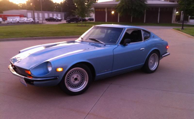

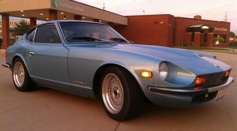

I have 16x8's, +15 without spacers and have no rubbing anywhere. For reference I'm on coils and have rolled fenders. The rolled fenders were not needed for this combo, but coils for sure due to the to the spring perch. Tires are 215/50-16. It's got a nice tuck as well.
Edited by str8pipez
