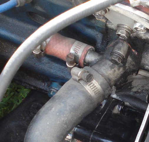

beermanpete Posted July 1, 2013 Share Posted July 1, 2013 We used a short piece of heater hose, a plug, and hose clamps. See the attached photo. Not the most elegant solution but it has been reliable for several years. Threading the housing will not work well. I think the next level up is to cut off the nipple and weld it closed. Quote Link to comment Share on other sites More sharing options...

josh817 Posted July 2, 2013 Share Posted July 2, 2013 (edited) The rubber cap may be best so you can keep the thermostat bypass line on the pump intake. Should have the big hose from the radiator, big hose from the heater core, and then a little hose from under the thermostat (as shown in the ebay auction). Although, I am unaware why some intakes only have a place for a heater core and a radiator, without the thermostat bypass, as shown on post #14 by Beermanpete. Perhaps some engine blocks had an internal bypass and some didn't? I don't know.Better go read all 10 million pages of the coolant FAQ on this board.For what its worth, I just looped the back of the head around to the intake of the water pump, without the heater core. I didn't run the thermostat bypass. That is apparently the wrong way to do it, and I wouldn't do it that way again. Regardless, the motor ran fine as a daily driver for years. Edited July 2, 2013 by josh817 Quote Link to comment Share on other sites More sharing options...
