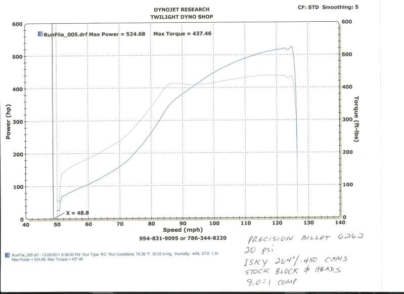

78zstyle Posted September 8, 2013 Share Posted September 8, 2013 I'd have to disagree. Put a proper modern turbo on a VG30E(T) or VG33E and you will see plenty of power. A proper turbo and aftermarket cams and valve springs and you can see a nice improvement to the powerband and plenty of power. My brothers Z is still on a bone stock bottom end with a 1/4 of a million miles. He's replaced the cams and is running a billet PT6262 turbo, front facing tubular manifolds, NISTUNE and E85. Were expecting a solid 500+WHP and similar torque on high boost...already been for a few pulls and it pulls good . SHORT vid i took of a quick 2nd gear pull: http://www.youtube.com/watch?v=X93SP7586mg&feature=em-upload_owner ...thats 500 HP? Hm... Quote Link to comment Share on other sites More sharing options...
78zstyle Posted September 8, 2013 Share Posted September 8, 2013 This is 421 WHP? I'm a little confused. Quote Link to comment Share on other sites More sharing options...

FlawleZ Posted September 11, 2013 Share Posted September 11, 2013 (edited) I don't mean to insult anyone personally, but this thread is absolutely RAMPANT with IGNORANCE. It's simply appalling to me that someone could consider themselves "obsessed" yet know so little and assume so much. Let me educate you: Back in 2008 I made 364 RWHP and 480 RWTQ on an internally bone stock VG30ET. The motor at the time had ~200K miles. This is a 3.0 with 7.8:1 compression. I used a small 50 Trim T3/T4 @ 24 lbs hence the large amount of torque. You can see my dyno here: http://web.archive.org/web/20110717195602/http://www.vg30et.com/members/mattwiedower.html If you look here: http://web.archive.org/web/20120220074716/http://www.vg30et.com/members.html You'll see a number of people who have achieved over 350 RWHP on the SOHC VG30. Almost all have done this on stock OE short blocks. As you can see, several have achieved and surpassed even 450 RWHP. Almost all of these were done on old, inefficient, inferior turbos to what's available today. As of right now, I'm currently running a Precision Bill 6262 using THE SAME bottom end I made 364 rwhp back in 2008, now combined with very lightly ported heads and Schneider 274 Cams. I expect to dyno within the next ~30 days and I won't be driving off the dyno with less than 500 RWHP. Another prime example is Rick88SS who put down 525 RWHP on a bone stock NA VG30E simply with a 6262 Turbo and Isky cams. His dyno is here: There are a number of people who have FAR surpassed Rick's numbers, I only posted this to show how easy and simple it was to break 500 RWHP. I can post dynos and cars of up to 700+ RWHP on VG30E SOHC Z31's. The biggest factor in determining the desired power goals will ALWAYS be exactly which turbo you use. Using old, inefficient, and often times undersized turbos will always limit the power regardless of how well any engine or set of heads flow. *EDIT* Please excuse the links, the main site has been down for a long time and looks like Web Archive is recently down. I'll update with my own hosted images and information. Edited September 11, 2013 by FlawleZ Quote Link to comment Share on other sites More sharing options...
FlawleZ Posted September 11, 2013 Share Posted September 11, 2013 Here's a link to my dynograph from 2008: Oh and my car is the car RedBeauty84zx posted. Quote Link to comment Share on other sites More sharing options...
BLOZ UP Posted September 11, 2013 Share Posted September 11, 2013 Ha, Lethal Performance. I used to work there. They should know better than to print out a graph with unaligned axis. The point of this thread, I think, isn't weather you can break 300 or 400hp, it's whether you can get a nice, non-peaky, torque curve that spans 3000 RPM. If you convert your MPH to RPM, does you graph show that? Quote Link to comment Share on other sites More sharing options...

260DET Posted September 13, 2013 Author Share Posted September 13, 2013 This is 421 WHP? I'm a little confused. That's with the VG30DET engine, not the VG33ET donk. Quote Link to comment Share on other sites More sharing options...
