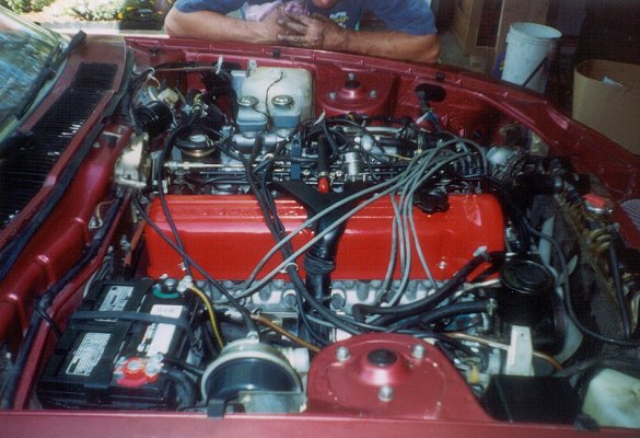

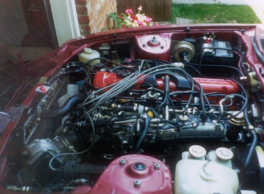

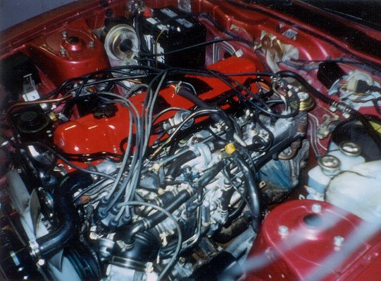

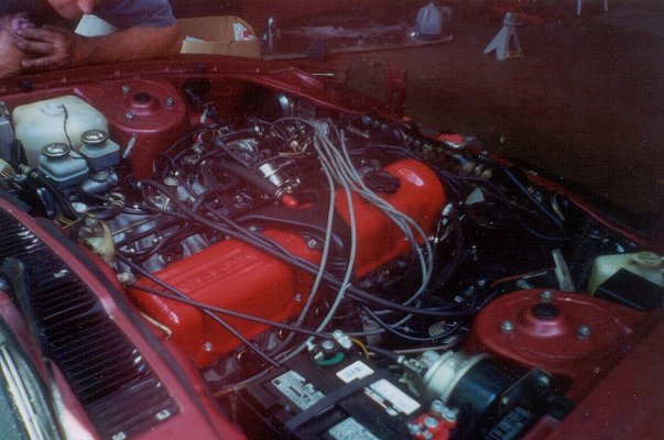

Hopefully when I get this motor dialed in it won't be too much of a temp solution. I really like the upped compression. Definatly more "punchy" in the lower rpm's. Today i'm gonna try retarding the timing a bit and use that resistor thing you mentioned. Here's a couple engine pics:
I know, I need better camera.

While you are changing stuff, I would swap out that intake manifold for one one that looks like a turbo intake manifold. I had a manifold just like your on my turbo engine, and when I got rid of it and put on a turbo one, I picked up boost. Something about that taper in the back.
