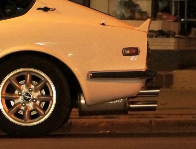

As far as fume avoidance goes:  When I redid my exhaust, I had the tailpipes extend an inch beyond the rear bumper.  This seems to have allowed the exhaust fumes to exit far enough off the body to avoid them being sucked forward.  I have only noticed any fumes one or two times since this was done, and both times where in heavy traffic, and I drive my 240Z a LOT.

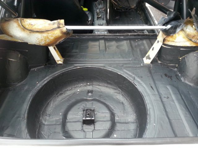

POR-15'ing and soundproofing the interior made a big bit of difference as well, sealing any small holes that may have led into the interior.  I drove my car with the interior stripped a few times, and the fumes were borderline intolerable.
