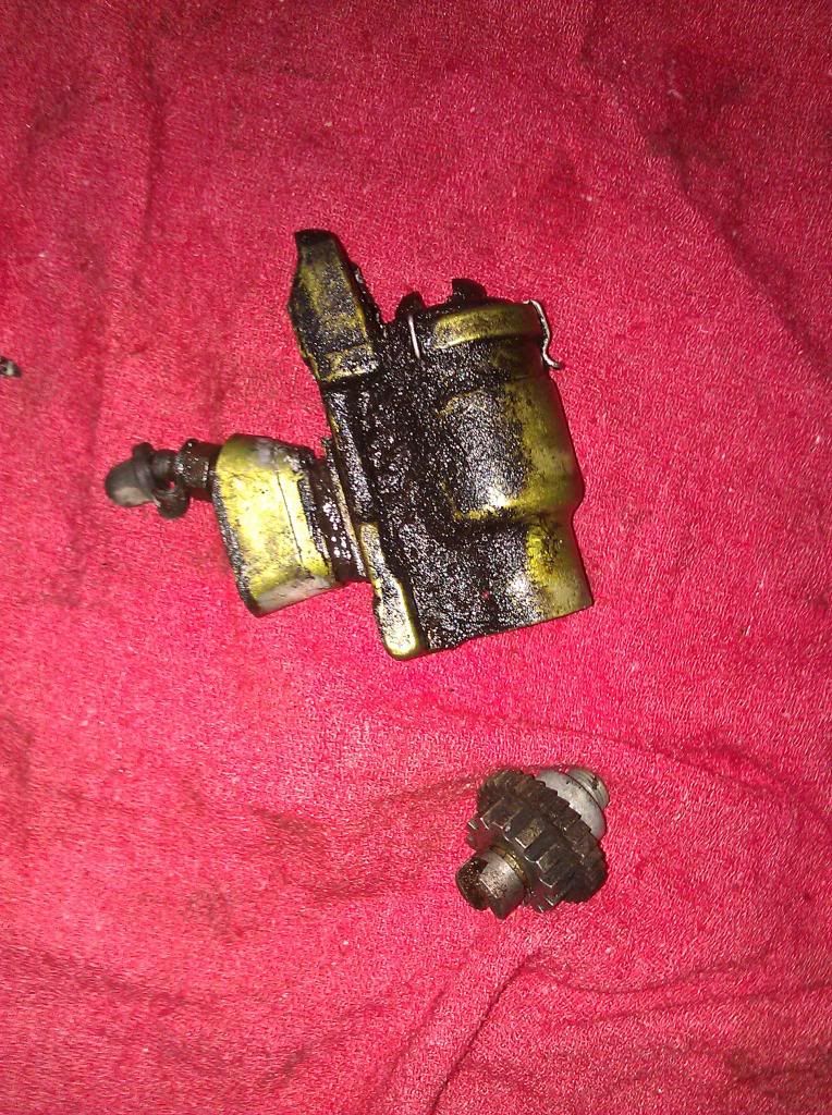

Slowpoke Posted September 21, 2013 Author Share Posted September 21, 2013 Progress today. Got the timing a set at 15 degrees advance and she runs and drives alot better. Dosen't want to stall off gas anymore. The distributor was installed properly but the lock down tab is broken off(why i couldn't find it). I locked it down with a clamp, D-town getto style, till i order a replacement. I think it'll be even better once i get the carbs synced. I was also thinking about ordering the pertronix electronic igntion kit. I looked around locally for a 280zx dizzy, but no luck + my dizzey looks like it had been rebuilt recently. Im thinking the smoking is residual coolant in random places, my neighbor asked me if i needed an fire extiguisher, haha. So im feeling pretty good about her today! Quote Link to comment Share on other sites More sharing options...

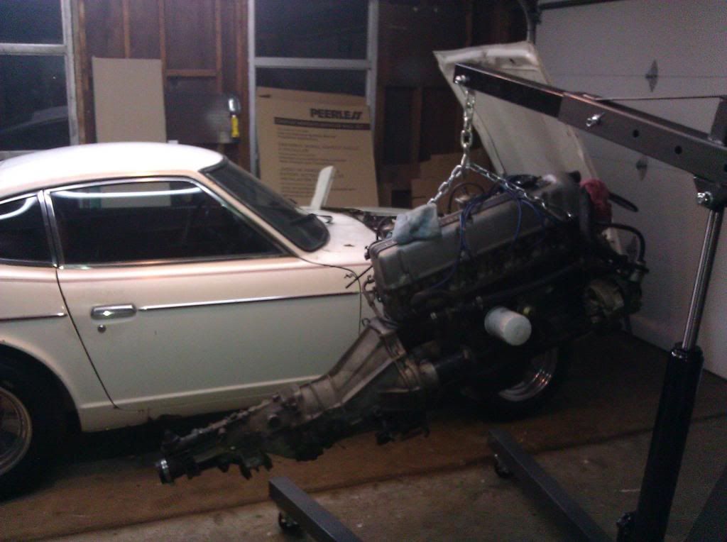

Slowpoke Posted October 6, 2013 Author Share Posted October 6, 2013 Motor Swap time! Nah, its really more like replament...Just a L24 + manual trans, but its Runs! I had found a replacment head from a nearby yard which i was going to rebuild and decided against that, as my goal is to get the car somewhat drivable before the winter. Then I decicided to change directions. I figured if i was going to replace the head completly i should just rebuil the entire engine which is not going to happen anytime before it snow around here. So i found an motor + manual trans setup for a decent price and figure i could kill a few birds at once going that way. It also Round tops, and most of the accesories for the auto to manual swap. I Drove the donar car before we pulled the motor and it ran so much smother than my car did. So i figure going this route would be quicker and cheaper than rebuilding now and finding a trans later. Hopefully we'll be running soon. Quote Link to comment Share on other sites More sharing options...
Slowpoke Posted October 10, 2013 Author Share Posted October 10, 2013 Alright! She runs and runs well! Got the "newer" engine and manual trans intalled. I also put in an electronic ignition, and it is so much smother than the old one. I think the old engine was pretty beat. Back to the brakes, drums are next. Quote Link to comment Share on other sites More sharing options...
