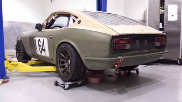

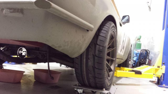

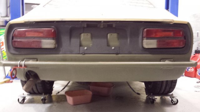

Someone gave me a swt of Infiniti  5 spoke wheels with 245/45-17s on them. They fit inside the rear fenders with TTT suspension, but haven't had an alignment yet so I don't know what will change once it's aligned. they do fit between the coilover and fender though.
