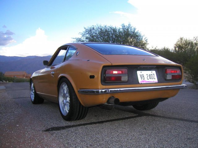

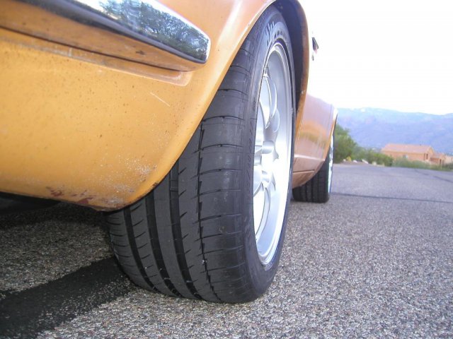

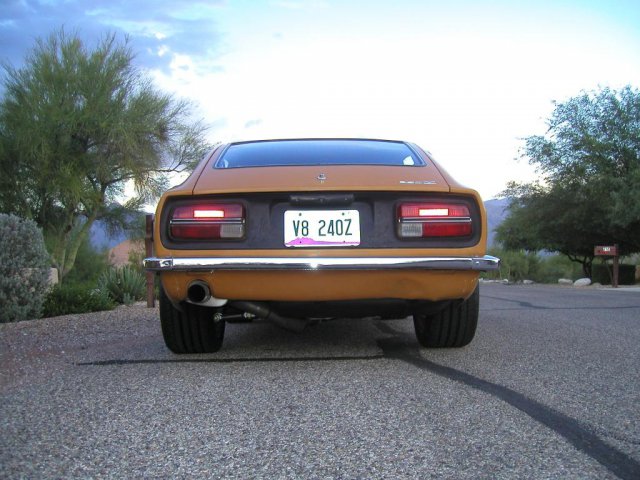

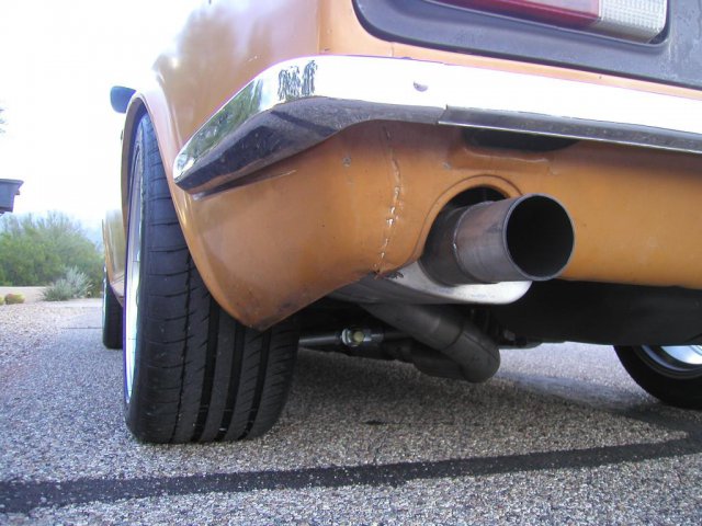

Hope this helps a bit. I run 16X8.25" wheels with 0 backspacing with 225/50/R16 tires. The tires are less than 1/8 from the springs, and (with the car dropped 1.5") rub on the un-rolled fenders. With fenders rolled it juuust clears.
