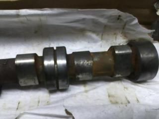

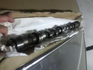

Dat260Z Posted October 21, 2013 Share Posted October 21, 2013 (edited) I recently picked up a 260z c-stamped "Nismo " camshaft. I am building a l28et and plan on bolting up my p90 head. As I read about swapping an early camshaft onto a later head i realize that I need to get a spray bar from an earlier head to lubricate the camshaft. And I can't help but wonder, is it really worth the trouble to use this cam? I can't seem to find any numbers as to how much this camshaft will benefit my turbo engine. Any help is greatly appreciated !Thanks-Brad Edited October 21, 2013 by RB26powered74zcar title Quote Link to comment Share on other sites More sharing options...

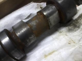

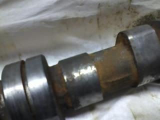

Dat260Z Posted October 23, 2013 Author Share Posted October 23, 2013 I think that's what I'm going to do. What's the going rate for a C-stamped cam? It has a little corrosion on it but nothing major (I don't think) Thoughts? Quote Link to comment Share on other sites More sharing options...

skirkland1980 Posted November 6, 2013 Share Posted November 6, 2013 I paid $40 for a core to send to delta. It was in good enough condition to run as is. I just installed a cam with a notable amount of overlap. The turbo didn't seem to care at all. In fact to boost went up with no adjustments to the wastegate. Bigger than stock turbo of coarse... Quote Link to comment Share on other sites More sharing options...
JMortensen Posted November 6, 2013 Share Posted November 6, 2013 (edited) ^^^What he said. With the surface as is, I'd send it off and have it reground. Edited November 6, 2013 by JMortensen Quote Link to comment Share on other sites More sharing options...
