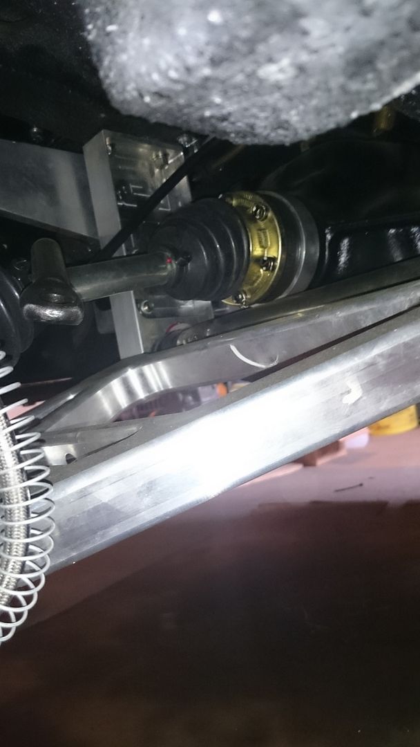

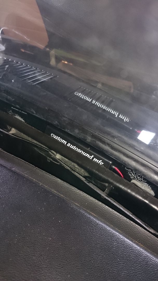

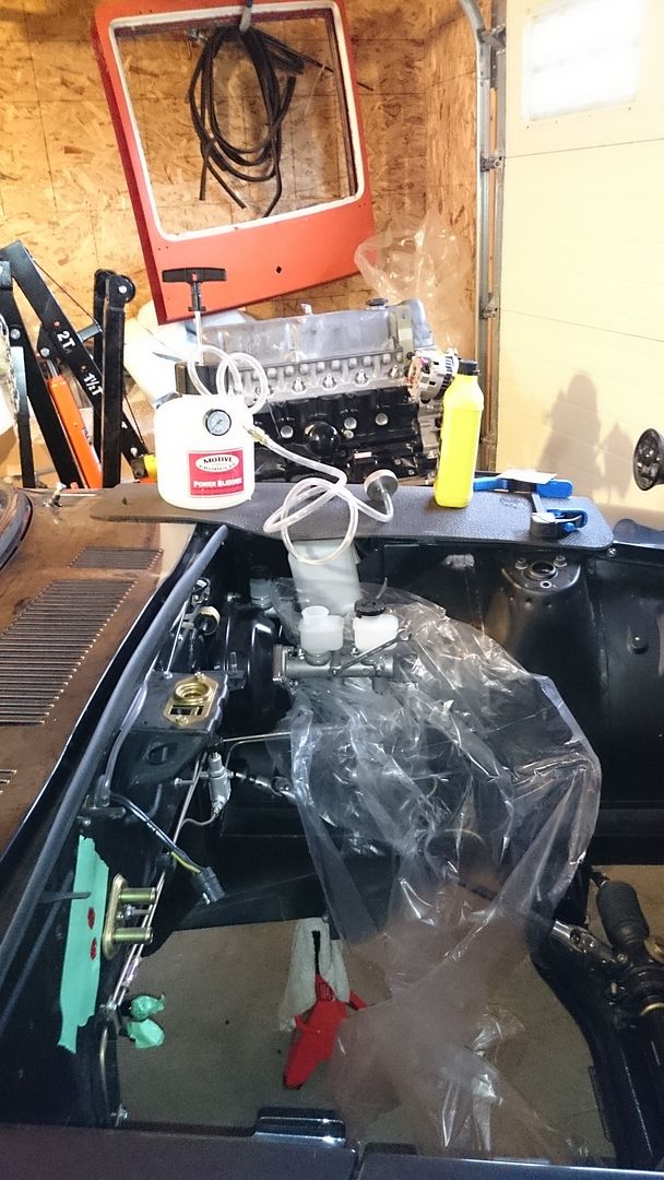

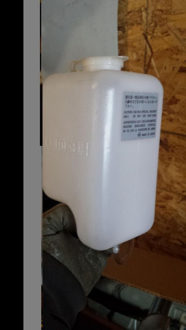

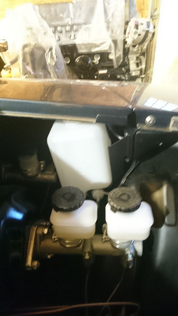

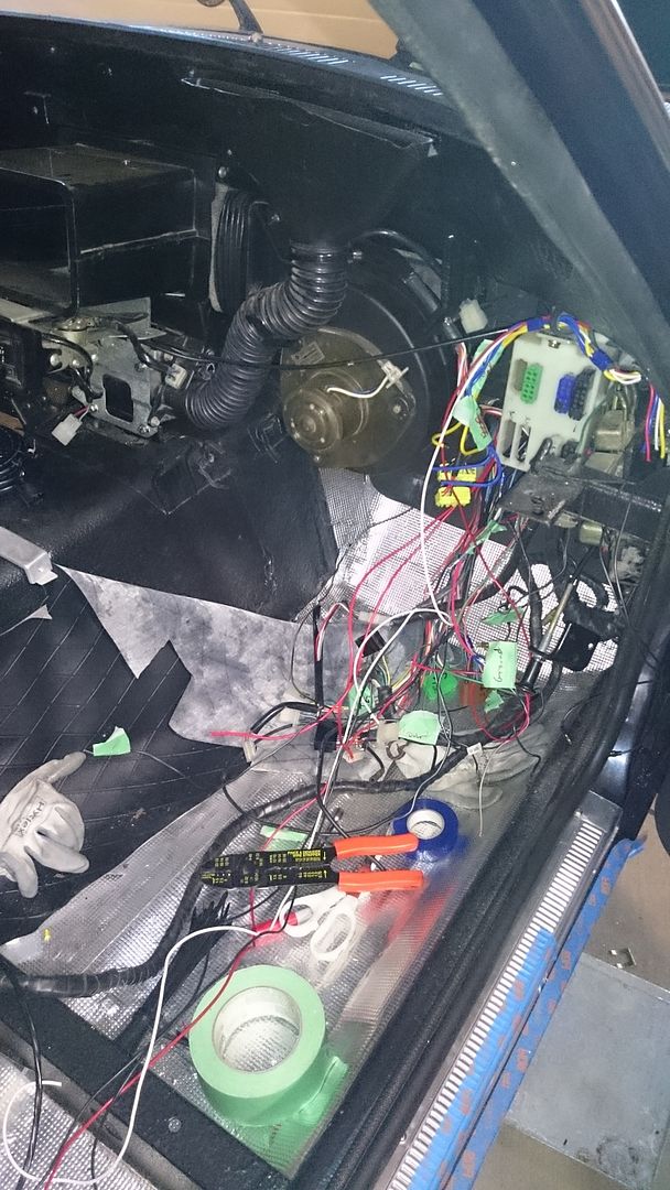

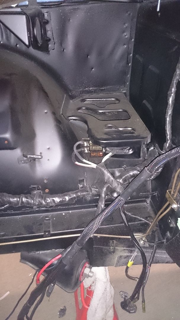

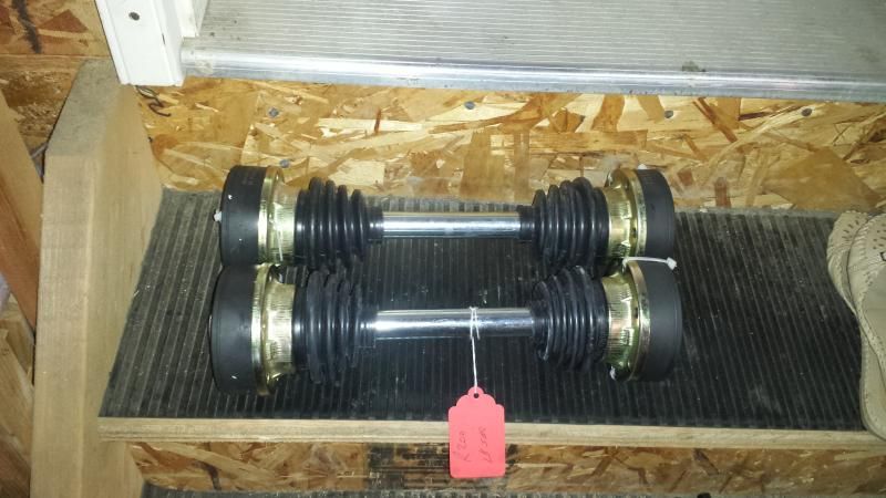

takayuki Posted May 1, 2015 Author Share Posted May 1, 2015 (edited) Back on track.... after about 1.5month hiatus. Damn vacations! lol Installed wolfcreek CV axles Bled the brakes with my motive bleeder! Awsome tool. And I'm happy to report that no fluid leaks from the brake system.. so far And the past week, I spent the entire time rewiring the car. Since I am going fuel injection, I integrated the existing harness with the new. At the same time, I painstakingly removed all unnecessary wiring (stupid interlock crap!). Upgraded fusible links with Maxi fuse. Then, relocated fuses to underneath the battery I shaved the antenna so I got this cheap Ebay hidden antenna. It works quite well actually! Brand new reproduction washer fluid tank Then I splurged with this. Truck lite 7" LED headlamps. AWSOME product. I previously had Dapper HID light kit, but I wasn't very happy with all the ballast and components it had. Too much parts. With this light, it just plugs straight into the socket. But you need to modify the wiring harness to make the light work properly. Apparently s30's light wiring is not the same as modern day wiring. The best thing about these lights is that it draws MAX 3.6amps per headlight. Very easy on your electrical system. I think at low beams it draws only 1.8amps per headlight. sticks out a little bit more than a stock headlight but not too bad. I took some terrible pictures to compare the light patten. Obviously better than stock. Low beam High beam I integrated a 5 pole relay to the engine harness to make the light work properly. This was the hardest part. Since there were no writeups, I had to figure it out myself. The other loose wires are for my electric fans, which I will finish once the radiator is in the car. I'm very happy that I didn't set off any electrical fires on the car. As matter of fact, everything works on the car! There were things that did't before. Edited May 1, 2015 by takayuki Quote Link to comment Share on other sites More sharing options...

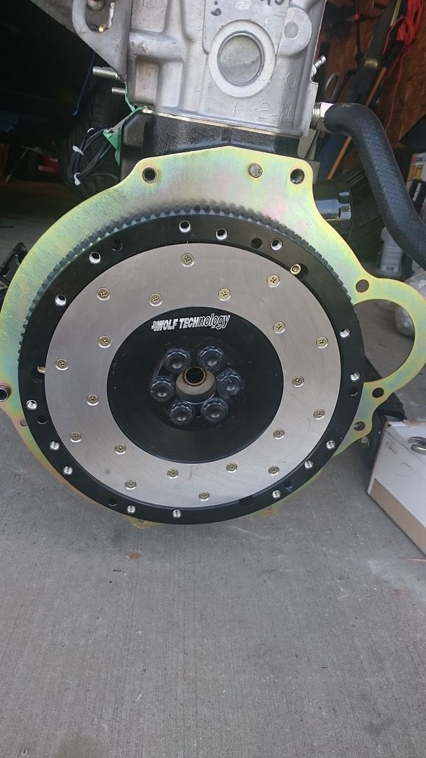

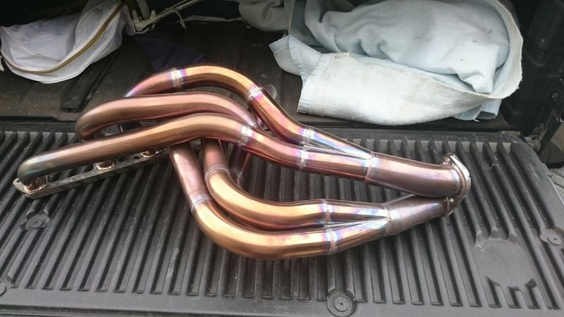

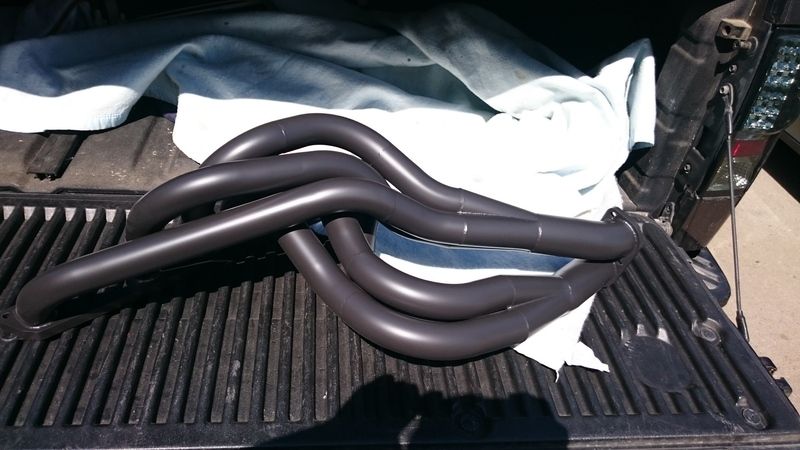

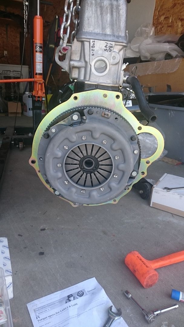

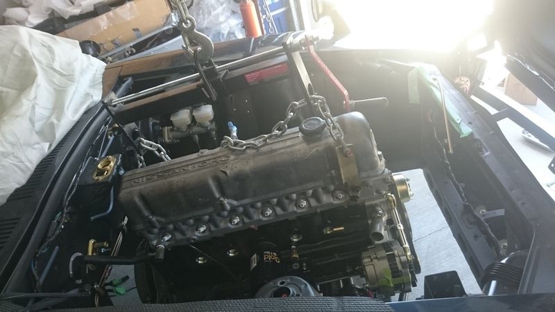

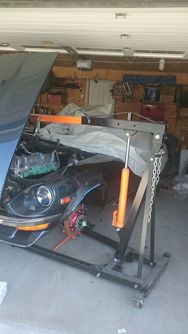

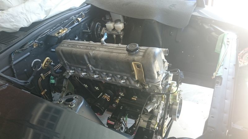

takayuki Posted May 23, 2015 Author Share Posted May 23, 2015 Prepped engine for install. Had this beauty, Kameari 45mm headers ceramic coated... such a shame. No choice because the clearance from the intake manifold to the header is next to nil. forgot to post this, I had a ron tyler diff mount, but opted for the SW motorsport front diff mount. Installed flywheel and clutch I was going to install the engine and the transmission together, but with no help available at the time, I decided to do the install by myself. Installed intake and exhaust manifolds. Also, installed 3 row aluminum rad and fan package from MSA. Mishimoto Rad hoses used. I can officially say, my steering shaft mod worked! Clears engine and exhaust manifolds! Quote Link to comment Share on other sites More sharing options...

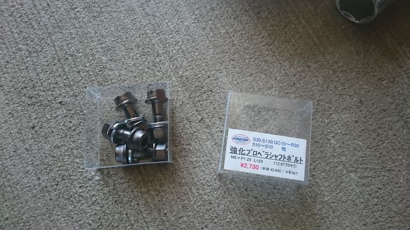

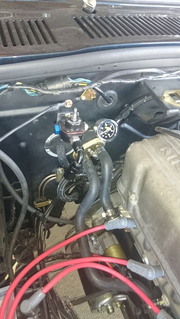

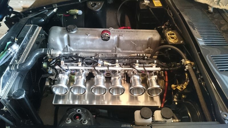

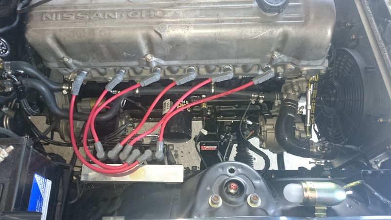

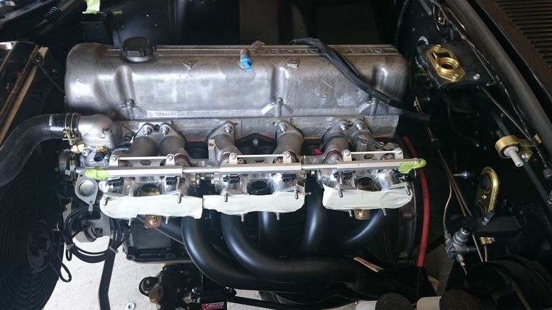

takayuki Posted June 14, 2015 Author Share Posted June 14, 2015 (edited) ^ thanks guys! onto some more updates, Installed stock driveshaft for now. Will upgrade later...funds are starting to dry up! However, I used some Kameari chromoly drive shaft bolts. Hooked up coolant hoses, ran fuel lines, made up spark plug wires. I still need to tidy up a few things.. Installed Kameari headers. Boy.... this header is nice and big, but it's causing a lot of fitment issues with other components. Installed Jenvy ITB's on TWM intake manifold. Engine with air horns and heat shield. I really wanted to install an ITG 1 piece air filter element, but the headers won't allow it.... dammit.. Air filter socks on order.. Don't worry, valve cover will be replaced with a nicer one once I get everything sorted out. AND.... she's up and running for the first time in 4 years! video to come. Huge sigh of relief! My truck really dwarfs the car.... holy moly and it was all warm and fuzzy until I discovered a crack in my what used to be a crack free dash!!! I left the car out in the hot sun for 2 hours while I cleaned out the garage.... Ughhhhhhh! Gonna get a dash carpet for now... deal with that later. Edited June 14, 2015 by takayuki Quote Link to comment Share on other sites More sharing options...

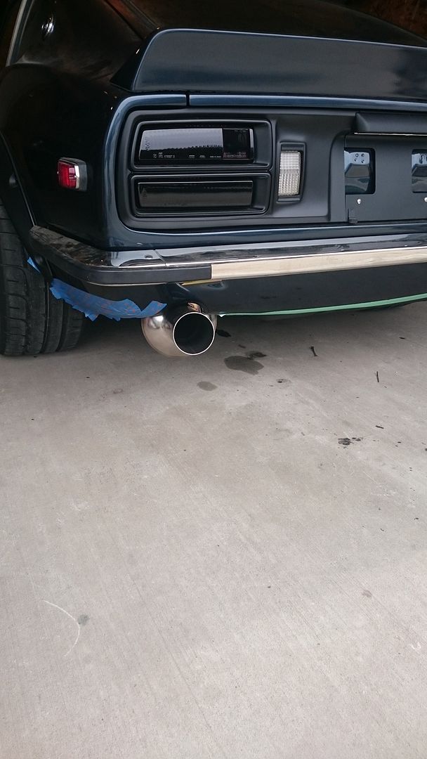

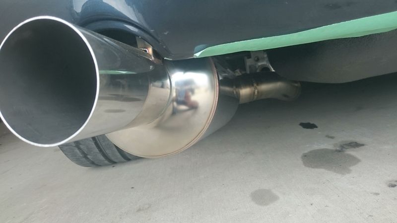

takayuki Posted June 29, 2015 Author Share Posted June 29, 2015 (edited) Looks mean! And I really love that color. Great choice. Thanks! Little update. I had my Kameari full exhaust mounted and installed. For some reason, the exhaust was 1" too long, had to have a local shop shop and modify the rear section to make it fit. I ended up doing the supra style angled look. A short video of my exhaust and engine sounds. Didn't want to rev it up too much because engine was still cold. https://youtu.be/cX8HypgviK0 Edited June 29, 2015 by takayuki Quote Link to comment Share on other sites More sharing options...

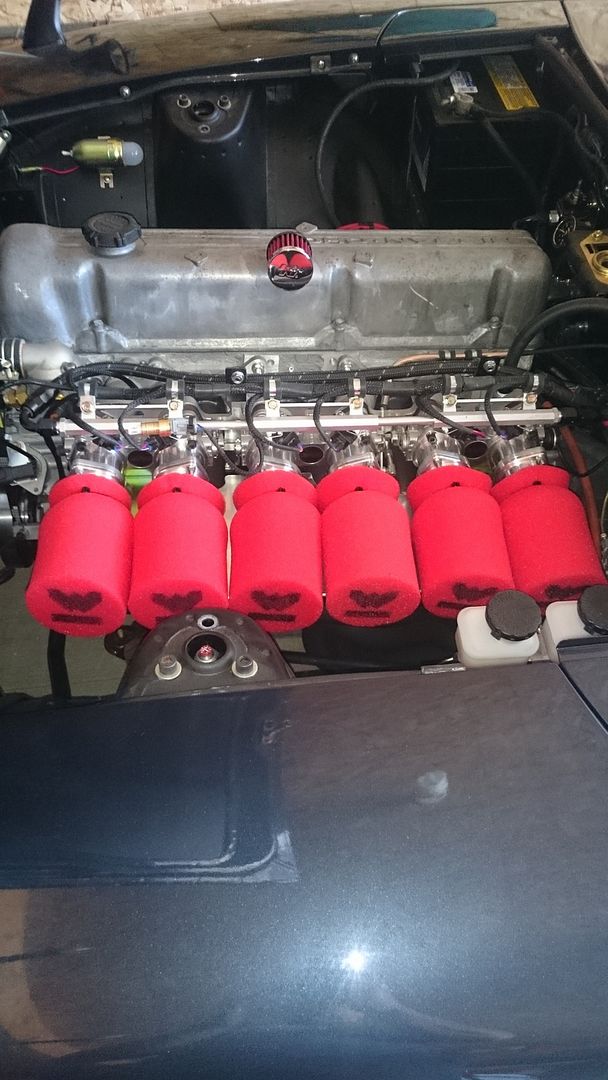

takayuki Posted July 15, 2015 Author Share Posted July 15, 2015 Some small updates. Almost ready to get this car inspected and insured. Installed Weber air filter socks Finally installed one of my prized possessions. Genuine NISMO datsun steering wheel! Quote Link to comment Share on other sites More sharing options...

RebekahsZ Posted August 6, 2015 Share Posted August 6, 2015 Be attentive to backfires thru the carbs. If you get ANY backfiring I would get rid of the socks on the velocity stacks-fire hazard. Better to wear out a set of rings early than to burn it to the ground. Quote Link to comment Share on other sites More sharing options...
takayuki Posted August 6, 2015 Author Share Posted August 6, 2015 hmmm... good tip. Is this more prone for carburated engines? My engine is fuel injected and already tuned..... However I do carry a fire extinguisher in the car with me just in case. It's pretty dusty here where I live.....because our roads are so dirty and there's construction going on everywhere during the summer... Hard to run a engine without filters. Quote Link to comment Share on other sites More sharing options...
RebekahsZ Posted August 6, 2015 Share Posted August 6, 2015 No backfire, no problem. Quote Link to comment Share on other sites More sharing options...

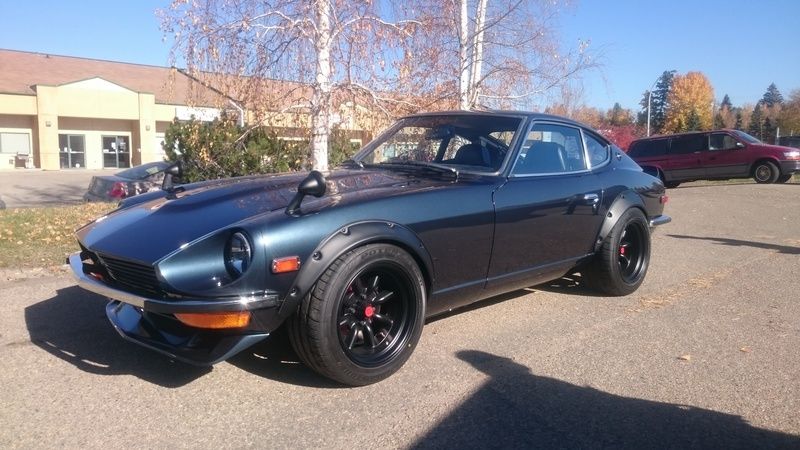

takayuki Posted October 21, 2015 Author Share Posted October 21, 2015 Car is back from the bodyshop. Took it for a drive tonight since it was still fairly warm and dry. and some comparison photo's of the led headlights. Low beam high beam And a quick video of the car. First gear acceleration https://www.youtube.com/watch?v=F6xe7gZPTSs Quote Link to comment Share on other sites More sharing options...
