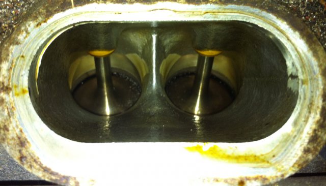

While replacing the head gasket and de-carbing the combustion chambers, I also cleaned the back side of the #3 intake valve because it was open. It had some .030-.045" layer of hard coke on it. Only later did I realize that there was no easy way to get to the closed intake valve without disassembling. Since this was beyond the scope of repairs as planned, I put the engine back together with only the #3 intake valve clean.
I didn't think the extra clearance would make a significant difference, but the engine has a distinct lumpiness now. So I'm wondering about how to remove the coke from the other valves while installed on the engine.
I've been using TECHRON but I'm still seeking other methods since the hard coke is not going to allow speedy results.
I've heard of people using crushed walnuts with a sand blaster nozzle and seen some photos showing promising results.
Has anyone tried removing the intake manifolds and blasting crushed walnuts with the engine in the car?
Open to other suggestions.

I had already used Seafoam three times shortly before pulling the head. The build up on the valves are not spongy or porous, but rather a hard coke. On the #3 valve that I could get to, the coke just laughed a hard wooden probe.
Coke is actually like an amorphous glass, breaking through the outer layer to gain access to the coke/metal junction is almost impossible.

I can understand heavy detergent use can prevent carbon/coke build up, but have my doubts about washing away glass like hard deposits like those I found while de-carbing my cylinders. Before attacking with a wire brush, I tried soaking in Seafoam, strong detergents, penetrating oil, and anything else I could find in the shop.

I think you are putting the solution before the problem. If I understand your first post correctly, you replaced the headgasket and while the head was off, you cleaned the combustion chambers. Since the #3 intake valve was open, you cleaned it, but did not turn the camshaft to clean the others. Now you have a lumpy idle which you are attributing to the differences in the deposits on the valves.
Deposits will normally affect running by absorbing gasoline and affecting the ECU's ability to control the mixture. It doesn't sound like the types of deposits you have are the normal fluffy type that affect engine running in this manner. I don't think that hard, glassy deposits can affect fuel flow or air flow (especiall at idle) enough to cause your problems.
I think it is more likely that you have another problem. I'd start with a leakdown test and checking for intake leaks. I think it is more likely that you inadvertently scratched the valve or seat on #3 or have an intake gasket leak.
Sam
Interesting thought Sam. When I finished cleaning #3, I noticed just how much the passageway had opened from when I first removed the head. If the stock cam has something like .440" lift, .030-.040" reduction in the passage way would significantly reduce airflow in my opinion.
My impression of the lumpy idle was that the odd pulse seemed to have more power rather than less as a miss would have. A leak down test would be in order though. Thanks for the suggestion.

"If the stock cam has something like .440" lift, .030-.040" reduction in the passage way would significantly reduce airflow in my opinion."
While that is true, it will not have a large effect at idle. I doubt the effect is even measurable at idle. Think about it... The only thing that is affecting airflow is the throttle. The engine is turning over slowly, giving the maximum amount of time for the valve to be open. I'm pretty sure your problem lies elsewhere.
