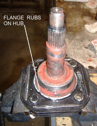

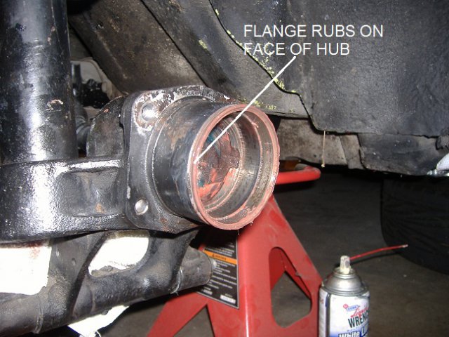

Miles Posted December 4, 2013 Share Posted December 4, 2013 (edited) 240Z with MM 240SX rear caliper install. Installed 2009. No problems unti the last year. While chasing a problem with an over heating 240SX caliper install on my 240Z I noticed that there was a lot of lateral slop in the stub axle. No bearing noise just lateral slop. I also noticed that in turning the axle there was a point at which there was some resistance. I didn't expect this as I had installed new OEM axle shafts, seals and bearings about seven years ago and the car only sees street use. I went ahead and replaced the inner and outer bearings. I torqued the retaining nut to 123 ft/lb as per factory specs when the copper washer is in place. Adding more torque has no effect on the rubbing. The lateral slop is gone, but the on and off dargging/rubbing is still present when the shaft is turned. Makes me think that the flange on the axle shaft is bent. Inspection of the inner side of the flange shows a circular witness mark where the flange is rubbing on the outer face of the hub (bearing carrier). See pictures. Edited December 4, 2013 by Miles Quote Link to comment Share on other sites More sharing options...

johnc Posted December 4, 2013 Share Posted December 4, 2013 Check the flange to make sure its not bent. Also check the fusion weld between the flnge and the shaft for pitting and cracking. The flanges are known to separate from the stub axle flange with hard track and/or auocross use. The metal shield on the inside of the flange may also be bent (best case scenario). Youy can push push out the wheel studs and remove that shield. Quote Link to comment Share on other sites More sharing options...

Miles Posted December 6, 2013 Author Share Posted December 6, 2013 With everything installed and torqued, there is about 0.003 linear movement inward when pushing and pulling on the hub. No improvement with more torque. Checked length of the "B" spacer at 52.53mm - 52.54 which is in spec. Checked the hub runout at less than 0.001. So my hub is not bent. No lateral movement. The axle flange no longer drags/rubs on the lip of the hub/bearing carrier. The axle spins free with the only drag comming from the inner grease seal. If I remove the inner flange the grease seal resistance goes to zero. I compared lateral movement of the inner races of the old and new bearings. There is the same amount of lateral play in both new and old bearings. I presume that this play is reduced when everything is in place and torqued down. ??? Quote Link to comment Share on other sites More sharing options...
