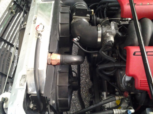

PLATA Posted January 13, 2014 Author Share Posted January 13, 2014 (edited) ^^^^ thanks for your input. Here is my upper hose >>>> >>>> my rad looks like this one Edited January 13, 2014 by PLATA Quote Link to comment Share on other sites More sharing options...
socorob Posted January 13, 2014 Share Posted January 13, 2014 The champion radiator I have has the lower hose nipple going straight out, it's not a 90 degree bend like yours, so the hose I used may not work on your lower. Quote Link to comment Share on other sites More sharing options...
